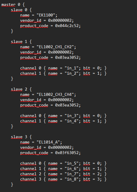

Ive already tried it on 3 different ways now,
1. A youtube Video from Talla82 (looked awsome how easy it would be....)
2. with the Instructions from you (Forum) @rodw
3. ChatGPT whats kind of ... depressing and for sure wont work
I can hang you the current lcec.conf whitch is the setup for my EK1100 hopefully you can help me correct it

20 Nov 2025 08:24 #338775
by Hakan
Replied by Hakan on topic Beckhoff Problem with Communication (TwinCAT, LinuxCNC)
What's that? Never seen that before.
Anyway that won't work with lcec_conf, it requires a file in xml format.
Easiest way, I think, is to take the output of the command "lcec_configgen" and put that
in the ethercat-conf.xml file and use that as input to lcec-conf.
Example here to show the structure and syntax of things
github.com/dbraun1981/hal-cia402/tree/main/example
Reference to lcec and lcec_conf
github.com/linuxcnc-ethercat/linuxcnc-ethercat

I didnt see that either, its what i got with my last and frustraded way by using AI.

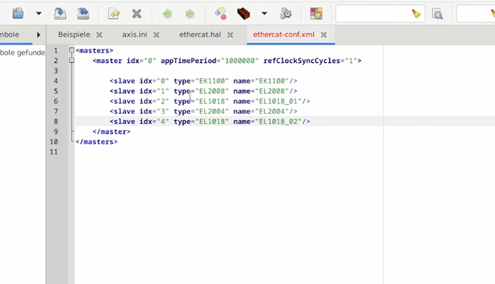

Before I did the "Thing" above I had this as .xml but that didnt work, too
I have started by doing it exactly like this :

20 Nov 2025 09:43 #338782
by Hakan
Best if you show
the xml and hal files, the error messages and some lines around them, and the last say 30 lines of the syslog.
