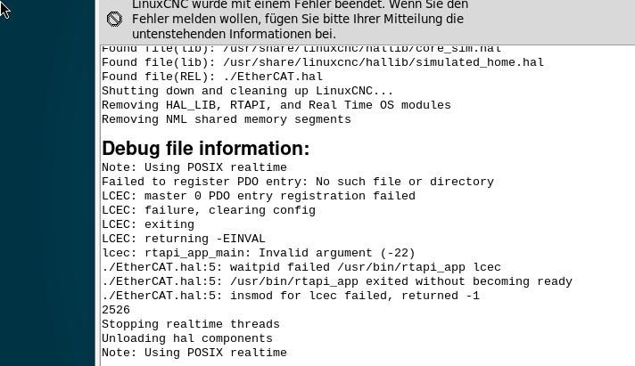

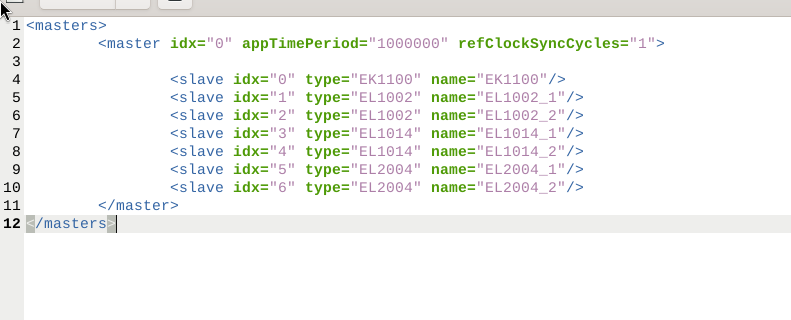

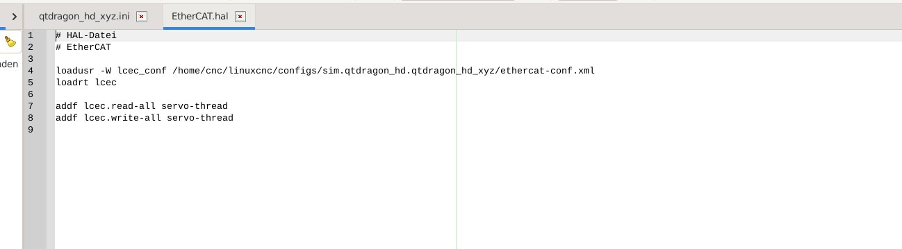

20 Nov 2025 11:01 #338787
by DemonClaW
Replied by DemonClaW on topic Beckhoff Problem with Communication (TwinCAT, LinuxCNC)
These would be the new .hal and .xml file + the error code i got after starting
I made this data like the video told me to, expect the card config but im using supported base cards so i just changed the names for them

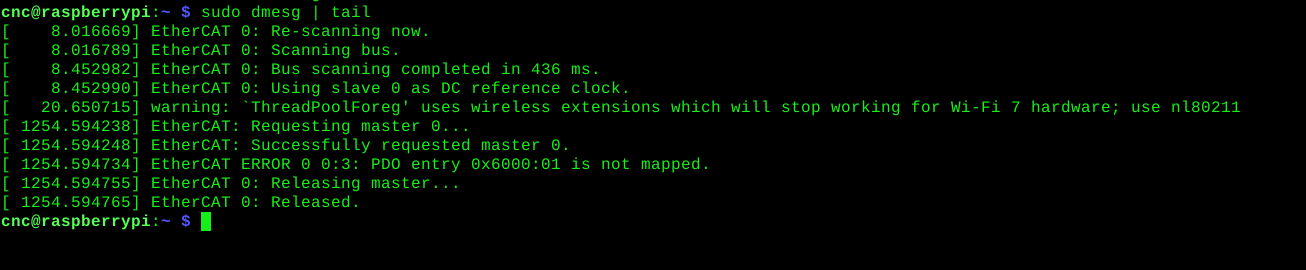

20 Nov 2025 12:14 #338790
by Hakan
Replied by Hakan on topic Beckhoff Problem with Communication (TwinCAT, LinuxCNC)
There was a guy here just the other day that had EL1014 with a different PDO mapping
forum.linuxcnc.org/ethercat/57773-etherc...slave-signals#338260
Maybe it is something like that?
Can you also post the output from the command "sudo dmesg | tail -30" for error messages from Ethercat master.

20 Nov 2025 12:34 #338791
by DemonClaW
It looks very familiar to me, yeah
I posted the master Output after dmesg, too
It says taht the pdo is not mapped

20 Nov 2025 12:46 #338792
by Hakan
Check "ethercat -p 3 pdos" and "ethercat -p 4 pdos", if they have PDOs at 0x3101 than that's the problem.
Check the link for how to configure those EL1014 with lcec_configgen -typedb=falseĀ
and insert this into ethercat-conf.xml for slave 3 and 4, the EL1014s.

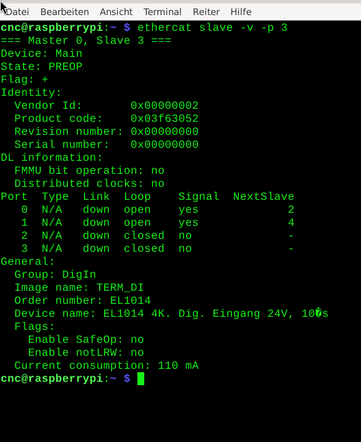

20 Nov 2025 13:30 #338796
by Hakan
It was supposed to work out-of-the-box with the EL1014.
It's a pain when it doesn't.
Seems to be a new version with different PDO mapping.
Can you please give the "ethercat slave -v -p 3" info and I'll
open an issue on github to see if we can distinguish these with the new PDO
mapping from the old ones.
- DemonClaW
- Posts: 33
- Thank you received: 7
20 Nov 2025 13:44 #338797
by DemonClaW
Yeah, of course i will hang it on as .pngĀ
