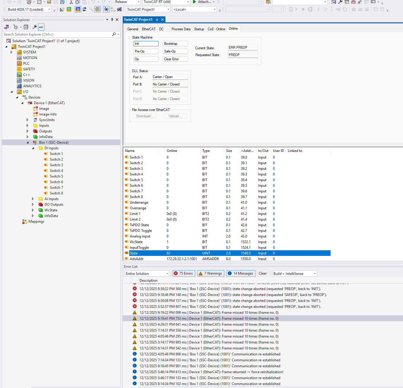

My encoder seems good and with the help of AI I modified the SPI to match my setup. I started from your E7000 version and made some cleaning of the main.cpp.
I went too fast and test in Twincat, I can see the device but its stuck in INIT mode yet. not surprising. I think the old eeprom is still there because in twincat, in the device I can see 8 inputs and 8 outputs, what I had on the original board.
I think I need to build the eeprom stuff correctly but I have absolutely no clue how to do it.

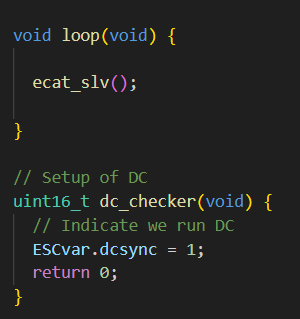

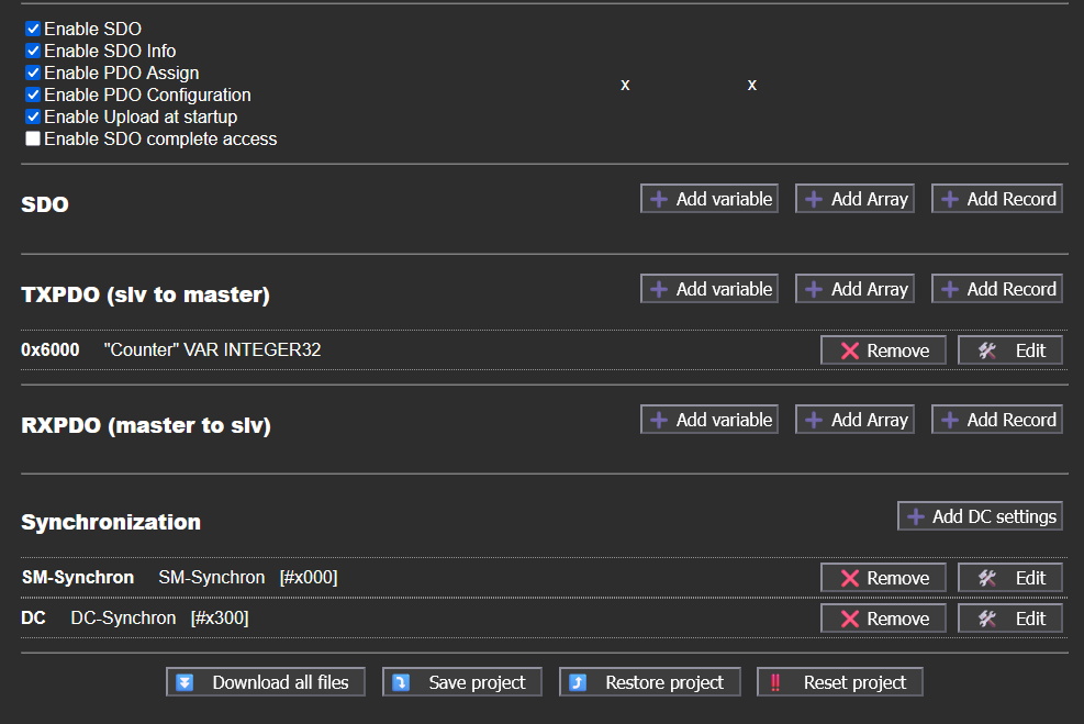

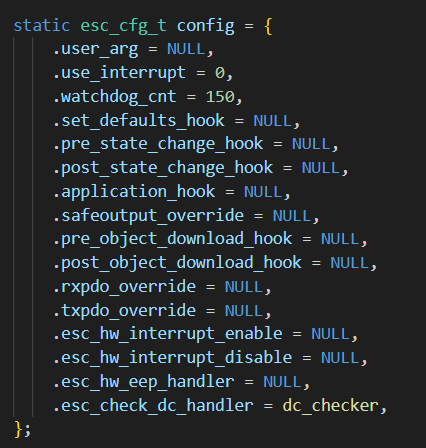

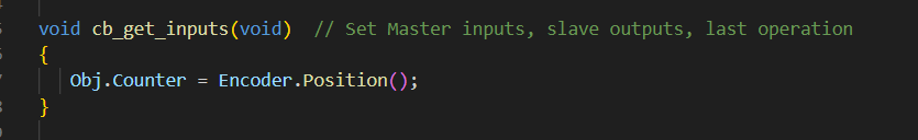

12 Dec 2025 15:26 - 12 Dec 2025 15:32 #340000
by Hakan
Replied by Hakan on topic Ethercat compatible Encoder board tentative STM32F4 + LAN9252
You decide yourself which SDOs and PDOs you need and want to have.
I propose to have zero SDOs to start with and only one PDO which is the hardware counter number.
You see at ther bottom in the figure, the save/restore button. Download all files, it will create a zip file with al you need.
Unpack those seven? files in lib/soes-esi and rebuild the code. Take the xml file to TwinCat and program the eeprom there.
You decide yourself which Vendor Id. Product code, etc etc you want to have.
Some sizes you should not change, it tells you in the mouse-over comment.
The config struct can look like this
And the loop()
A lot of clean-up yes.
And the loop()
Last edit: 12 Dec 2025 15:32 by Hakan. Reason: not!

Thank you,
some little progress made, everything compile, run LED is blinking in the LAN9252 board, but I-m not in OP mode yet:
What worries me is that I can still see the original configuration with available switches in Twincat
This means the EEPROM is not flashed correctly I guess?

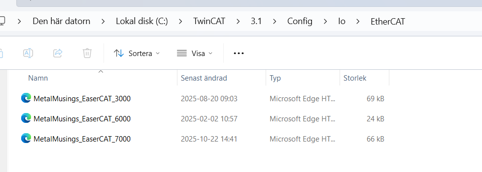

- Hakan
- Posts: 1322
- Thank you received: 459
12 Dec 2025 23:03 - 13 Dec 2025 09:48 #340023
by Hakan
Indeed, the old config.
You remember there is a procedure around that.
Copy xml file to config\io\ethercat somewhere (similar)
restart twincat to have it read in new config, scan for devices,
free run mode on, program eeprom, remove device, scan for devices
and with some luck the new config is there. Something like that.
I had it in one if my first youtube videos about ethercat.
Edit.
Upload xml file to C:\TwinCAT\3.1\Config\Io\EtherCAT and restart TwinCAT
Jump to 10:04 and follow the steps
Edit.
Last edit: 13 Dec 2025 09:48 by Hakan.

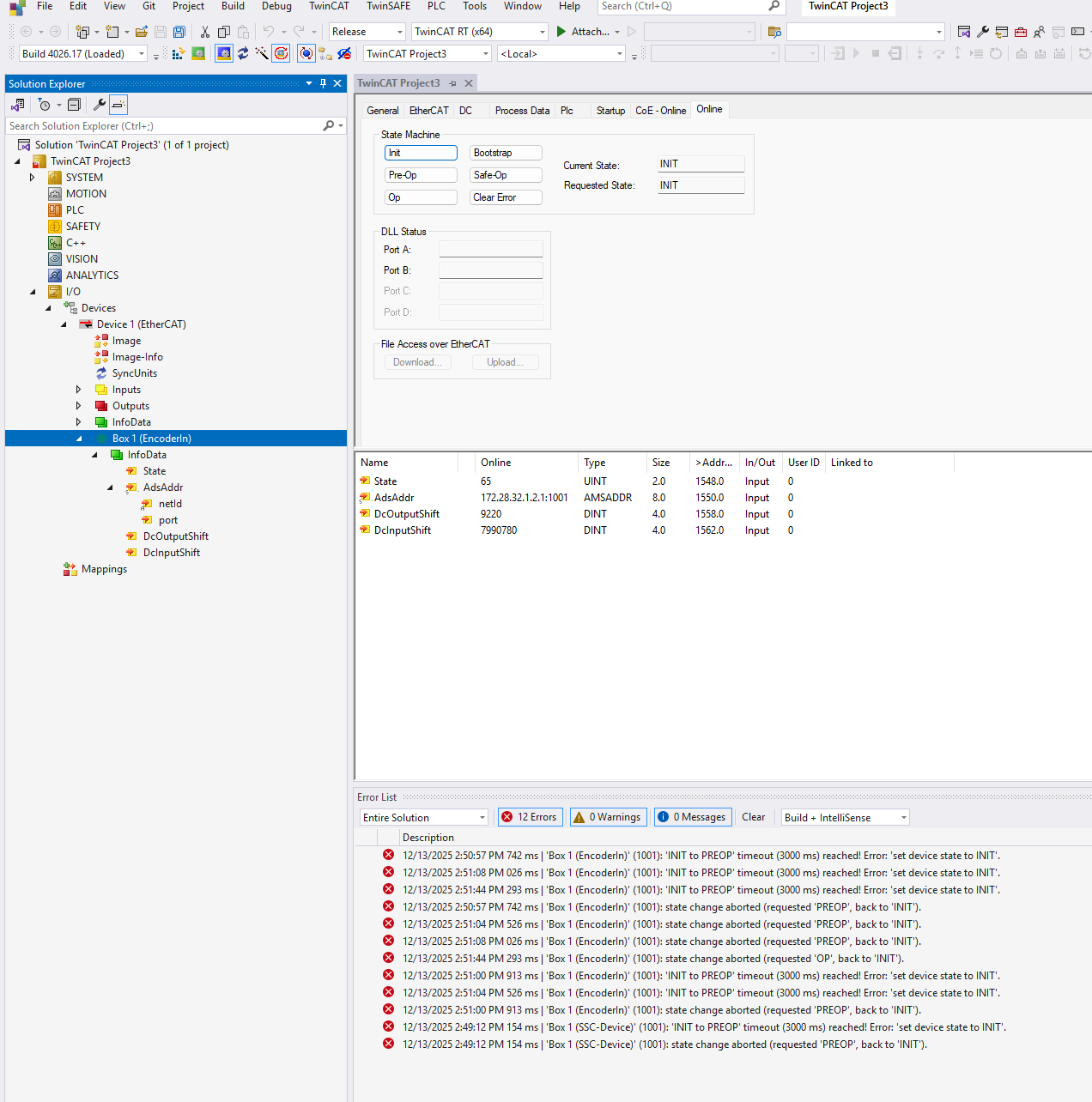

- vibram
- Posts: 84
13 Dec 2025 12:53 - 13 Dec 2025 13:06 #340047
by vibram
Replied by vibram on topic Ethercat compatible Encoder board tentative STM32F4 + LAN9252

some little progress made, I managed to flash the EEPROM, the name of the device changed and I don't see the input/output anymore.
However, I m not able to pass the INIT step
