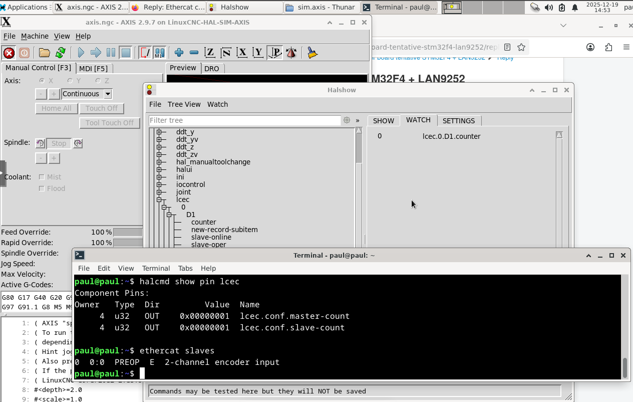

I will not use DC yet as it sounds too complicated at this stage
I setup a Linuxcnc on my personal server. Everything is recognized but the counter is not working.
Its in PRE OP, maybe this is the issue

Preop is fine, preop E is not.
General debug tool is to look at the last 10-20 or so lines from "sudo dmesg". Ethercat master always says there what is the problem. Not always easy to decode, still it gives some clues.
Many many times the eeprom and firmware have come out of sync. Like added something with eeprom_generator and didn't upload eeprom.
Also, does the counter update in Twincat?
If you get stuck and it won't work, please push the updated code to github and I can have a look.

strange, i unplug everything and replug and itw works in linuxcnc too
very happy about this
i will continue to see what can I achieve
thanks again !!!

Good. Has happened before. A total reset after eeprom update is usually a good idea.
I normally upload firmware on the fly, even when connected to linuxcnc. Much less sensitive.
