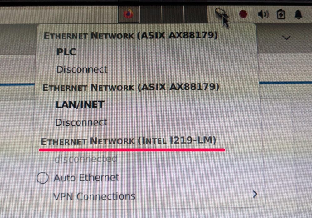

17 Feb 2026 01:12 - 17 Feb 2026 02:02 #343077 by tar_san
Replied by tar_san on topic Ver 2.9.8 Trouble when disabling EOE
Thank you so much.
Now I installed LinuxCNC to PC (HP Elite 800 G4 with Intel LAN) using 2.9.4 iso,
I did recompile EOE disable along to the procedure, I did not upgrade,
but I could not improve my bad situation in using Yaskawa Drive.
I found ...something strange.
Ethercat service starts automatically,and ethercat slaves works after reboot.( "ehtercat slaves " shows all servo drives )
But I have to do this command to execute LinuxCNC everytime after reboot.
chmod 666 /dev/EtherCAT0
but If I did this, LinuxCNC doesnot handle Yaskawa servo propery (A12).
And also, in Network Connection (in "TASKBAR on the top of Desktop") I could see a NIC Interface that I'm using for "EtherCAT".( see attachment jpeg image)
What am I missing ? What should I check ?

17 Feb 2026 07:22 - 17 Feb 2026 08:50 #343082 by Hakan
Replied by Hakan on topic Ver 2.9.8 Trouble when disabling EOE
Halfway down in this post rodw describes how to add a udev rule for /dev/EtherCAT0
forum.linuxcnc.org/ethercat/45336-etherc...-how-to-step-by-step
For the interface, there are many ways. I have the following in /etc/network/interfaces for my ethercat interface
It brings the enp2s0 interface up, without IP address
auto enp2s0
iface enp2s0 inet manual
        hardware-irq-coalesce-rx-usecs 0
        pre-up /sbin/ip link set dev $IFACE up
        post-down /sbin/ip link set dev $IFACE down
Check what's in syslog (sudo dmesg) if there are more problem

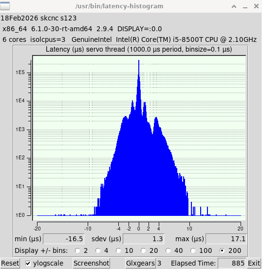

18 Feb 2026 09:19 #343140 by Hakan
I am getting out of ideas.
It's a new computer so if you haven't done so already, you can check overall latency with
latency-histogram --nobase --sbinsize 1000 --show
and make sure the min and max are below +- 20 microseconds or so.
If that doesn't give anything I think you should go back to the working setup you had
with a laptop. If I understood right that setup worked, with the Realtek dkms driver.
Follow your own notes in this thread.
Ethercat master is always distributed as a package separate from linuxcnc due to licensing constraints.
So there is no better or worse linuxcnc version, they are all the same what concerns ethercat and locally compiled master.
18 Feb 2026 21:20 - 18 Feb 2026 21:22 #343168 by tar_san
This is a snapshot of latency of that PC when I tested servomotors.
I'll try exact same former procedures ( I have written something important about disabling eoe, and recalling everything as much as possible ) with former PC today.
Thank you so much for your every skillful reply.
