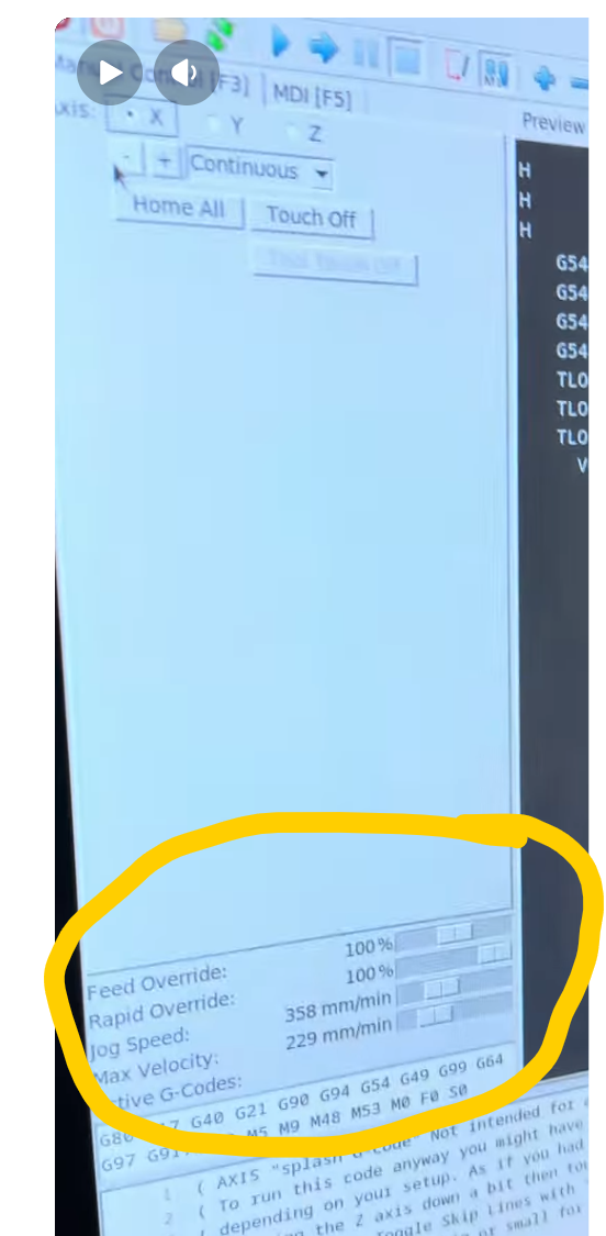

Hi all,I'm experiencing an issue with my EtherCAT drive. When I try to move any axis through LinuxCNC, the motion is noticeably slower compared to using the drive's own software.I've attached two videos for comparison:

Unfortunately, I never reach the speed set in the .ini file.
The motors move much slower than the set speed and make a lot of noise. If I set the same speed in the drive program, the command executes smoothly and without making any noise.
I'm probably doing something wrong in the configuration.

I solved most of the problems by changing the SERVO_PERIOD from 2000000 to 1000000.
I've also a problem in display section: MIN_LINEAR_VELOCITY = 0 MAX_LINEAR_VELOCITY = 50.00

Your jog settings are really slow. That's why it moves so slowly.
These are settings in the ini file. I don't use axis so can't advice further on that,
but many users do use axis and should be able to tell you what and where to change.
Test the following in the MDI "G1 X200 F20000"
that should give quite a bit better speed. Adjust velocity and acceleration settings in the ini file to your liking.
The drives should work fine. When you ask to much of them they will give you following errors. But you are not near that.
