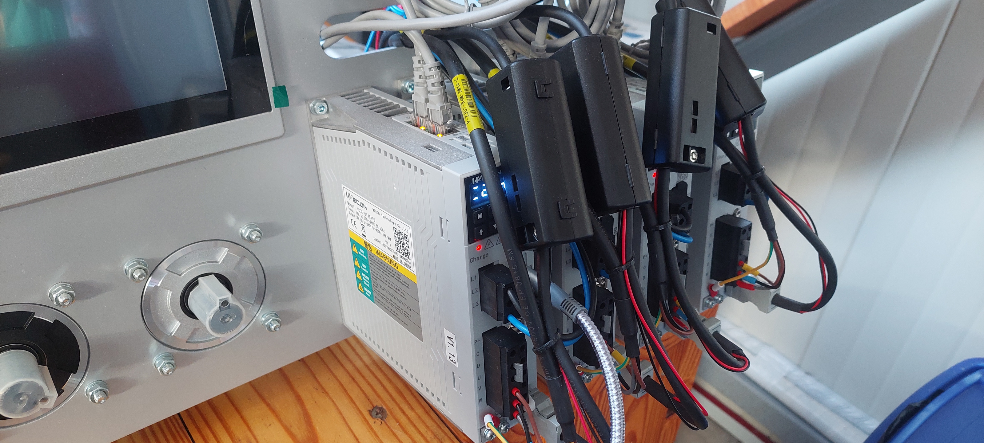

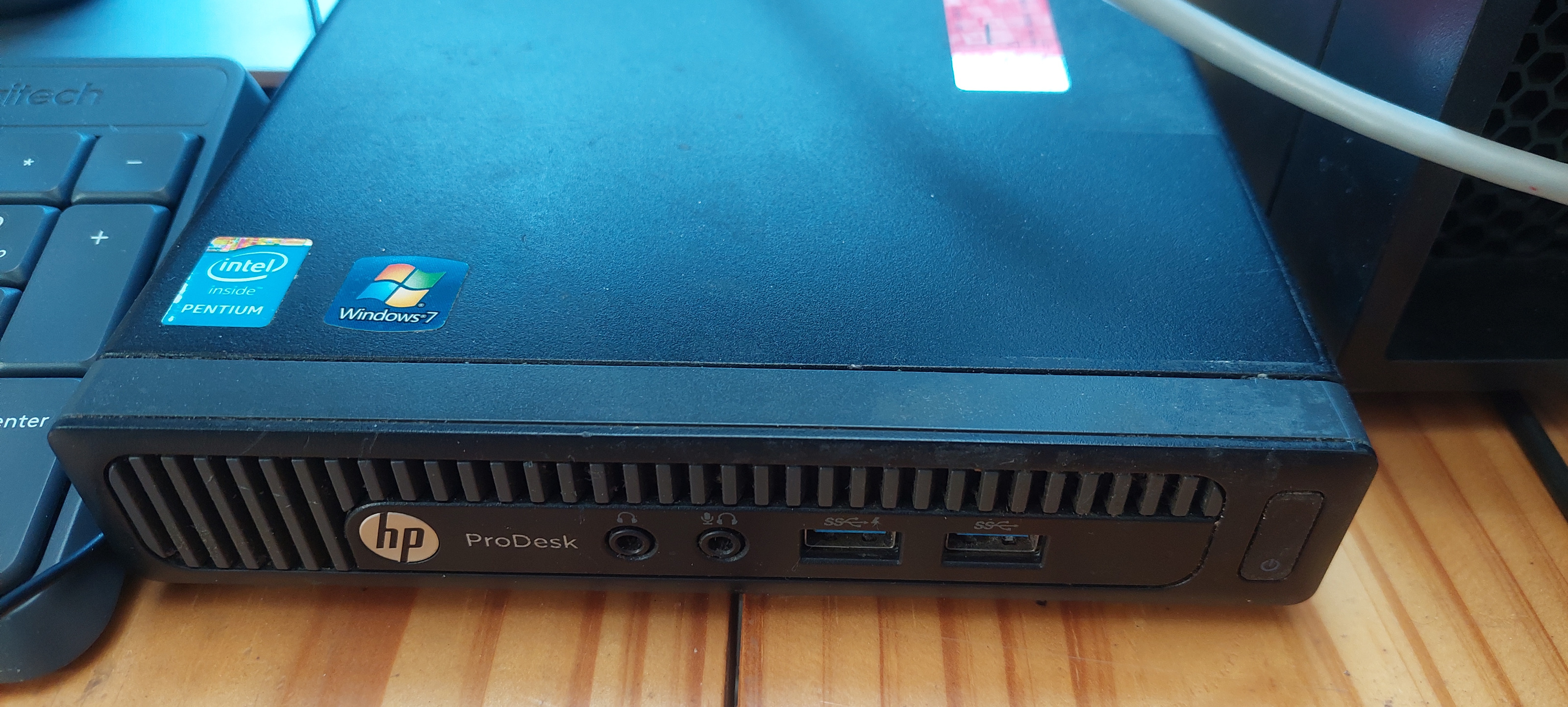

I will purchase CAT6 cables as short as possible to prevent any loops probably the next week. I do not think there should be any EMC since, as I mentioned earlier, the drives and motor are on my testbench. There is no high voltage machine around, just computers.  Still, I do not exclude that EMC is the actual problem. I attached pictures of the drive setup and the mini pc I use.
By the way, when I try the command “dmesg | grep ethercat”, I got an error: "dmesg: read kernel buffer failed: Operation not permitted". Only "sudo dmesg" works.
Another interesting fact that I observed is that when I type "ethercat pdos", there are a few rows where it show 0x0000:00, 0bit, 'Gap''. As if there are missing PDOs. I might be wrong but, should I somehow define in the servo drive what PDOs and SDOs to be mapped in the variable PDO and SDO mapping.

28 Feb 2026 15:38 #343655 by andrax
Replied by andrax on topic CiA 402 Folder Missing
Am I right in thinking you have battery-buffered encoders?Then you don't need homing.First remove the loops and see if the errors decrease. Dmesg requires admin rights.

03 Mar 2026 17:32 - 03 Mar 2026 17:40 #343798 by andrax
dmesg_new looks better.
However, your vid and pid are incorrect.
They are from Stepperonline A6.
You must enter those from your servos.
vid according to manufacturer xml: 00000eff
pid: 0d3e0001 (not sure)
Note:
please use: dmesg | grep ethercat as root
sudo su
password
that's conspicuous
EtherCAT ERROR 0-3: AL status message 0x001A: "Synchronization error".
Last edit: 03 Mar 2026 17:40 by andrax.
