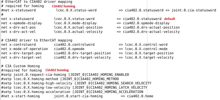

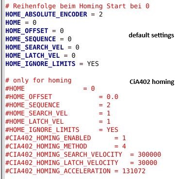

03 May 2026 13:24 #346134
by Konstantin
Replied by Konstantin on topic CiA 402 Folder Missing
@andrax
I created a new configuration using your templates for .ini and .hal files from the A6 Absolute Homing topic. The .xml file is mine and I deleted all of the SDO configurations. The axis is named "X" as you suggested. Attached are the configuration files.
The names of the pins are according to your .hal file, nothing is changed there. I had to make some changed in my .xml file to match.
Now, I opened and closed LinuxCNC a few time and the coordinate of the axis seems to save after each time the machine is closed. When I press "Home All" button the axis is immediately set homed and coordinates does not change.
Let's start with the custom CiA402 homing step by step. I attached two pictures one from .ini and the other from .hal file. What I described as "default" is the default configuration settings as if homing was executed. My question is, when I uncomment the "CiA402 homing" rows in both file, should the "default" rows be commented?
- andrax
- Posts: 321
- Thank you received: 83
04 May 2026 08:44 #346150
by andrax
Replied by andrax on topic CiA 402 Folder Missing
What position is displayed when you turn the servo off and on again? 0 or the last current position?
