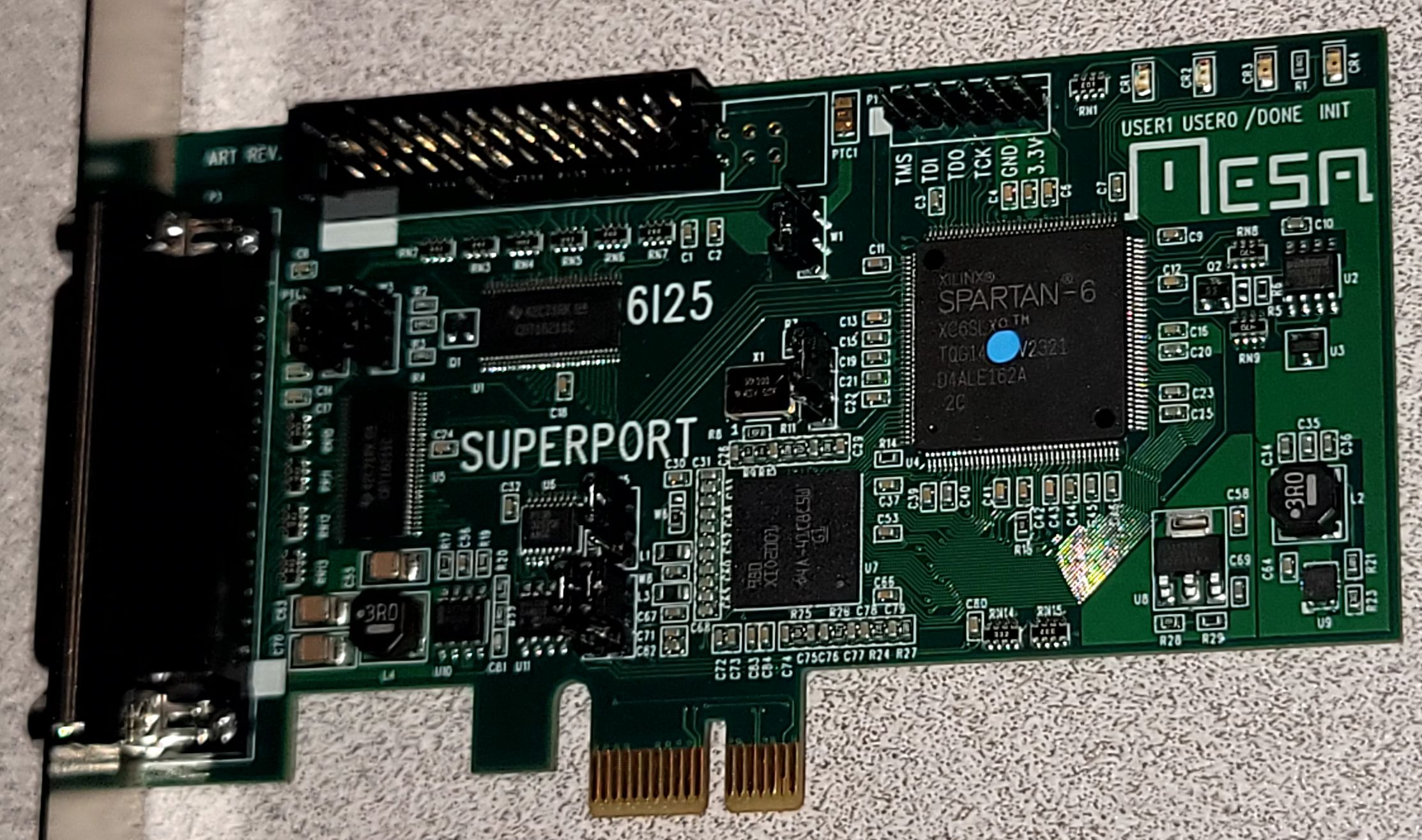

  • maxi177
  • maxi177
15 Nov 2026 13:20
Replied by maxi177 on topic Mesa Suppliers
Mesa Suppliers
Category: Driver Boards
I ordered different Mesa boards at least three times from eusurplus.com, never had an issue.
  • andypugh
  • andypugh's Avatar
15 Nov 2026 12:49
Replied by andypugh on topic Mesa Suppliers
Mesa Suppliers
I can confirm that store.mesanet.com is trustworthy, I have several cards from there. I have also met PCW and visited the premises when I happened to be in the area.
You could order over the phone if you don't want to trust the web.
  • JT
  • JT's Avatar
15 Nov 2026 12:28
Replied by JT on topic Mesa Suppliers
Mesa Suppliers
Yes

  • timwozni
  • timwozni
15 Nov 2026 11:05
Replied by timwozni on topic Mesa Suppliers
Mesa Suppliers
Are Mesa cards manufactured in a factory in the United States?
  • tommylight
  • tommylight's Avatar
15 Nov 2026 11:00
Replied by tommylight on topic Mesa Suppliers
Mesa Suppliers
PCW is the owner of Mesa, web site, store and factory, and he is always here to help.
