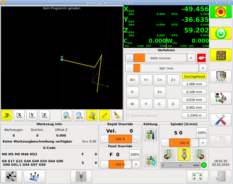

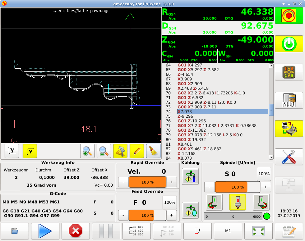

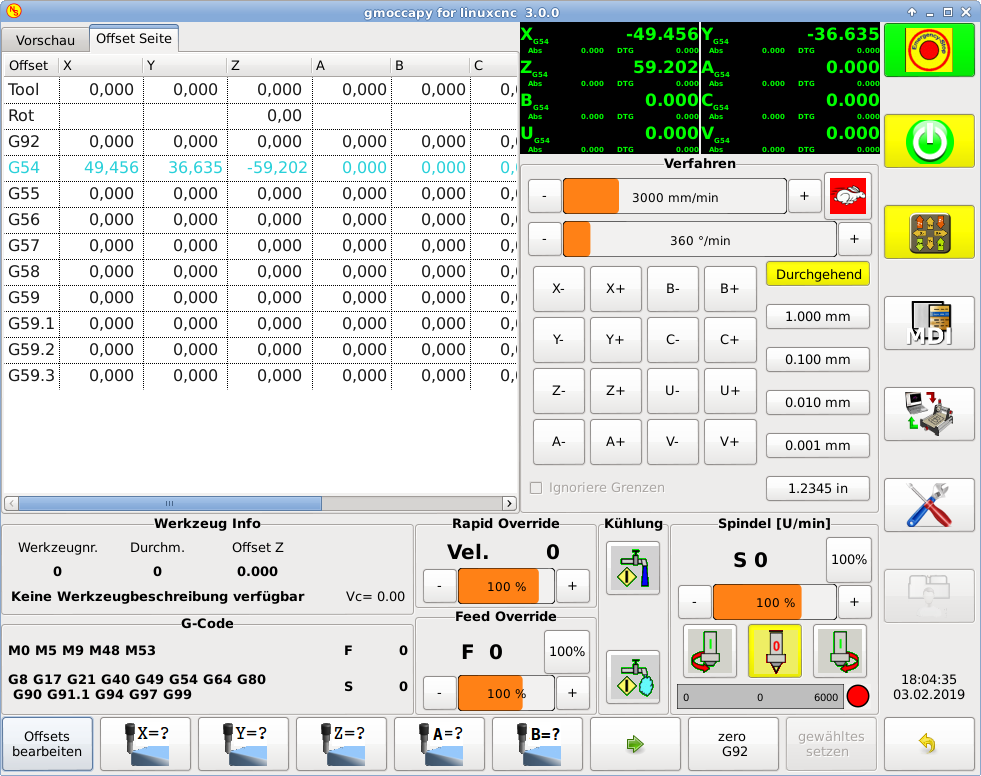

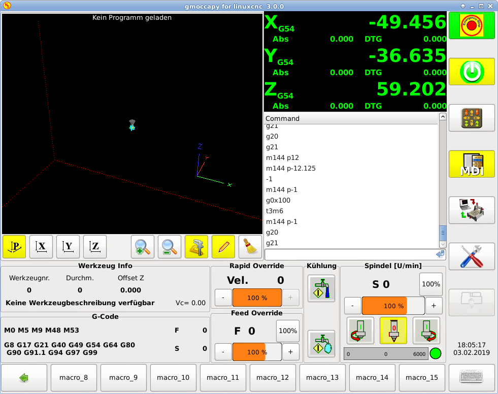

Hallo,
I am proud to be able to announce the next generation of gmoccapy. Release 3.0 is about to be pushed to master.
- It will support up to 9 axis!
- No limitation of configuration of joint or axis.
- Support of lathes with additional axis like a XZCW configuration.
- It will support up to 16 macros!
- If a angular axis is used a additional jog vel slider is shown.
And a lot of stuff under the hood. Widgets like DRO are generated on the fly, according to the configuration, so on 3 axis machines we save resources.
No need any more to maintain additional list to handle the hardware button and a lot more.
As soon as this release is stable and mostly bug free, I will begin with a new GUI based on Qt, please feel free to mention wishes.
For the very brave of you, just get a copy from gmoccapy_3_0 github
Norbert
