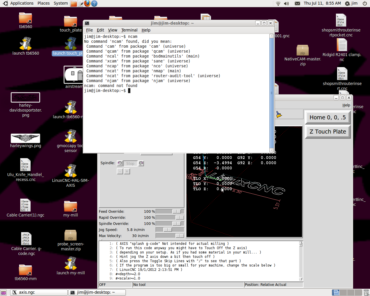

OK, I am not good at computers. That said I need help.
I have been reading all I can about installing NativeCam. I see others saying they got it going but not seeing what they exactly did to get if going. Just what they did to fix it. I can get a screen up by typing python ncam.py after several error and ok's. When I try to do the embedded commands in the readme file it says no command found ncam and does not add the tab. I added a tab with an embeded_command. But it says the ncam.ui file can't run as there is no QT_Designer to run it? I probable have a mess now on my machine as I have tried the commands in several different directories trying to get a tab in linuxcnc. I have a ini file that I use always that has a probe_screen tab and an add on touch_probe button I got off the internet from rob suber I think it was. I have tried to use the debian iso but my machine seems to not like it. it has to do with the video drive I believe. Any way, am I too out dated to use NativeCam do I need a different computer to put Debian on? Sorry for the long drag out but I wanted to explain myself first. Thank you for reading. I if your laughing good I love to make people laugh.

I have never used lucid but if linuxcnc works, nativecam should.
If from a command prompt (do not use sudo) you type 'ncam' what happens ? Post a screen shot please.
Then attach your ini file with your answer. I do not need anything else for now.

Looks like nativecam is NOT installed.
try : locate nativecam
If it is not found then open package manager and search for nativecam or ncam. Install from there or use the install procedure.
Fern

Thank you. Todd I did what you said thank you. The repository is there. Now I need to update the python, according to nativecam I need 2.7 or higher. So I think I just may move on to Debian. Ordered a new dvd writer from fleabay, so I can install a fresh iso. Thank you you guys for your help. I look forward to using native cam. The other cam software I have been using just has too many steps to get the g-code over to linuxcnc. I like the native solution better.
