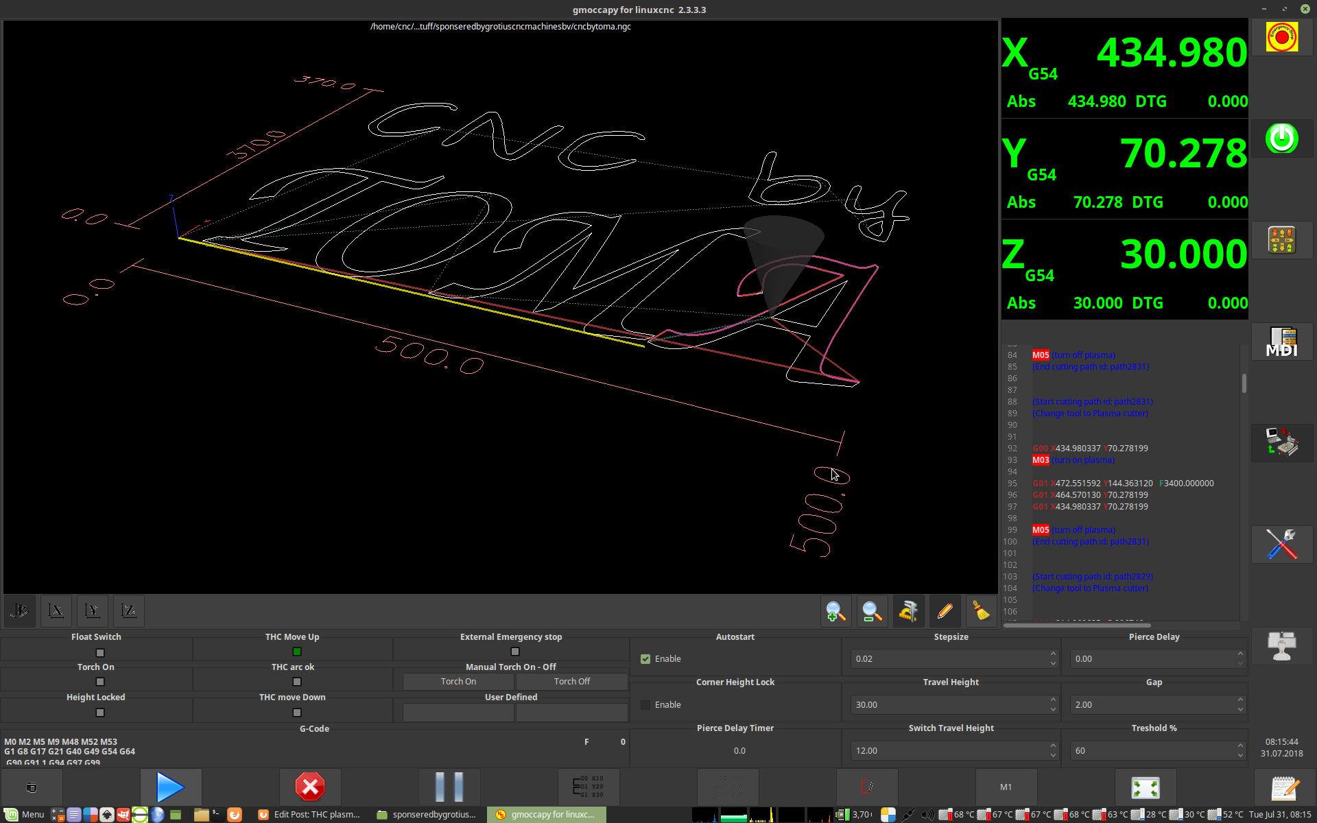

If you use the toma config you can set everything in Linuxcnc. For what you need it, Proma 150 will do nicely, even for much more.
BTW here it is on one of the computers i use daily at 1920X1200,
Those LED's really need to be much bigger, and i see no velocity anywhere while the machine is moving, that is a must when plasma cutting.
Replied by tommylight on topic THC plasma configs, with HOW TO.
I have all of them set to the fastest reaction time, so Hysteresis is at 2V i think and delay is at 0.1.Can you share with me what are your recommended settings on the Proma 150 THC controller (Hysteresis, Delay, etc.) as well as your recommended Z parameters (velocity and acceleration) while under THC control.

Velocity is set in the ini file at the maximum Z axis can handle, and on screen you have "step size" to adjust how much it will move when commanded from THC.Regarding your screen, I don't see anywhere a setting for Z response velocity under THC control? Is there no need for this parameter within LinuxCNC?

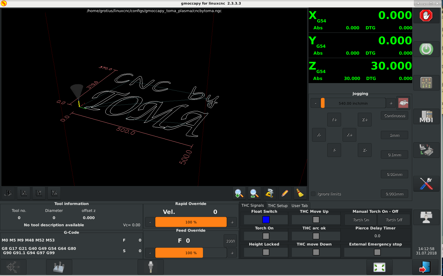

Hi
The THC screen now follows the user defined theme. I had to add the plasma.py and plasma.pyc file.
The leds are 2x bigger.
It has the orginal gmoccapy speed panel.
I had to merge the 2 panels to one panel with tabs, to give it something functional.
There is a user defined tap. I advice for users to select Halui i/o and connect them in the plasmaled.hal file, not in postgui.hal
because it is a embedded panel with separate hal file. It will not work with postgui.hal.
Have fun. Attached the zip file list.
