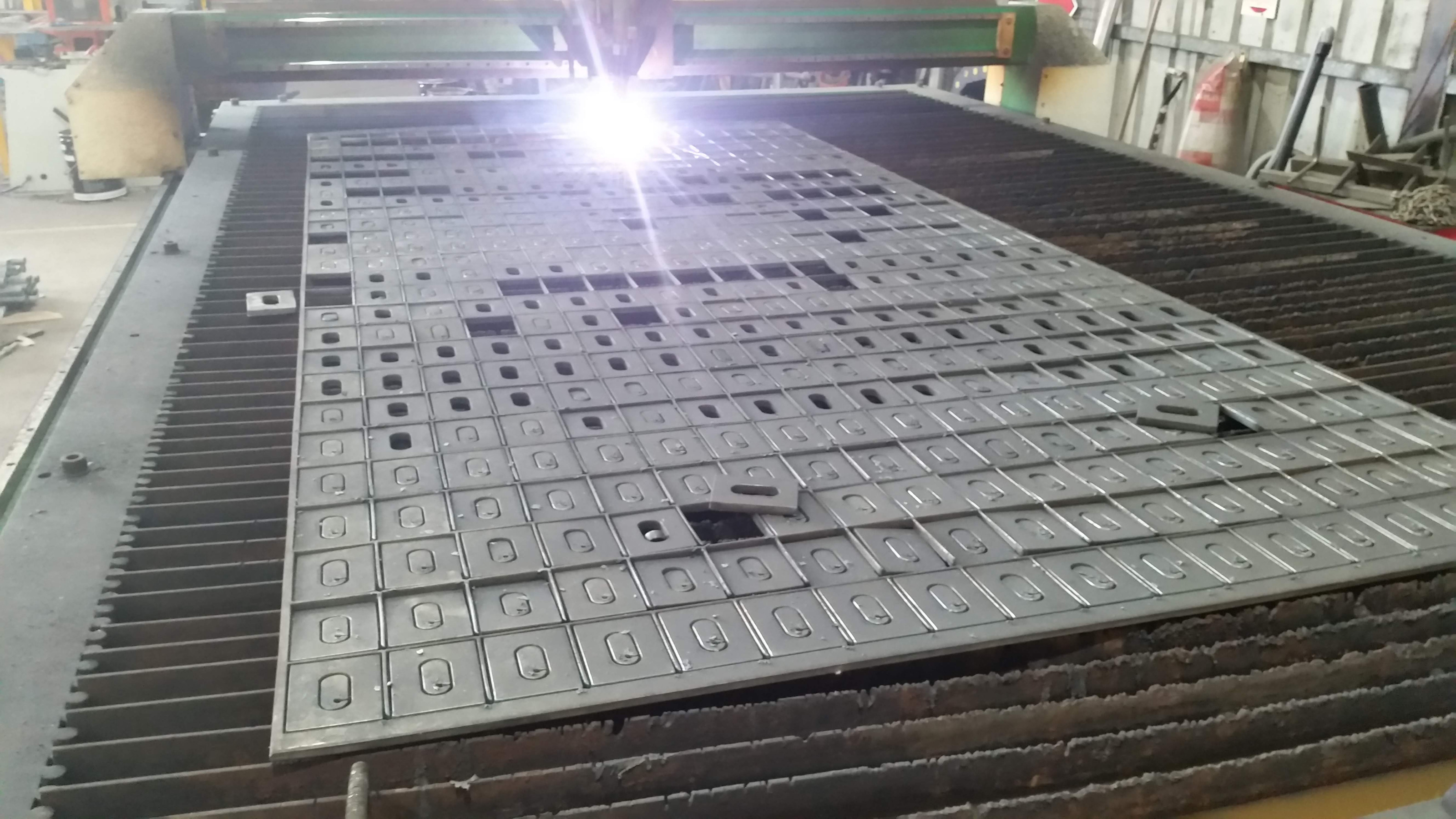

14 Nov 2018 20:12 - 14 Nov 2018 20:24 #120695 by thefabricator03
Replied by thefabricator03 on topic Open Source Controller with internal THC
I appreciate your insight,
Can you explain to me about the critical nature of Hi Definition cutting?
What is difficult about it?
I have been doing a lot of cutting with my machine,
Attachment not found
I generally cut three 3000x1500x what ever thickness sheets a day.
How much more time do you think I need to spend with normal plasma before I can move to High Definition?
Last edit: 14 Nov 2018 20:24 by thefabricator03.
17 Nov 2018 21:24 - 17 Nov 2018 21:47 #120924 by Grotius
Replied by Grotius on topic Open Source Controller with internal THC
Hi Stefan,
The cutting proces an sich is about 75% expensiver, because of use of primairy and secondairy shield gases, 7 or 8 types of consumables for each cutting proces. Multi pre assamled cutting head's for fast material switching is needed, for amp's and material type. In practical way, there is a lot more to do like the manual gas box. The gas box has multiple input parameter's. They must be set, preflowed etc. So in the end. You must be a very serious candidate to cut High Defenition. Below 4mm
you can better stay on normal plasma.
Thermal Dynamic's Europe will sent High Defenition plasma system's to you. I have arranged that this week with the manager.
You can start with a Ultracut 100 or 200 amp's system if you like.
The most important. It's also compatible with Linuxcnc.
