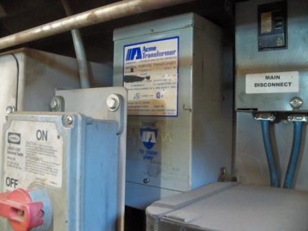

I've also had some experience with EMI on the stepper drive plasma table I built.
It seems there is an abundance of advice on the subject (some conflicting). I have found the attached article to have a good overall view of the subject. To deal with the problem I ended up installing a shielded isolation transformer, which mostly took care of it.

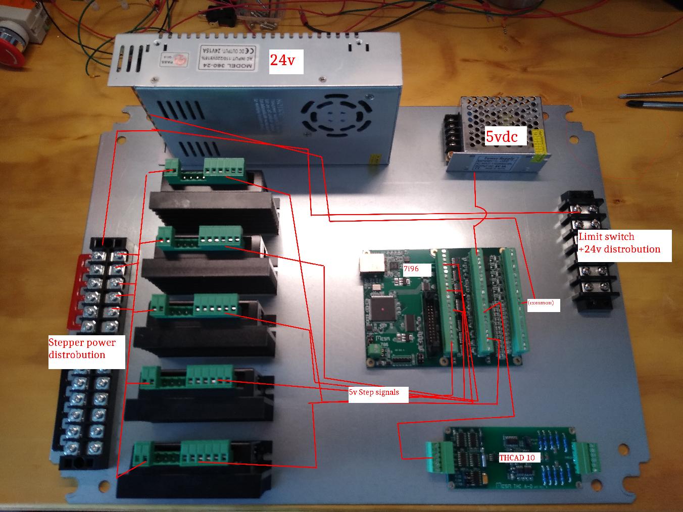

I've attached a photo of what I'm thinking in regard to panel layout and my wiring plan (more or less) for reference. Any thoughts on layout in regard to emi?
When mounted vertically the drivers will be up top and all the signal and motor wires will come up through the bottom of the box (right hand side of the photo).
In the layout photo disregard lines drawn to the wrong terminals, it is just a quick rough sketch to illustrate the plan.

08 Aug 2020 21:16 #177716 by rodw
Replied by rodw on topic Lets Talk Wiring And EMI
The star ground should be external to the control panel and pick up wires from all of the motors as shown in earlier photos.
This point should also be connected to the work clamp.
If you use a ground rod, it should also be connected here.
Your control panel star ground should also connect to the main star ground.
I'm worried that you will not find the 24v power supply adequate for your motors. if the controllers will handle it, it would be best to add a 48v - 72v power supply

09 Aug 2020 01:16 - 09 Aug 2020 01:28 #177727 by AgentWD40
Replied by AgentWD40 on topic Lets Talk Wiring And EMI
Just to clarify, you're saying the shielding for the stepper wire cables doesn't need to be brought into the panel at all but grounded to the table's star ground?
