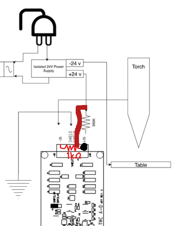

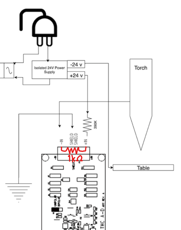

18 Apr 2020 11:41 #164443 by tommylight
Well i think i was silent long enough about this...
Find a 1KOhm resistor at 1W ( or 2x 2.2K @0.5W, or 4x 4.7K @0.25W, in parallel ), and attach it to the THCAD5 input, that should make all your water problems go away. It is to sensitive and that is very good, but not when water is involved. That will make it require more current passing through the system to trigger ( or change measured values in this case )
470Ohm/2W should do even better, just a bit over 5 mA going through it.

18 Apr 2020 12:40 - 18 Apr 2020 12:41 #164450 by tommylight
Yes, you can do that and it will not move the scaling, 24V will still be 24V, just the current to get there will be higher, hence lowering the sensitivity to water.
Humour me, give it a try.
I have 4 THCAD's wandering the globe somewhere collecting viruses, still did not get them, so i can not try that yet.
I did say, parallel to the input, not in series, did i ? Guess not.

18 Apr 2020 13:45 #164456 by Uthayne
Tommy, is this what you're saying?
  • tommylight
  • tommylight's Avatar
  • Away
  • Moderator
  • Moderator
18 Apr 2020 14:12 #164460 by tommylight
Yes, but if you have that 390K resistor, connect it before the resistor.
