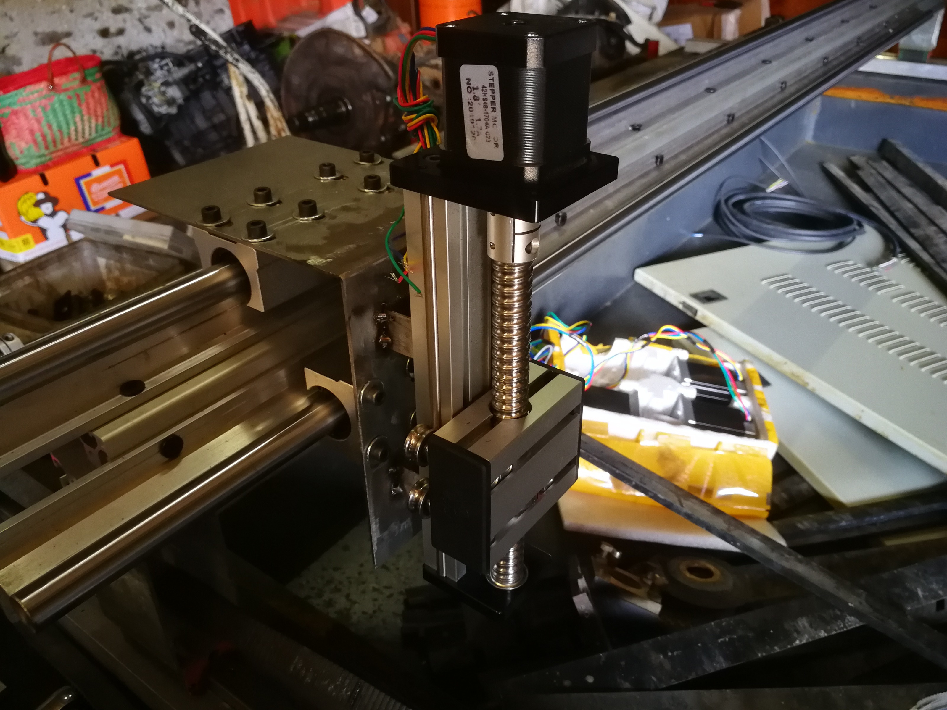

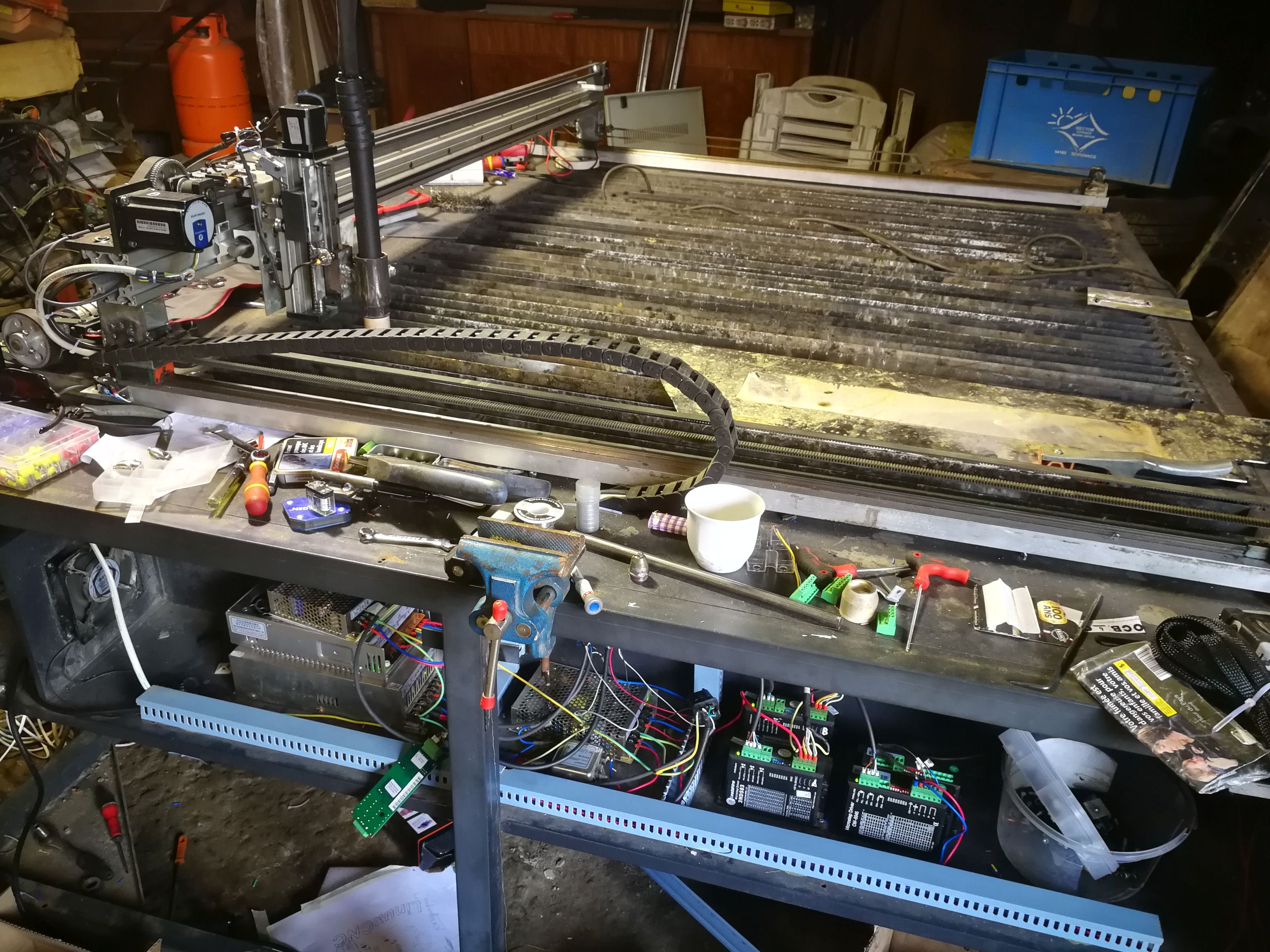

Quick presentation, i got for free a chinese laser table, it was outside in the rain for like 6 months
I think the tubes and the HV supplys are shot, it was modded / reparaired over the years, it's from 2006-2008.
Anygot got it for free, so no complaints, it hase some HIWIN rails (15mm though) good enough for the plasma and the original cutting area is 1.2M x1.5M, but from the size and constraints of the plasma gantry/torch it's down to 1.37Mx1.1M.
The stock motors X & Y are 3 phase NEMA 23 steppers (they drove me crazy btw) with belts and a 24/72 reduction.
Drivers are good up to 300kHz, so i'm running them as they were set, and it ends up with a 400 steps/mm and a fast move due to 3 phase.
At the moment the hardest part for me is integrating in my head how Linux and LinuxCNC works coming from a windows environment and no programmer of course :)

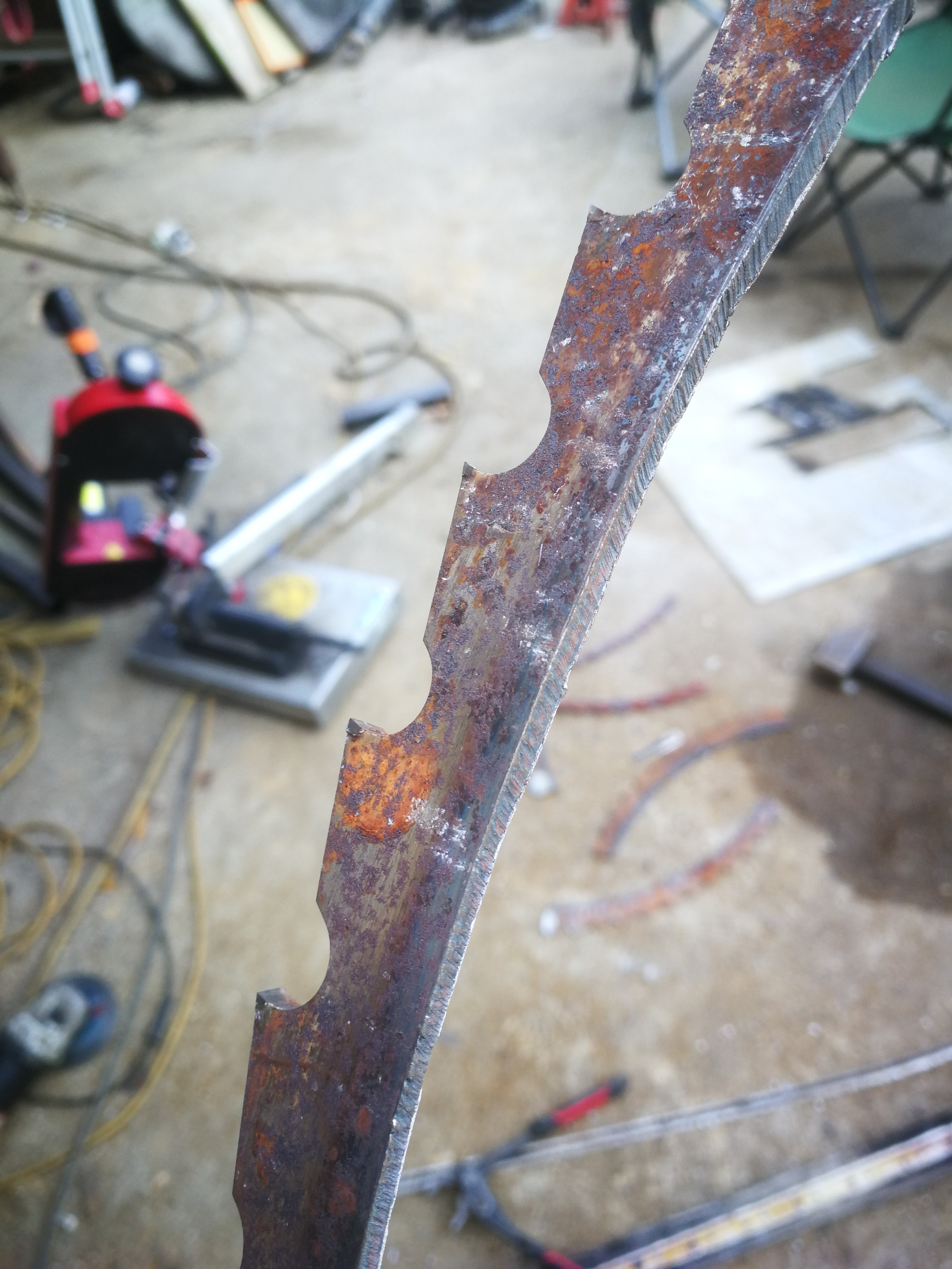

A couple of mismatched videos and photos taken during the process.
And in this video, i can see a strange behaviour, no THC anebled, :
_ the torch goes down to probe the surface >> goes back up >> pierce >> goes back down touching the plate >> goes back up and starts the move
