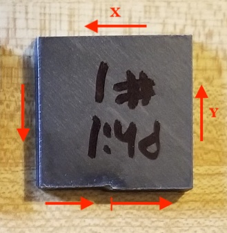

- phillc54
- Posts: 5711
- Thank you received: 2100
15 Jun 2020 18:27 #171787
by phillc54
Replied by phillc54 on topic My Newb Plasma Table Attempted Build
Are your #1,#2,#3 & #4 in the order the files appear left to right in
this post
I just want to orient the pics to match the code.

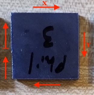

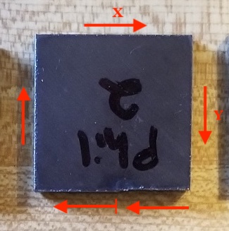

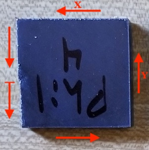

15 Jun 2020 18:34 #171790
by dvn4life1972
The numbers I marked on them correspond to your files left to right. Remember they are marked upside down (X/Y zero is top right)
Replied by dvn4life1972 on topic My Newb Plasma Table Attempted Build
Are your #1,#2,#3 & #4 in the order the files appear left to right in this post

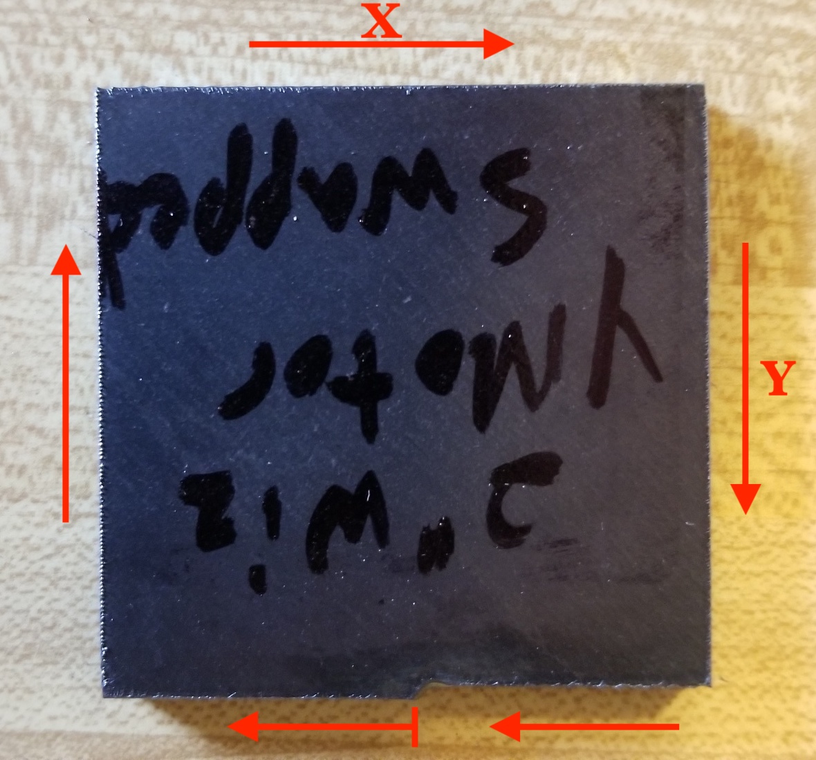

15 Jun 2020 23:23 #171815
by phillc54
#1 and #2 are the same cut beginning and ending at the bottom centre but with reverse direction. The step in them looks to me like a classic case of backlash. It looks like the fourth leg of the cut (Y direction) has come up short.
#2 and #2b are identical but with the Y motors swapped around. The step in #2b looks a bit more pronounced but that may be the picture resolution.
#3 and #4 are the same cut beginning and ending at the left centre but with reverse direction.
#3 looks to me like backlash. It looks like the fourth leg of the cut (X direction) has come up short.
#4 doesn't make sense to me at all, the fourth leg of the cut (X direction) has grown... Are you sure that wasn't a repeat of #3?
I think your table is possessed
