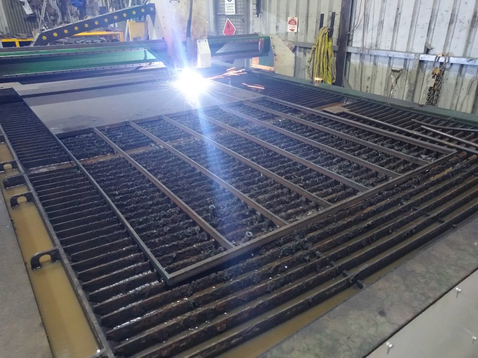

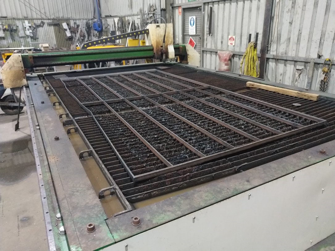

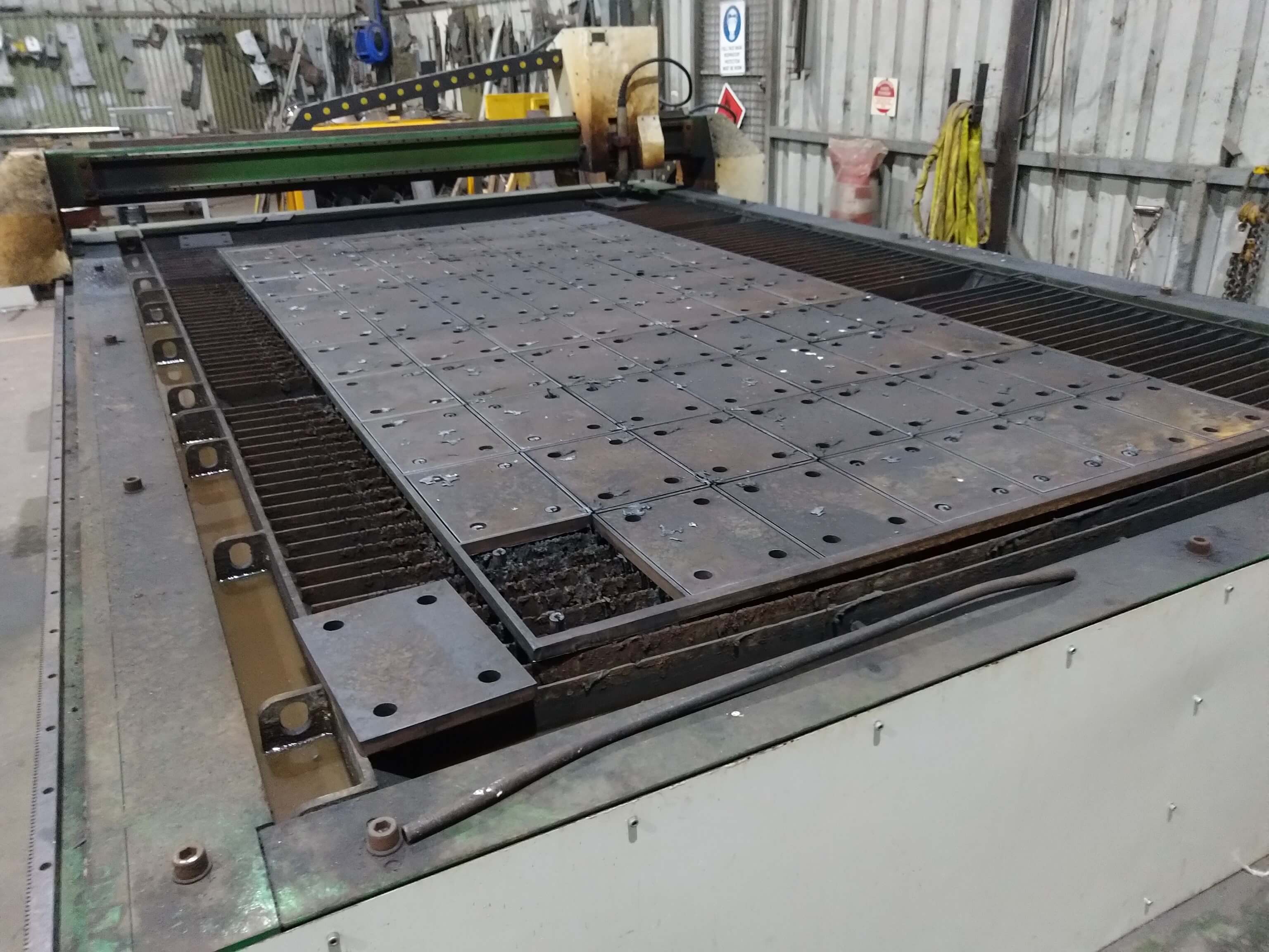

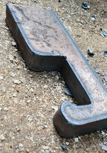

I echo Rods statement,
I cut a bit of 25mm plate ,
And 20mm plate,
I have a Powermax 125, and on the thicker stuff it still struggles. It will do it easily enough but its not the same as cutting say 8mm. I really need a 200 amp unit for cutting the thicker stuff. I dont do it all day everyday tho so the 125 is not over stressed.
Attachment not found
And 20mm plate,

Oops, I was not game to say 125 amps cos there goes another $3-5k
- thefabricator03
- Visitor
13 May 2020 00:02 #167579
by thefabricator03
Yeah they dont miss you. But the MAXPRO200 retails for $23k AUD, not chump change!
Replied by thefabricator03 on topic How to cut thick material from edge
