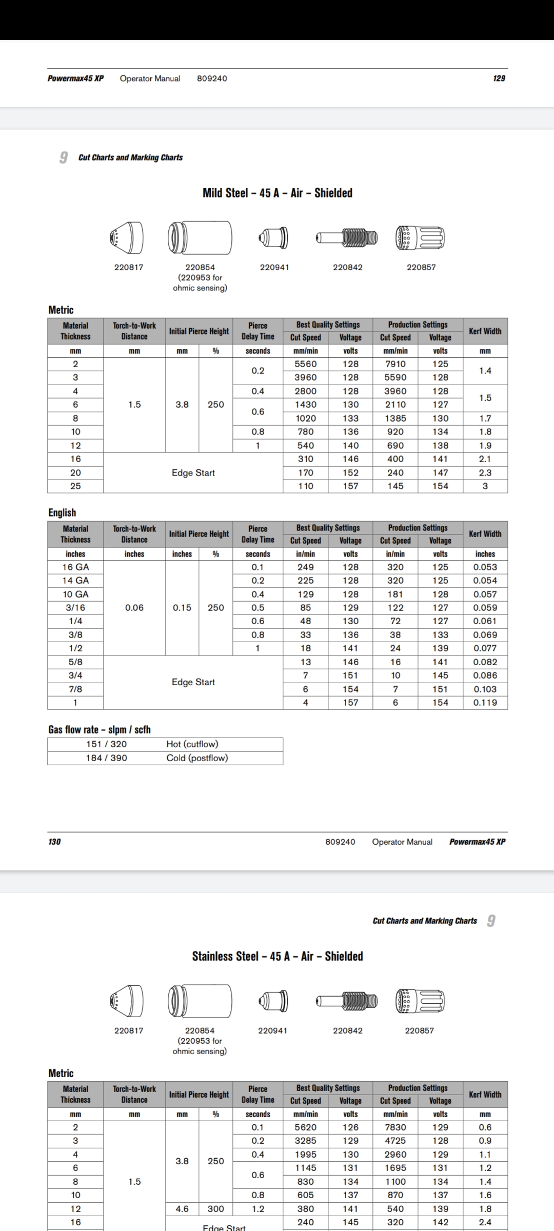

Jog the torch to the edge, set the offsets, start the cut by pressing F9 or by adding M3 at the top of gcode for that part.
Rinse and repeat .
Replied by tommylight on topic How to cut thick material from edge
Manually, there are to many variables to be able to automate that.The question is how to start cut from the edge not with piercing.
Rinse and repeat .

Yeh, we knew what you meant. I had to find your manual. I am surprised they list edge start for material that thick but the proof is in the pudding

Ok, but i do nit want to cut just a straight line. I want to cut an model, and i can put the lead in outside the material but arc ok report that arc is not ok
I do not abuse cutting so thicknes...just some piece.

Set the "maximum velocity" slider to the same as cut speed, press f9, then run from here from the beginning of the gcocde.
In this case, remove the M3 in gcode.
You can cut any shape or form as long as you start each one separately.

Could you not just butt up another piece of steel next to your part and the start the lead in from off the part?

You need to have your torch just on the edge so when it starts cutting it is cutting steel not air, I do this for line cuts to sever sheets by pulsing the torch and the air will slash water from my water tray up. I then jog the machine until I find the perfect spot to start the cut.

Even having the torch about a millimetre or two inside the material works ok, it just sprays sideways a lot.You need to have your torch just on the edge so when it starts cutting it is cutting steel not air, .........
Centring the torch at the edge is easy, you just have to know from what side to look at it.
