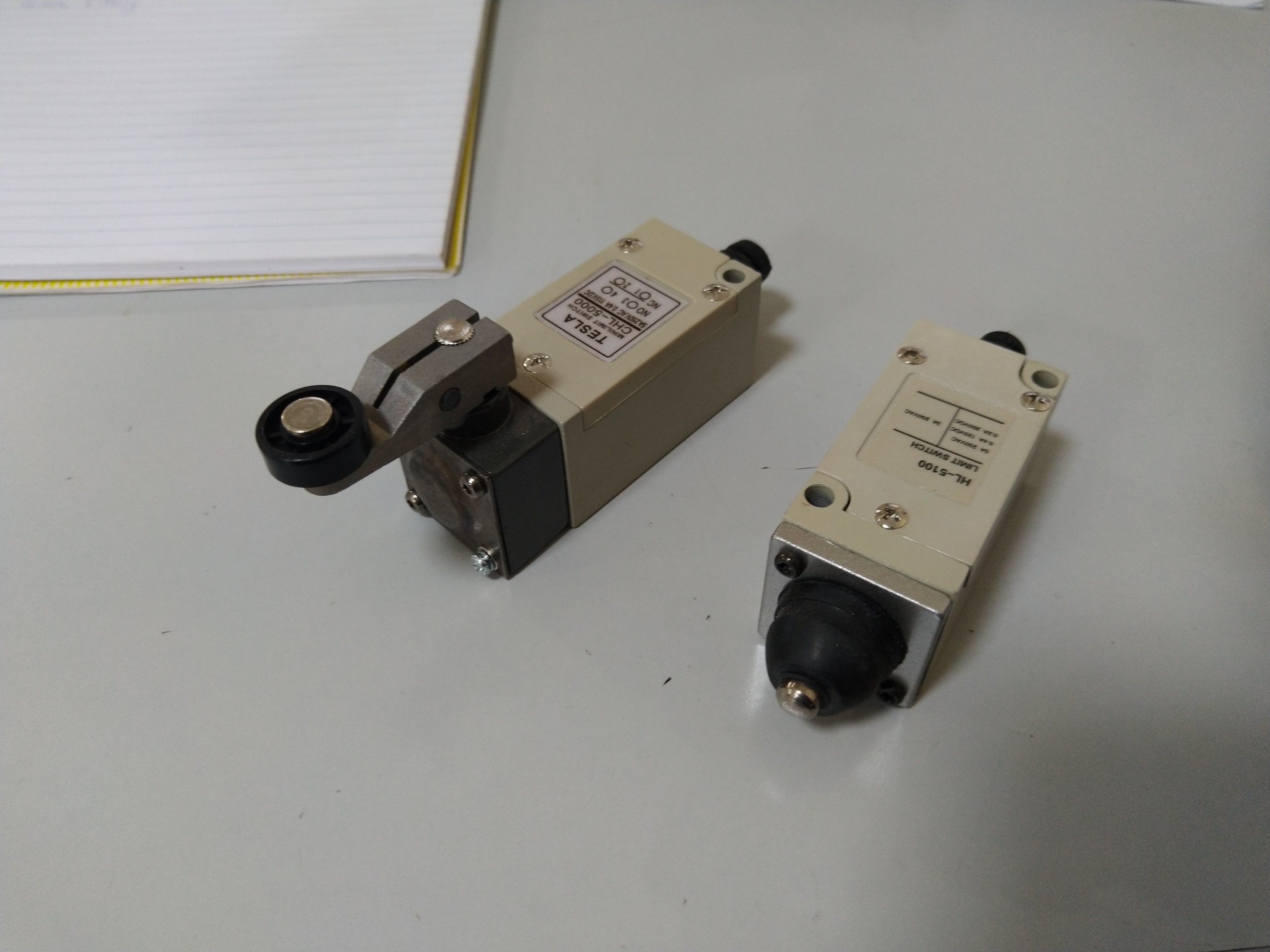

- thefabricator03
- Visitor
21 Dec 2020 22:21 - 21 Dec 2020 22:22 #192736
by thefabricator03
Replied by thefabricator03 on topic Prox sensors for plasma table - Advice needed
I am using these Telsa brand switches I brought locally.
www.teslacomponents.com.au/products/elec...ssories/limit-switch
Last edit: 21 Dec 2020 22:22 by thefabricator03.

Those are heavy duty compared to the toy switches I had been using with my old setup.I am using these Telsa brand switches I brought locally.
