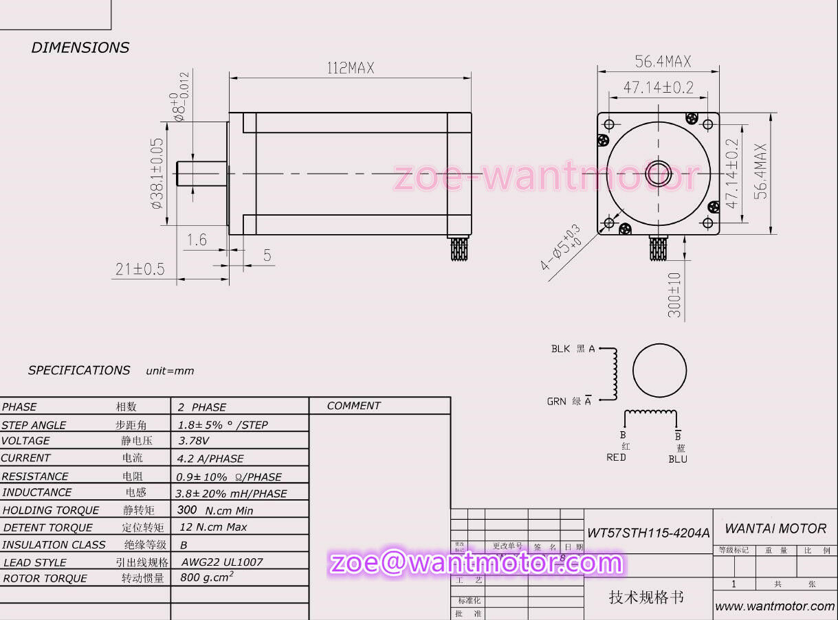

12 Mar 2021 12:49 - 12 Mar 2021 13:04 #201954 by Chris J
Replied by Chris J on topic Plasma build basic questions
Please keep in mind the current table I'm using was bought as a low priced system so I know very little about it.
I just want to try to not make the same mistakes building my own.
The motors on the table I'm using are Wantai WT57STH115-4204A. 4.2A 1.8 deg
The drives are Me 2H Microstep Driver DQ856MA
They are set to 4A RMS / 6.6A peak and 3200 pulse.
The power supplies are 48 volts.
I've attached the info I found on the motors. I assume they're nothing great,
There's two on the Y axis and one for Z and one for X. All but Z are setup as a rack and pinion. Don't know the ratio right now.

12 Mar 2021 22:36 #202020 by rodw
Replied by rodw on topic Plasma build basic questions
They look like they should work depending on gantry weight.
I think What Tommy said about grounding might be required. Bolt a seperate wire to a mounting bolt on each motor and run it back to a star ground point.
I would also seperate the motors from the racks so you can push the gantry around. I can push mine with my little finger like this. If there is any binding, work out what it is and fix it. Then remove the motors so avoid any back emf and do the same thing with the rack and pinion engaged. Perhaps this is the first step. I have a little bit of binding on my X axis rack and pinion when engaged. I think becasue of crappy rack and pinion.
