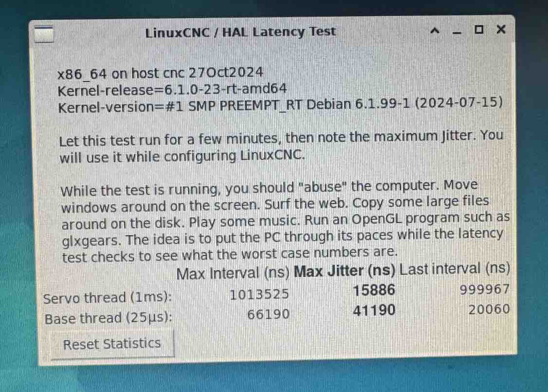

You error is nothing to do with Linuxcnc but related to your hardware. We need to know about your PC, (CPU and network card) First you need to disable any power saving features in your bios that affects latency.
Then follow my advanced guide here which covers all of the gotchas with modern hardware and operating systems.
docs.google.com/document/d/1jeV_4VKzVmOI...diY/edit?usp=sharing

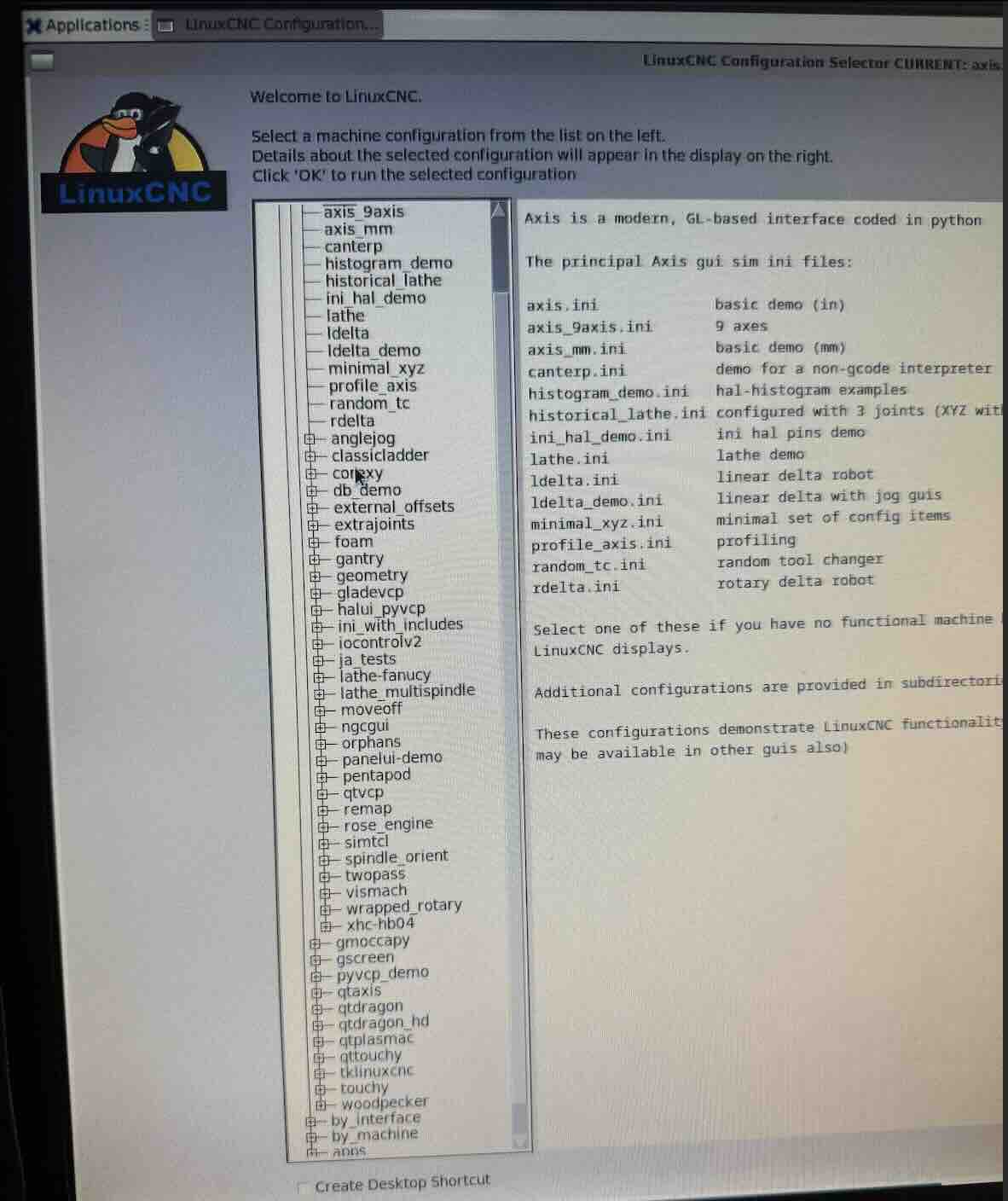

I dont have that option, see attached. only Qtplasma
Last edit: 28 Oct 2024 03:47 by mal136. Reason: adding photo

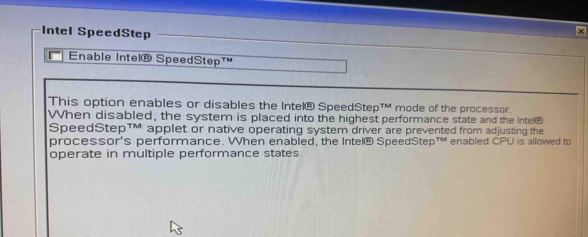

im using a Dell optiplex 780 , What is strange to me is that AXIS works fine on the same exact settings but QTplasma has that error and thus i can't use the THCAD-10 , which was the whole point of me upgrading to the MESA hardware.i did disable dell's performance throttle in the bios and jitter was 15886 , which still didnt alleviate the error on QTplasma when i tried a new PnfConfig..
CPU(from terminal via "lscpu"): Intel core 2 duo CPU E8500 @ 3.16GHz
Network: (from terminal via "lspci -nn | grep -i net"): intel corp 82567LM-3 gigabit network connection(rev 2)

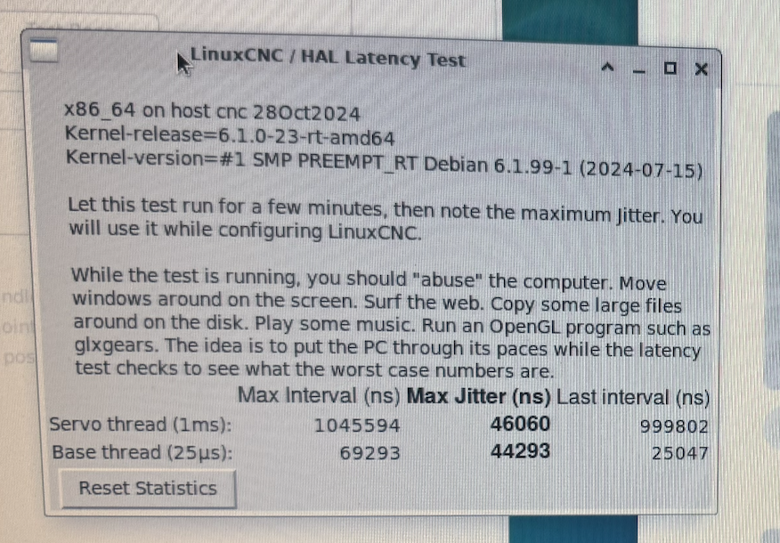

PCW already mentioned the issue, you have to fix it in your ini file, set the "servo period" to 1000000 ( 1 million), save and start the config again.Unexpected realtime delay on task 0 with period 25597
Is this a parallel port setup? (25597 sounds like a parallel port base thread time)
EDIT I see this is a 7I96S configuration but the 25597 thread period makes no sense
in that setup.

I changed the "servo period" to 1000000 and i re-did the config using PNFconfig and the machine moved but the stepper motors just kinda danced back and forth they didnt actually move the gantry at all.
Any advice on why that is occuring?
My jitter went up a lot for some reason and was measuring 46060 for servo thread and 44293 for base thread.
Do i have a hardware issue with my computer ? I'm reading through the linxcnc documents and QTplasma docx as we speak but it doesnt really dive into some of these issues so im a bit lost on what i can do to resolve this.
