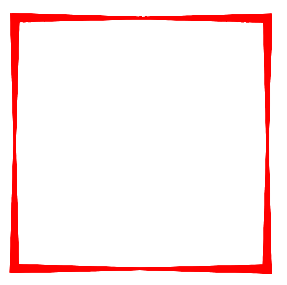

Hi
I want to create a fiber laser marking with linuxcnc and galvo with xy2-100
I could run and use this setup .
But when I want to mark, for example, a square, because of the high speed, the square turns into a circle!
I used g64 for solve this problem.
But my next problem is the increase in speed along the line, and when it approaches the vertex of the square, its speed decreases
There is no problem if the spindle is used, but if the laser is stopped for a long time, it will damage the part.
and finally four points remain from the square
Does anyone have a solution to this problem?

- mahdi2001h
- Posts: 30
06 Oct 2021 15:43 #222374
by mahdi2001h
Replied by mahdi2001h on topic using linuxcnc for laser fiber marking
I increased speed , but my main problem is acceleration i set that to very high , but when pointer close to the shape cornel the speed is decreased .
this is my G code
G00 X0 Y0
G01 X1 Y0
G01 X1 Y1
G01 X0 Y1
This photo may help me convey the message
Where the line is thicker the speed decreases and where the line is thinner the speed increases
this is my G code
G00 X0 Y0
G01 X1 Y0
G01 X1 Y1
G01 X0 Y1
06 Oct 2021 15:52 #222375
Replied by andypugh on topic using linuxcnc for laser fiber marking
I think that the slowing in the corners is probably due to you having G64 Pn active still.
Do you still get this with G64 P0 ? (I would expect a corner rounding instead)
- mahdi2001h
- Posts: 30
06 Oct 2021 16:06 #222377
by mahdi2001h
It works but it does not benefit me.
However at the beginning of the shape and the end of the shape, the increase and decrease of speed still happens.
- Posts: 18105
- Thank you received: 5328
06 Oct 2021 17:47 #222385
Replied by PCW on topic using linuxcnc for laser fiber marking
I think your acceleration is still set _way_ too low
- mahdi2001h
- Posts: 30
12 Oct 2021 12:04 #222927
by mahdi2001h
I set the acceleration to the maximum value and it was solved
But now there is another problem
When the cursor moves at high speed,The square location on the screen shifts
I think that's why I use velocity mode for pid , But I do not know how to solve it.
you are right.I think your acceleration is still set _way_ too low
