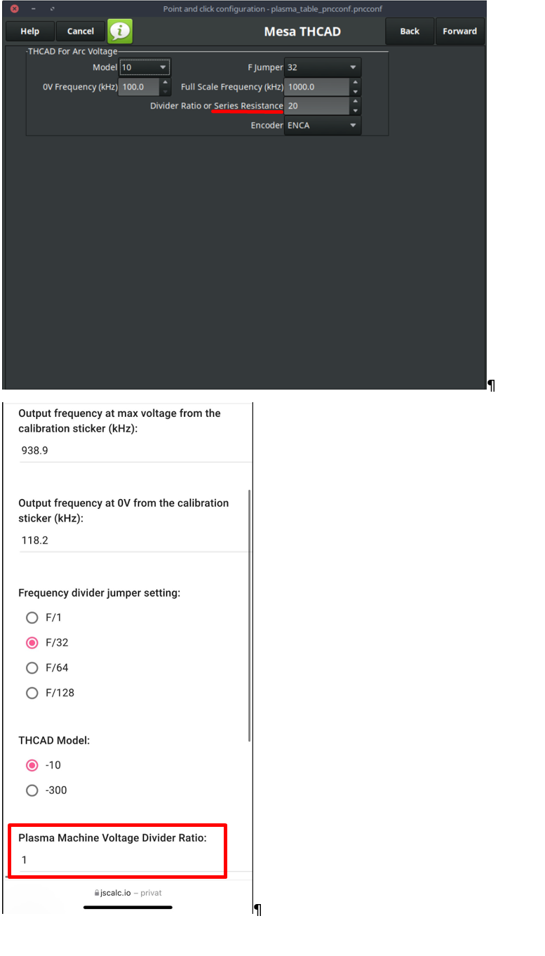

I was about to, but I don’t know where to check the voltage. My thoughts was that I could check the voltage on the torch, but learned that the tip of the torch wasn’t charged. So then I thought that I could check the voltage on the THC input, and to my surprise I got 6.8V. Should I then open my plasma and measure on the torch output or how can I know what voltage I should adjust to? How did you calculate 191V to be the full voltage? It this by experience or can I calculate it?

Hi! I think that i have missunderstod the voltage divider ratio. When i saw the qtplasmac gui then it sais Divider ratio or series resistance. So how do i calculate that? I have entered 1 as i thpout the output was 1:1 but it seams that it's wrong? I'm close now
(I still have that 120k plus 1M resistor in series)

Replied by rodw on topic THCAD 10 to Herocut 55i (1:1)
You have 2 x 120k resistors so 240k extra.
I have never used that calculator.
Someone else will have to help.

For PnCconf:
If you are using a CNC port with a divider ratio then enter the ratio, for a 20:1 ratio you would enter 20.
If you are using series resistors then enter the total value of the resistors, for 2 x 1M resistors plus 120K you would enter 2120000
Edit: The Help button displays an explanation of this.

you would enter 2240000 not 2120000

If I entered those values the voltage was totally wrong. My thoughts now is to open the plasma and tap in to the raw arc voltage.
Do i do it like this:
I adjust the offset so it shows 0V
fire the plasma and measure the raw voltage and then change the scale to show the same value?
I now upgraded to 2.9 and run qtplasmac and i now got it to work!

the offset should be based on the thcad calibration 0 volt frequency ususally 1/32 of it if using 1/32 divider setting as recommended.
It would be best to ignore calculators and use the THCAD manual and QTplasmac manual and fully understand what you are doing
