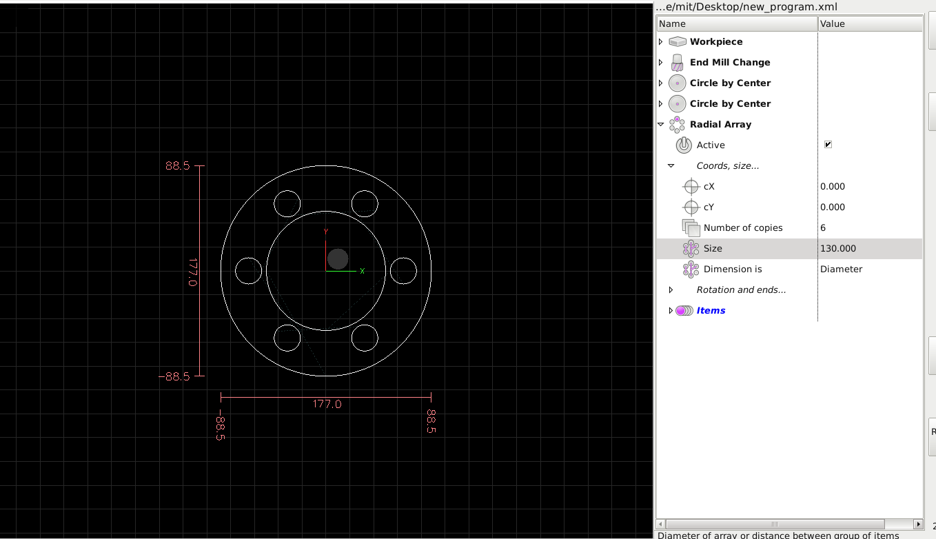

This is not meant as a CAM replacement, it is just for basic shapes for a quick cut.Haven't anybody considering using NativeCAM? It has all the features that are shown in this video and many more. Plus a nice user interface.
It is also very easy to add new shapes as ngc subs, or you can use external executables to generate gcode.

neither is NativeCAM. It just does the same thing as yours scripts but it has a nice user interface.

It is a little crude but it does seem to work.Could you array an existing part? Eg. draw 1, cut 20
