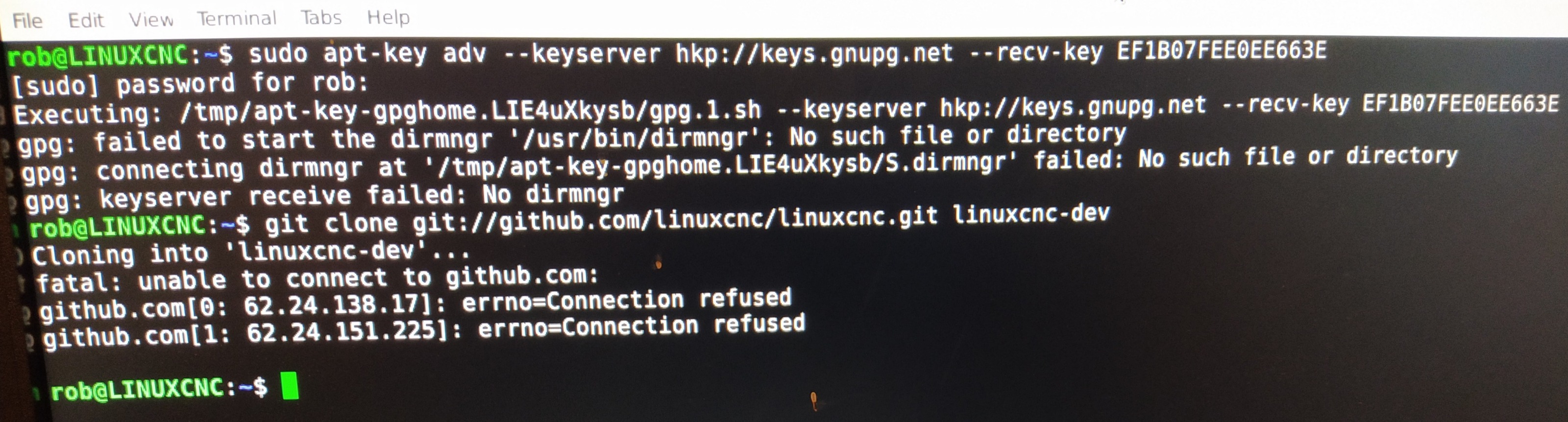

20 Feb 2020 08:07 #157945 by robertspark
Thanks all for the posts
I'll try again tonight
These are the screenshots I was getting.
20 Feb 2020 08:17 #157946 by rodw
Robert, that git error is strange as that is exactly what I typed today and it worked perfect. I took it from here:
linuxcnc.org/docs/2.8/html/code/building...cnc.html#Quick-Start
20 Feb 2020 08:25 #157947 by rodw
ON a bit of a google, the error is either from a proxy which can be fixed in the git config or the port git uses is closed.
20 Feb 2020 08:27 - 20 Feb 2020 09:05 #157950 by phillc54
Try port 80 like in the second line here:
linuxcnc.org/docs/devel/html/plasma/plas...tml#buildbot-install
Well that was dumb, I am talking about the wrong thing...
Last edit: 20 Feb 2020 09:05 by phillc54. Reason: It was wrong
