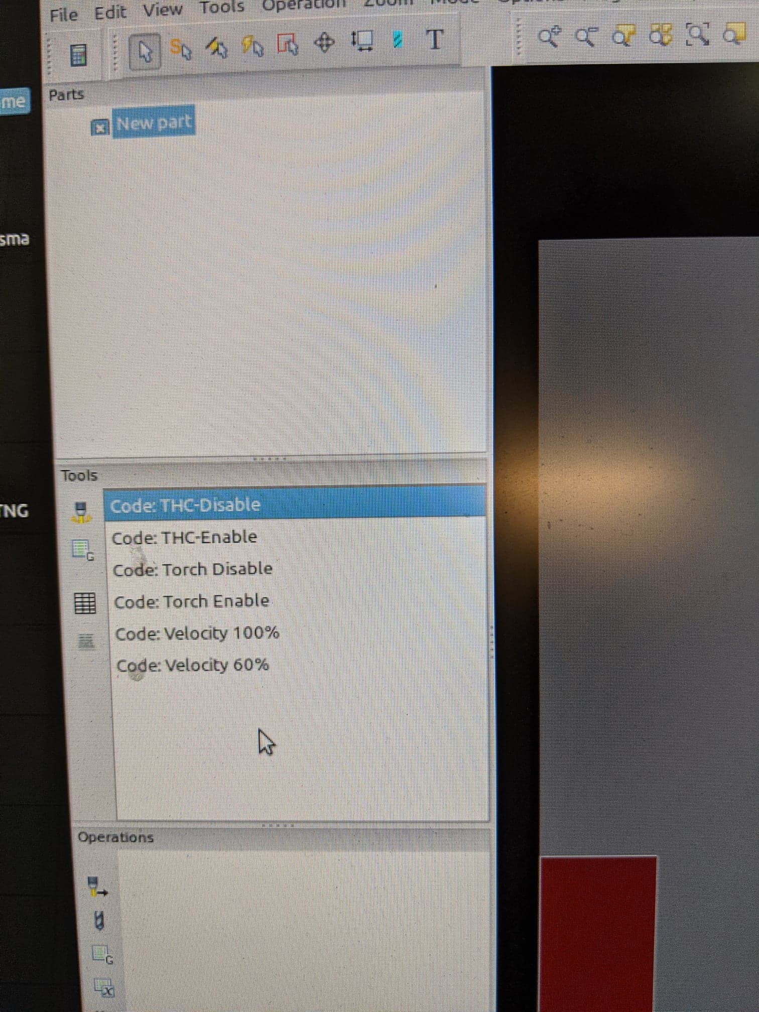

- bevins
- Posts: 1947
- Thank you received: 338
12 Mar 2021 12:19 #201952
by bevins
Replied by bevins on topic PlasmaC Post on Sheetcam
Can I just create all my tools in sheetcam and use those with Plasmac without any issues?
I dont need Plasmac to auto choose materials etc.....
- snowgoer540
- Posts: 2580
- Thank you received: 907
12 Mar 2021 13:21 #201958
by snowgoer540
The picture you posted is of the included cut rules with the post processor. From there you create your .tools file with all the materials and parameters if you’d like. You need at least one to post from sheet cam I believe.
This goes over everything I think you’re asking about material conversation from sheet cam and material handling (auto vs manual):
linuxcnc.org/docs/devel/html/plasma/plas...html#_materialverter
The manual really is a good read.
Replied by snowgoer540 on topic PlasmaC Post on Sheetcam
