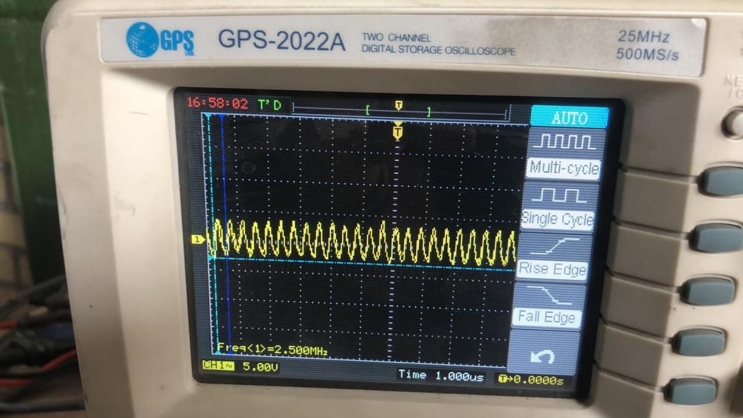

29 May 2022 23:19 - 29 May 2022 23:21 #244157
by taloot
Replied by taloot on topic PlasmaC Fiber laser 1Kw head height control + auto focuas
Last edit: 29 May 2022 23:21 by taloot.

29 May 2022 23:22 - 29 May 2022 23:25 #244158
by taloot
taloot.
Thank you for the video.
I mentioned the LFS-AP01 capacitive sensor, you mentioned the BCL-Amp was better.
Can you explain how this could be ?
I went back and tested a BCL-Amp and it didn't register any reading of signals out.
The LFS-AP01 I am testing registers 0.03v to 0.04v sensitivity, do I need a better read value than this ?
When the LFS-AP01 is put through the DT-115 it reads 0.003v sensitivity.
Are you using G and M codes for your operation ?
It would good to see the header and footer notes in the file.
Cheers.
problem with response time and accuracy
Last edit: 29 May 2022 23:25 by taloot.

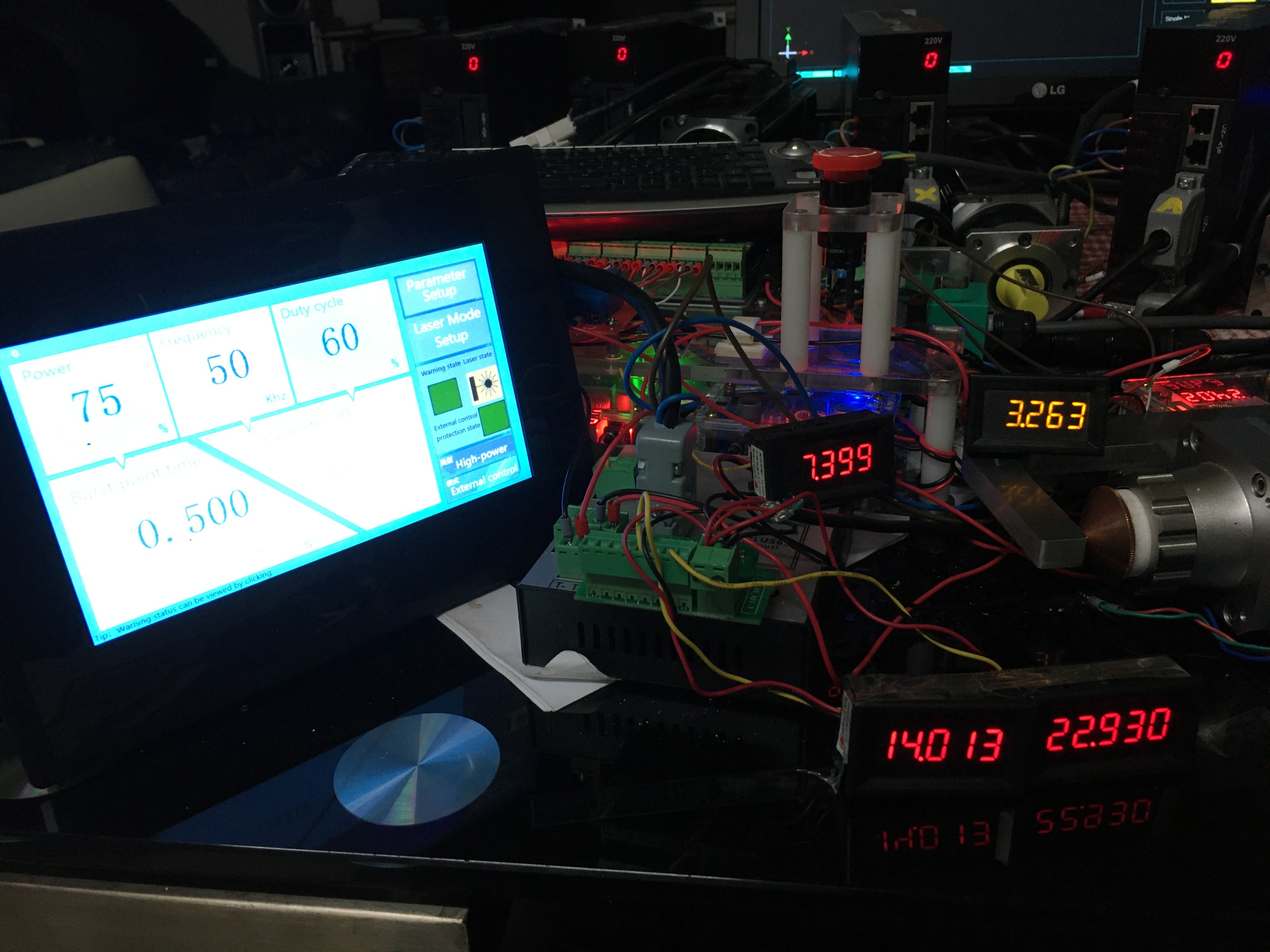

31 May 2022 08:13 - 31 May 2022 08:18 #244265
by Lilow
Replied by Lilow on topic PlasmaC Fiber laser 1Kw head height control + auto focuas
taloot.
The LPC-PLUS6 is in the photos attached.
It may save all the pain of what you have been doing.
This could save all the problems of regulating 0 to 10v for power, 0 to 24v for PWM modulation, gives 23v for the laser enable plus the 2 signals as feedback.
It also has 8 pre-programing situations you can sort yourself for different applications.
Screen, 75% of power 7.399v.
60% of Duty circle ( PWM ) 14.013v.
The 22.930v is the enable signal for the source.
The 3.263v is the reading of the LFS-AP01 capacitive sensor.
Cheers.
