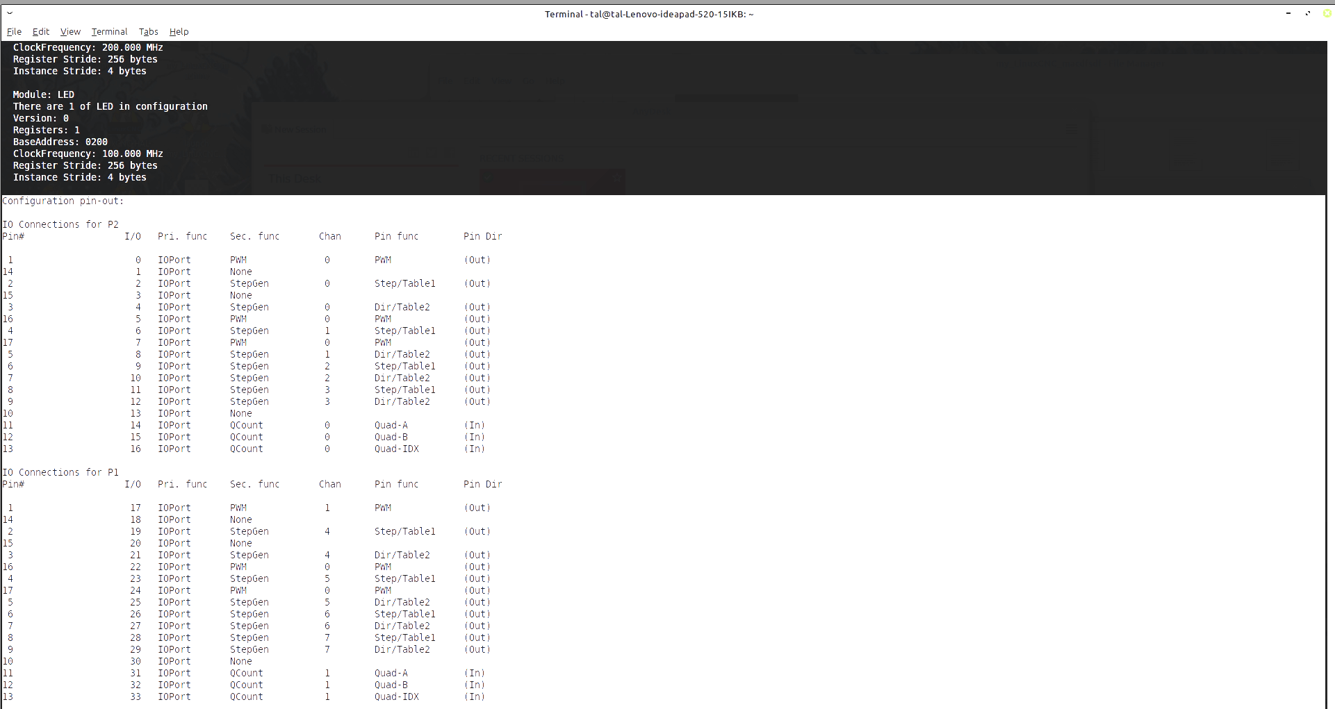

03 Sep 2020 19:49 - 03 Sep 2020 19:52 #180573 by taloot
this is the pinout ... but very confusing...
which number is correct
Last edit: 03 Sep 2020 19:52 by taloot.
03 Sep 2020 20:10 #180574 by PCW
They are both correct
The first column "Pin#" is the DB25 pin number (physical pin)
The second column "I/O" is the GPIO number (which determines the logical GPIO name in hal)
The fifth column "Chan" is the channel number of the pin function (StepGen, PWMGen etc)
Pncconf lists the channel number for StepGens etc and the GPIO number
for pins that are GPIO only

03 Sep 2020 21:00 #180589 by PCW
To me it looks like you have a choice
P1 PWM on pin 1,16,17
P2 PWM on pin 1,16,17
Right, there are 6 PWM gens in the firmware:
PWMGen 0 P2 pin 1
PWMGen 1 P2 pin 16
PWMGen 2 P2 pin 17
PWMGen 3 P1 pin 1
PWMGen 4 P1 pin 16
PWMGen 5 P1 pin 17
(pin numbers are DB25 pin numbers)
