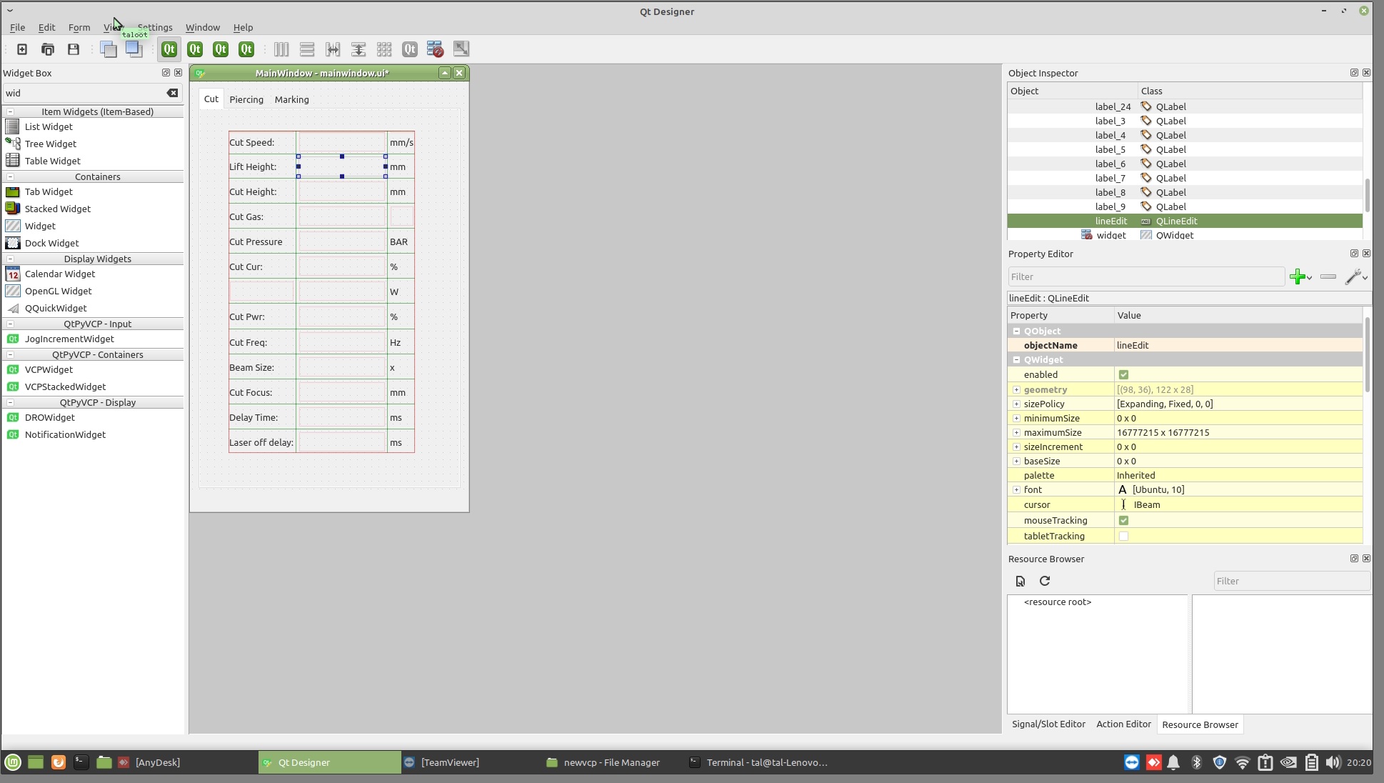

this is 3 main tabs
i will add monitoring for gas too
any tips will be appreciated
almost i fixed gas and laser operation
but i still have 1 problem need to be solved the best way.
the capacitance need to be calibrated at about 3 mm away from metal
and i want to probe directly to pricing height.
is it better for me to make new THC + ohmic component?

06 Aug 2020 03:28 #177462
by phillc54
You could set the pierce height to 0.01 (it wont accept 0) and factor that out with the ohmic probe offset (it will take negative values) in the config panel. If cut height is the same as pierce height then set it to 0.01 as well.
Replied by phillc54 on topic PlasmaC modification to fit fiber laser rs485 control head capacitance Autofou
If I understand you want to probe down and when it is 3mm above the material you want it to stop and that will be the pierce height. I assume the capacitive probe will tell you that it is 3mm away.but i still have 1 problem need to be solved the best way.

06 Aug 2020 12:13 #177500
by phillc54
Sorry, I confused myself here.
If you use the ohmic input and your capacitive sensor senses the material at 3.5mm above the material then you would set the ohmic offset to -3.5, then you set the pierce height and cut height to what they should be.
There is one issue that I have just discovered. After PlasmaC senses the ohmic input it sends the torch to zero height which would touch the torch against the material. There is no need for it to do that so I will take a look at it tomorrow.
