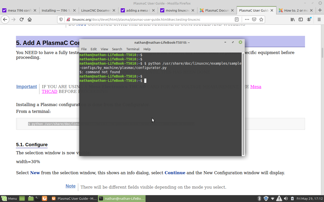

30 May 2020 00:09 #169366
by Nate
plasmac install error was created by Nate
- Posts: 12159
- Thank you received: 4151
30 May 2020 00:13 #169367
Replied by rodw on topic plasmac install error
Check the file exists where you think it does.

30 May 2020 00:18 #169368
by Nate
Replied by Nate on topic plasmac install error
I am new to all this how do I do that
- Posts: 12159
30 May 2020 00:32 #169370
Use the file browser and navigate the folder structure looking for configurator.py
I use a run in place (compile from source) config so my files are in a different place.
You should be able to double click on it to run it when you find it with luck!
- Posts: 12159
30 May 2020 00:33 #169371
Hang on, you have an extra $ sign at the beginning of the command line. Remove that and it should work...

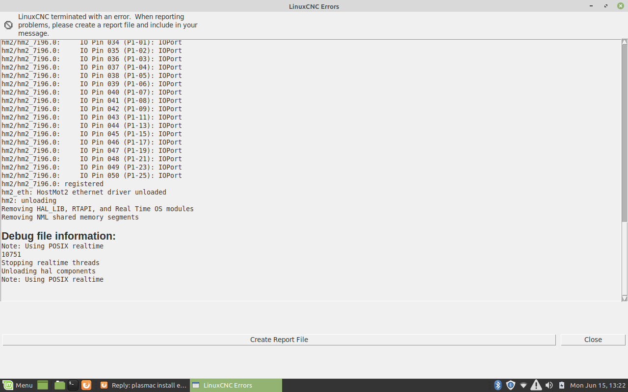

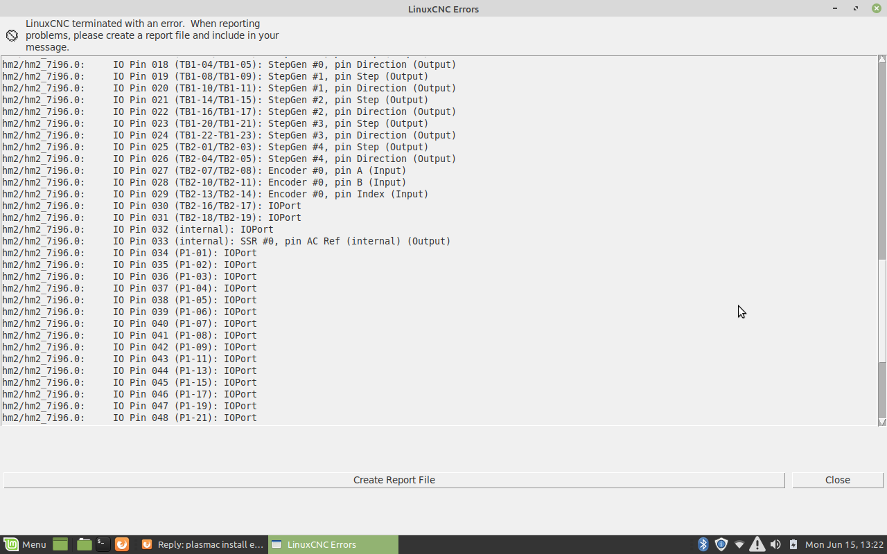

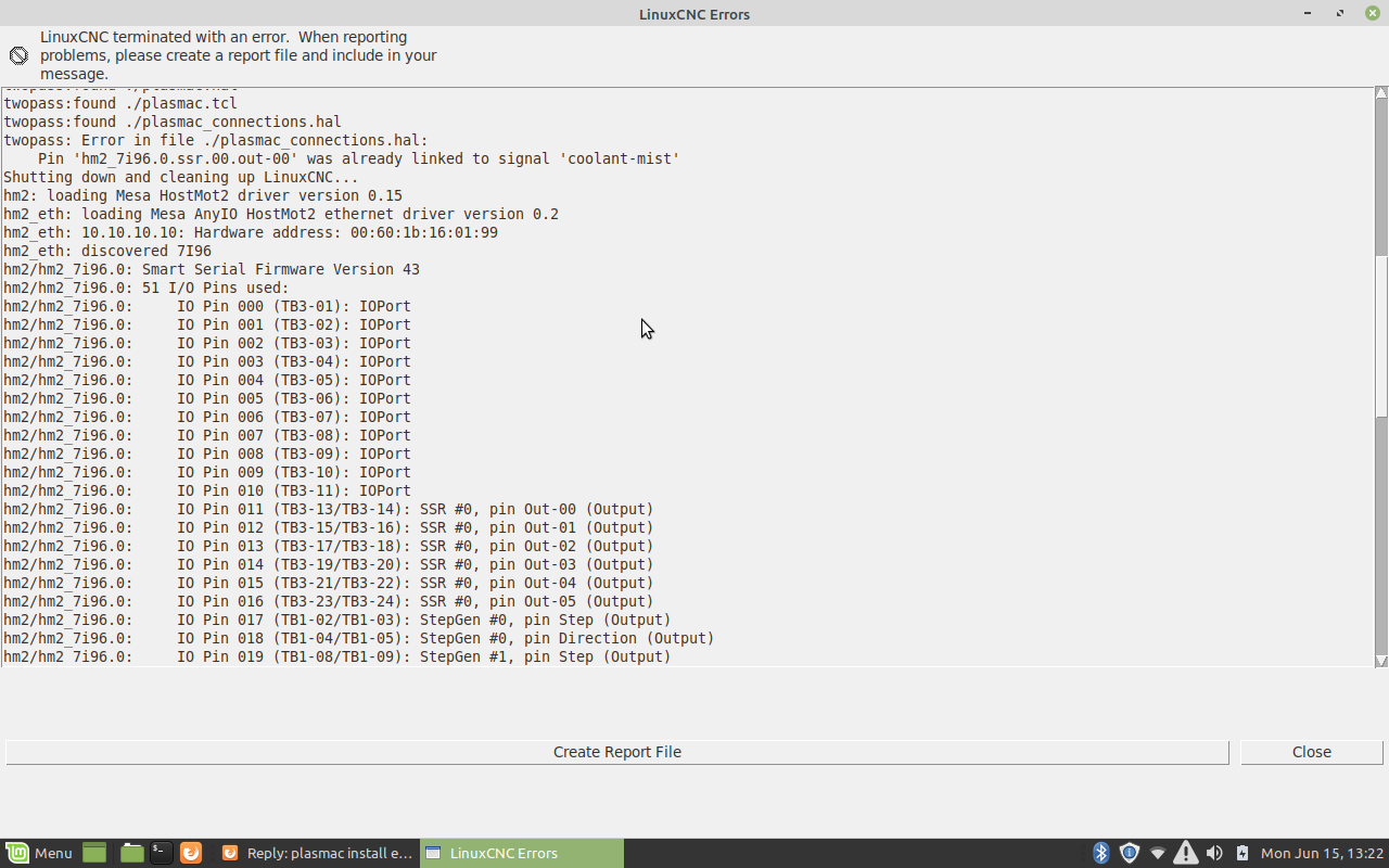

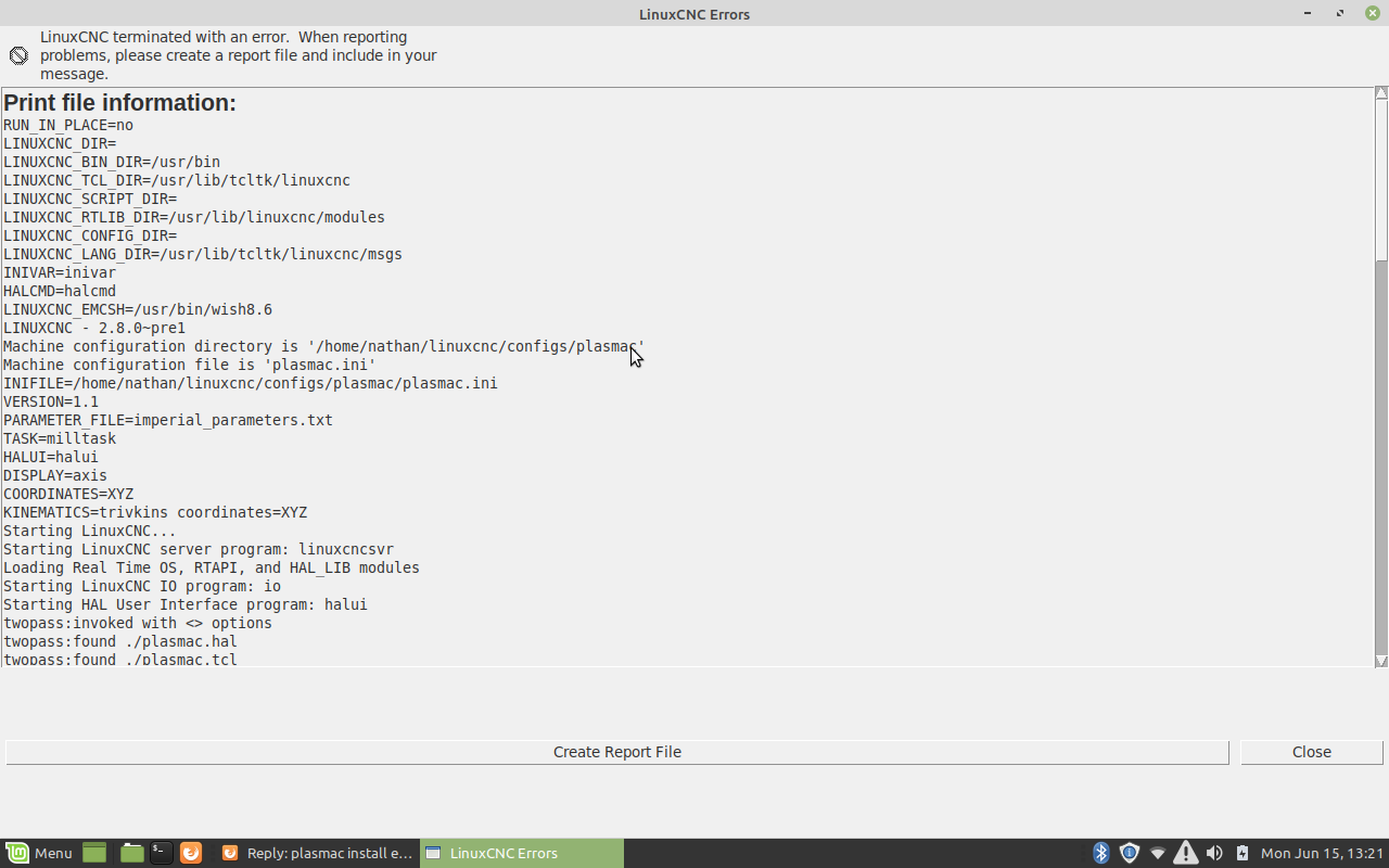

15 Jun 2020 19:25 #171763
by Nate
- Posts: 22002
- Thank you received: 7488
15 Jun 2020 19:50 - 15 Jun 2020 19:51 #171764
Replied by tommylight on topic plasmac install error
You have the same coolant pin connected twice in one of the hal files, and that brings the question: why do you have coolant set for plasma ?
Edit:
Just delete the line with coolant mist in the plasmac_connections.hal file.
Edit:
Last edit: 15 Jun 2020 19:51 by tommylight. Reason: More info
