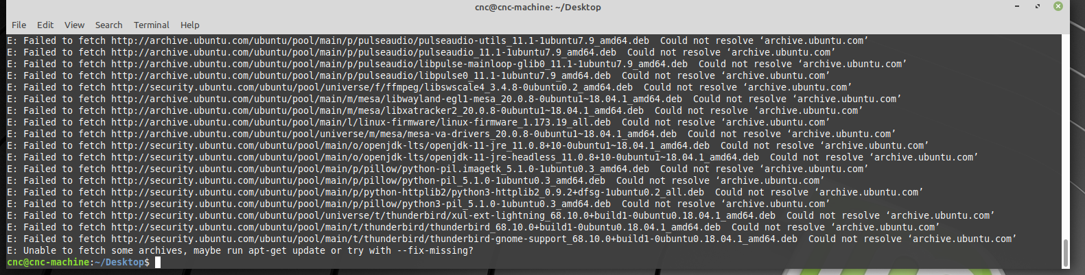

I am having a problem updating the config the one I am trying to update is on linux 2.8 under the config it is showing around V0.124
I have run sudo apt-get update and sudo dist-upgrade without success. I have also tried using through the configurator and clicking on upgrade that tells me it is up to date but it should be showing about V 0.146.
Is there a problem with the linux bot ?

That looks like your sources file is incorrect or you have connection problems.

I have just run it again using the terminal with its saved commands. It ran fine and went through and completed without errors.
I have done this many time before so happy with the commands.
But looking in the plasmac_config.py it still shows . self.plasmacVersion = 'PlasmaC v0.126'
But I don't have a card connected so can't fire up plasmac
Edit: I will go and do it on my machine in the garage
