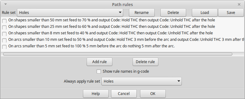

Has anyone successfully written cut rules in sheetcam for plasmac? When I write cut rules for turning the thc on or off, the machine noticeably slows down at the cut rule and speeds back up after. I messed with the length before and after the rule to make sure that I wasn't just seeing a loss in velocity due to it being at a direction change. I removed velocity slow down cut rules to rule those out, and it's at every cut rule it slows the table down. Any ideas why it would do that? I would like to be able to turn the velocity down to 80% on corners along with the thc on and off. The thc on and off works great, but it's slowing down when it gets to those points.

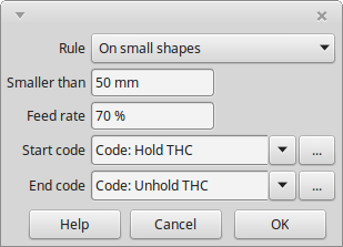

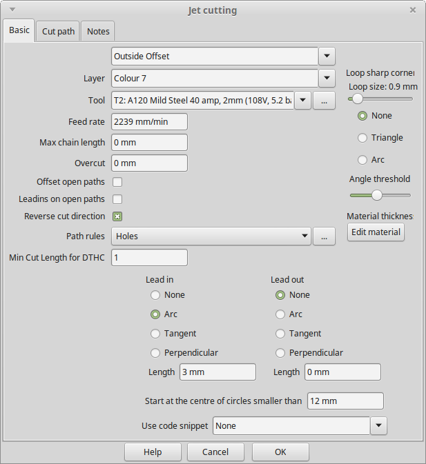

I have used the hole cutting rules by attaching a rule set to the sheetcam plasma operation. I have posted it somewhere on the forum with some screen dumps but I could not find the thread. Plasmac has its own automatic version of hole processing and you can change the velocity slowdown applied.
Can you advise how you are applying the slow down and what gcode you are using?

I don't think I said anything but I think if you have a linear move and you break it into 2 with a M62, it probably pauses to execute it. This is what I set up but I don't often use it.

I don't think the hold THC commands are necessary as the corner lock will disable the THC for us anyway.
