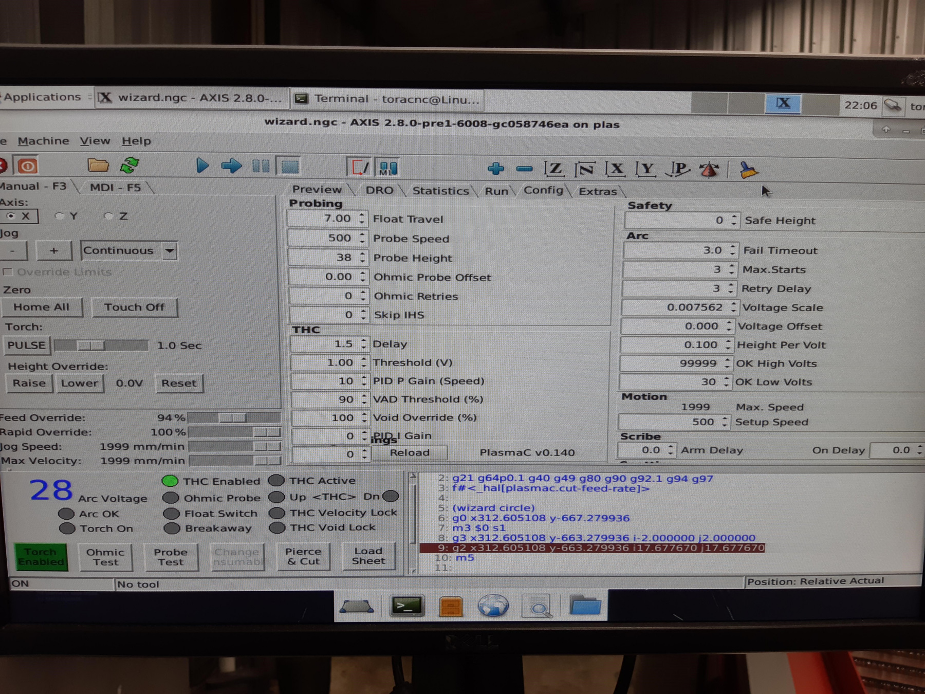

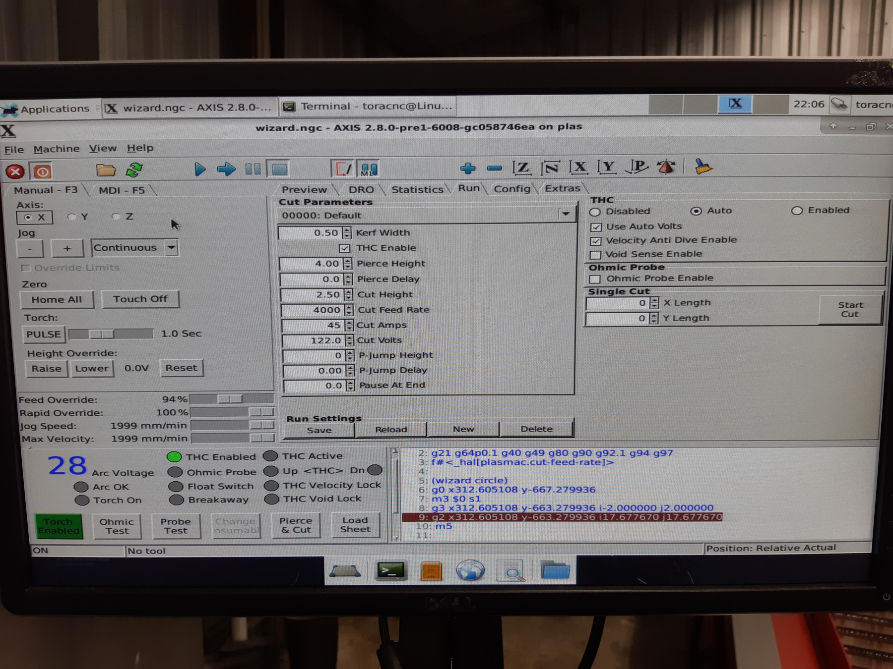

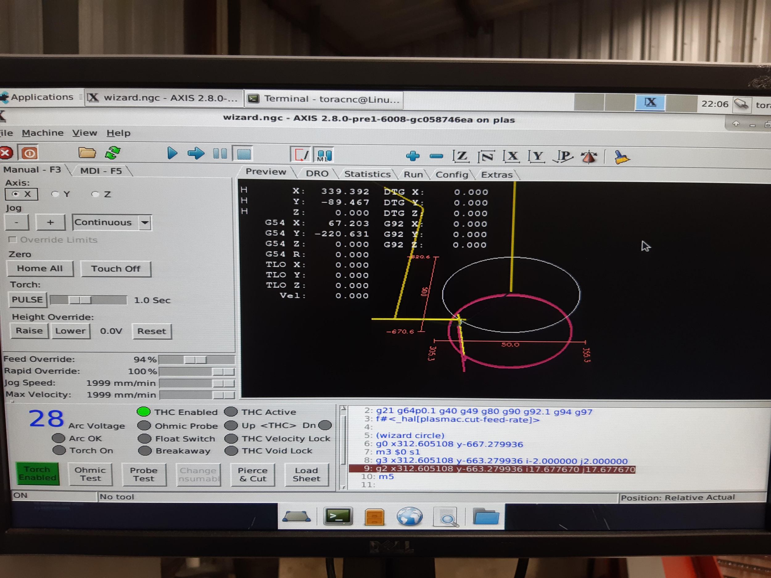

13 Aug 2020 07:36 - 13 Aug 2020 07:44 #178079
by luftlupus
Replied by luftlupus on topic Mesa Thcad-10 as the THC?
So i did some test cuts today and checked that thc was enabled as such which it was. I had just been using the extras tab to cut some circles at the moment, but still noticed that there was no z movement when in operation? does there need to be some kind of command in the gcode to enable thc during the cut? Cheers for any advice

- Posts: 22026
- Thank you received: 7501
13 Aug 2020 07:41 #178080
Replied by tommylight on topic Mesa Thcad-10 as the THC?
Attach screenshots of the "run" and "config" panel please.
Does the voltage on screen fluctuate during cutting ?

13 Aug 2020 07:45 - 13 Aug 2020 07:46 #178081
by luftlupus
added to previous post. Also i do see slight fluctuation yes depending on height from metal
