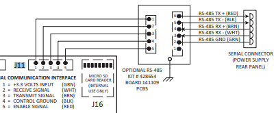

I would like to check if you know if Hypertherm RS485 board is just a converter from RS232 from the mainboard to RS485 (RS422 to be more specific) for running over longer distances?
Does anyone know the pinout of the connector J11 from the main board of Hypertherm 45XP?

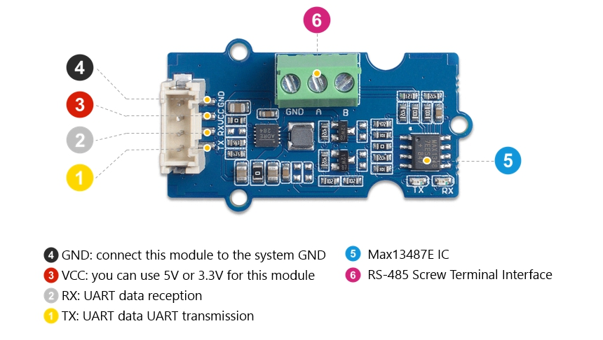

I'm planning to connect one of the modules I have found from some Arduino projects and see if it will work with my ModBus software.
I'm puzzled by ENABLED pin - I'm guessing that pin 5 is either the voltage going back to the main board to tell it that the extension is in place or the other option - the main board activates / deactivates the extension somehow.
More reading will be required.

19 Oct 2020 15:04 #186587
Replied by tommylight on topic Hypertherm board pinout for RS485 extension board
There is no pin 5 there, that is the IC.
And having Rs485 does not replace THC, they are not the same thing, so as you said more reading.

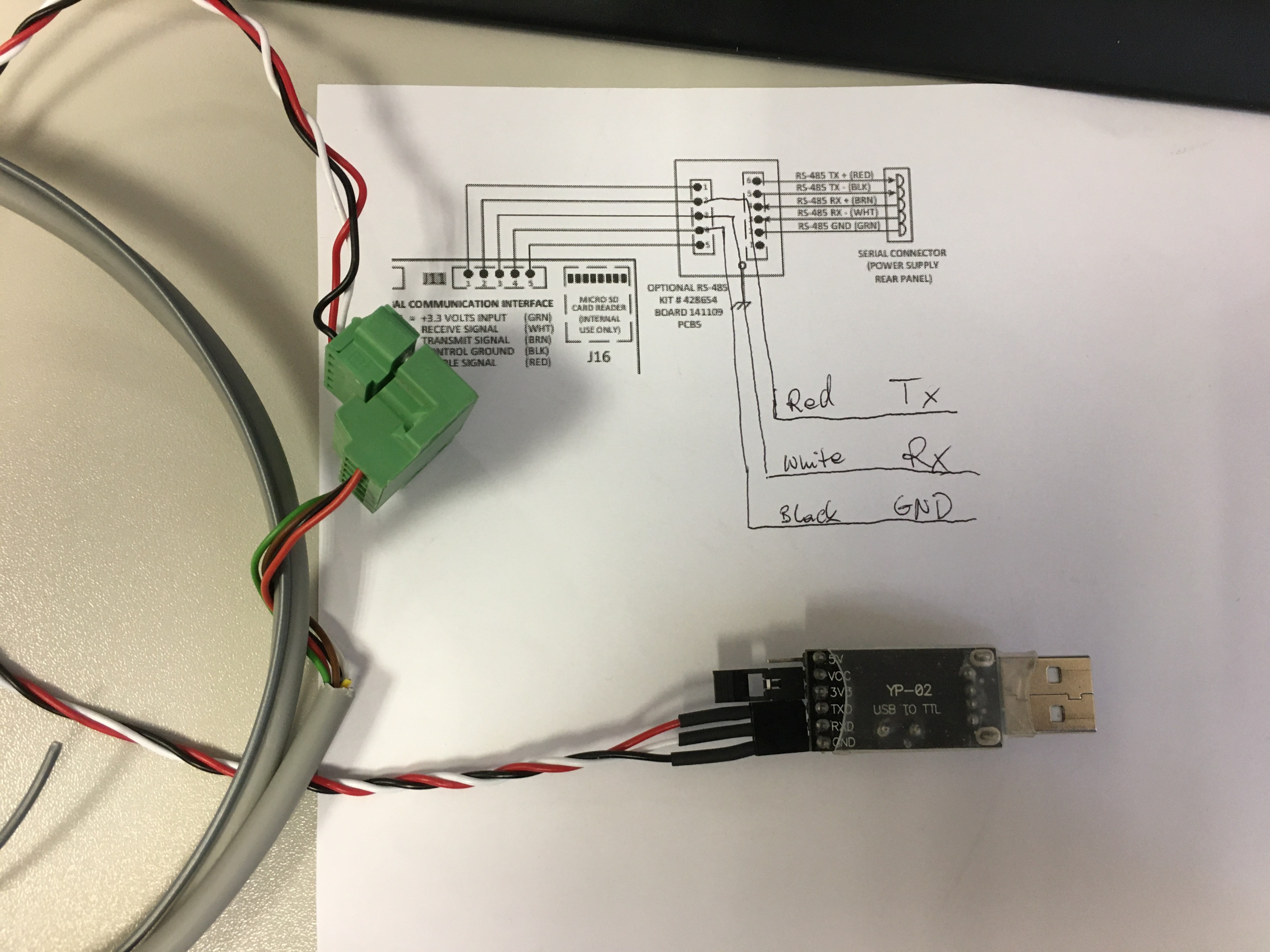

19 Oct 2020 16:56 #186592
by radek_marko
2. I have RS485-to-USB converter for the PC side in my hand
3. I was hoping that data provided over ModBus to LinuxCNC / PlasmaC can give me THC functionality
For the Hypertherm module I would need to:
1. Buy module
2. Buy RS485/RS422 converter for PC (4-wire converter RS422 to RS232 on the PC side)
I could RS422 converter from the office as I have Westermo MA-45 - it was used on some old projects...
As Tommy said
Replied by radek_marko on topic Hypertherm board pinout for RS485 extension board
1. I have RS232-to-RS485 module for the plasma side in my handWhat’s the reason you don’t just buy Hypertherm's module?
1. Buy module
As Tommy said
- that means that my intentional purpose will not be filled, so I might abandon project or just do it for fun...RS485 does not replace THC

Replied by rodw on topic Hypertherm board pinout for RS485 extension board
The interface you have is not 4 wire rs485 that the Hypertherm uses
This one is
www.mikroe.com/rs485-3-click
Like you I am puzzled by the enable signal. I wondered if it was not for DSR or CTS
It would be interesting to see if this chip actually worked. as it would save a lot of cash
This one is

20 Oct 2020 10:02 #186665
interesting. It should work.
I guess the RS485 adds greater noise immunity in a noisy environment.
It would be better to avoid the USB and use a UART on the PC. as USB does not like noise.
Keep me posted. I actually bought a couple of those 3 click boards, waiting for them.
