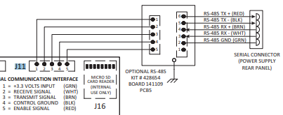

OK, just returned from the workshop and I couldn't get any communication on J11 (expected RS232)
Connection tested using serial params 19200,8,EVEN,1, I've tried several ModBus ASCII apps, even sending a single command as per serial reference doc - no response from the plasma unit.
I think the issue might be in "ENABLE SIGNAL". I've tried to leave it not connected, supply 3.3V to it or connect it to the ground - no joy.
Are there are any proud owners of RS485 board here who have any electronic knowledge and are willing to check how this signal is connected on the original board?
Initially, I was expecting that data available over ModBus / serial link might be sufficient to make PlasmaC act as THC (e.g. by reading arc voltage and adjusting torch hight). That was clarified by Tommylight as a not appropriate approach.Maybe I've gotten lost in the thread... but what exactly are you trying to achieve?
Looking on the pinout make me curious and check if signals on connector J11 on the mainboard are RS232 (3.3V TTL to be more specific) and if those signals can be used for ModBus coms without the original extension board.

I have revisited this project with a direct RS232 TTL 3.3V to USB converter to eliminate RS485 element from the equation, but still no luck
Looktween thing on the pinout I'm wondering - why the pin +3.3V is called "INPUT". Using multimeter I've checked that there is +3.5V between this pin and the ground.
Does anyone have a faulty Hypertherm board and can trace those pins?

18 Apr 2021 11:19 #206294
Replied by rodw on topic Hypertherm board pinout for RS485 extension board
I always wondered how the enable worked. I figured it was to do some kind of handshaking between the Hypertherm RS232 board and the machine to prevent bypassing their hardware.
There is an interesting little board here www.mikroe.com/rs485-3-click
It presents the correct RS485 pins It might be possible to get one of these working.

18 Apr 2021 12:15 - 18 Apr 2021 12:15 #206298
Replied by PCW on topic Hypertherm board pinout for RS485 extension board
Enable is most likely the RS-485 transmit-enable signal
Its _probably_ active high. This is required for 2 wire
(1/2 duplex) RS-485 connections.
Last edit: 18 Apr 2021 12:15 by PCW.

18 Apr 2021 16:19 - 18 Apr 2021 16:20 #206313
The Hypertherrn interface is bi-directional you can set various parameters but also
read status and fault conditions.
Note that both 2 and 4 wire RS-485 interfaces are bidirectional, but only 4 wire
interfaces can transmit and receive at the same time (full duplex). 2 wire interfaces
transmit and receive on the same pair so must disable the transmitter when receiving
(1/2 duplex) Kind of like "push to talk"
Last edit: 18 Apr 2021 16:20 by PCW.
