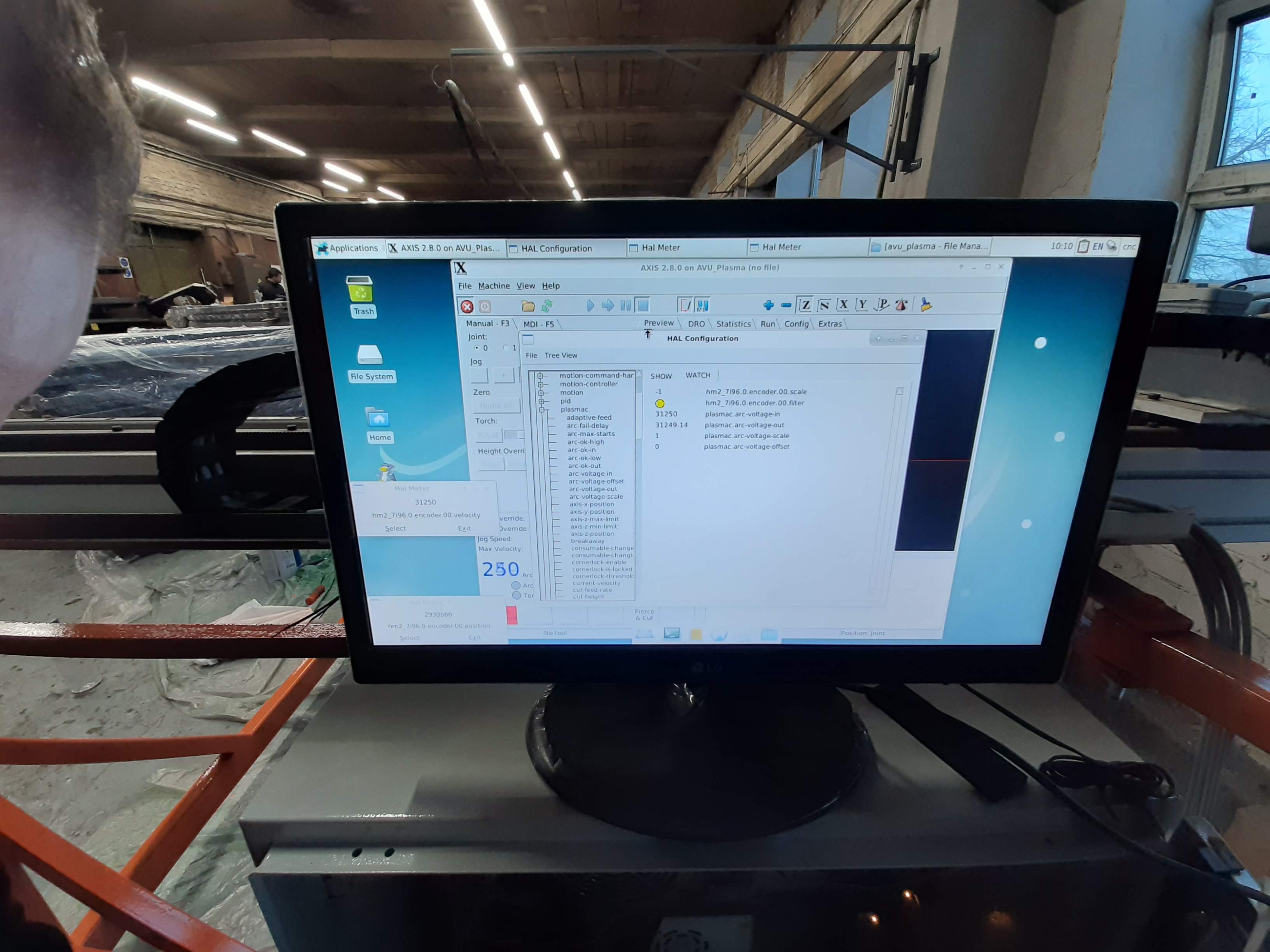

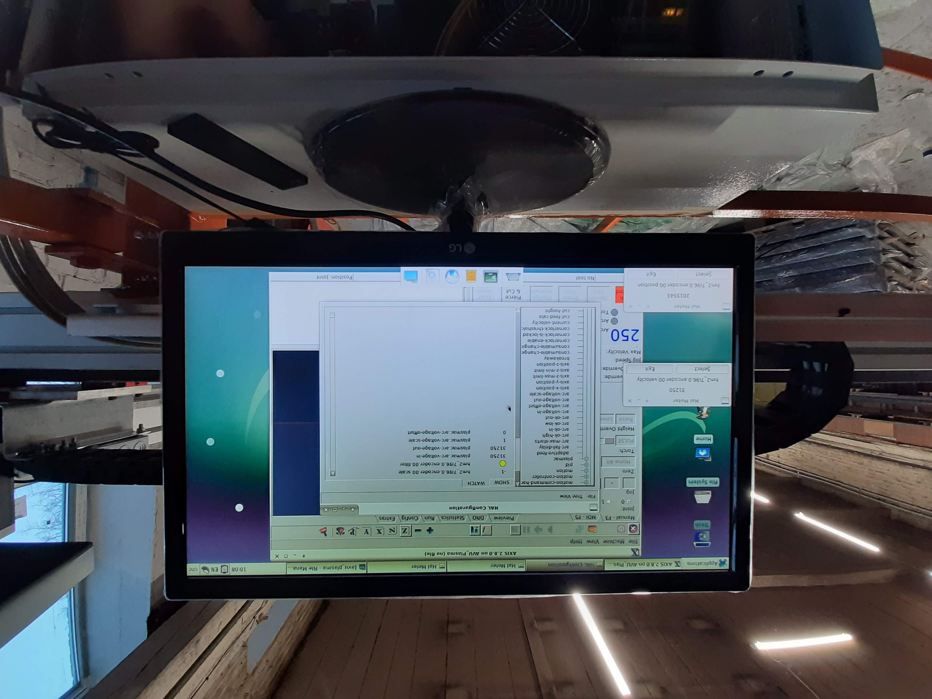

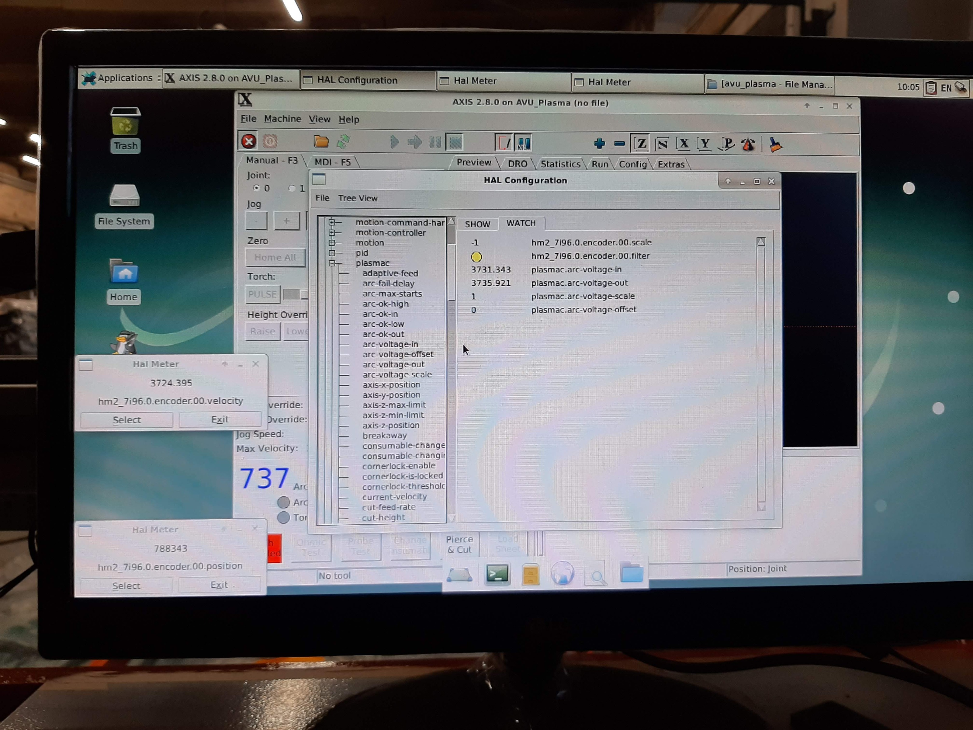

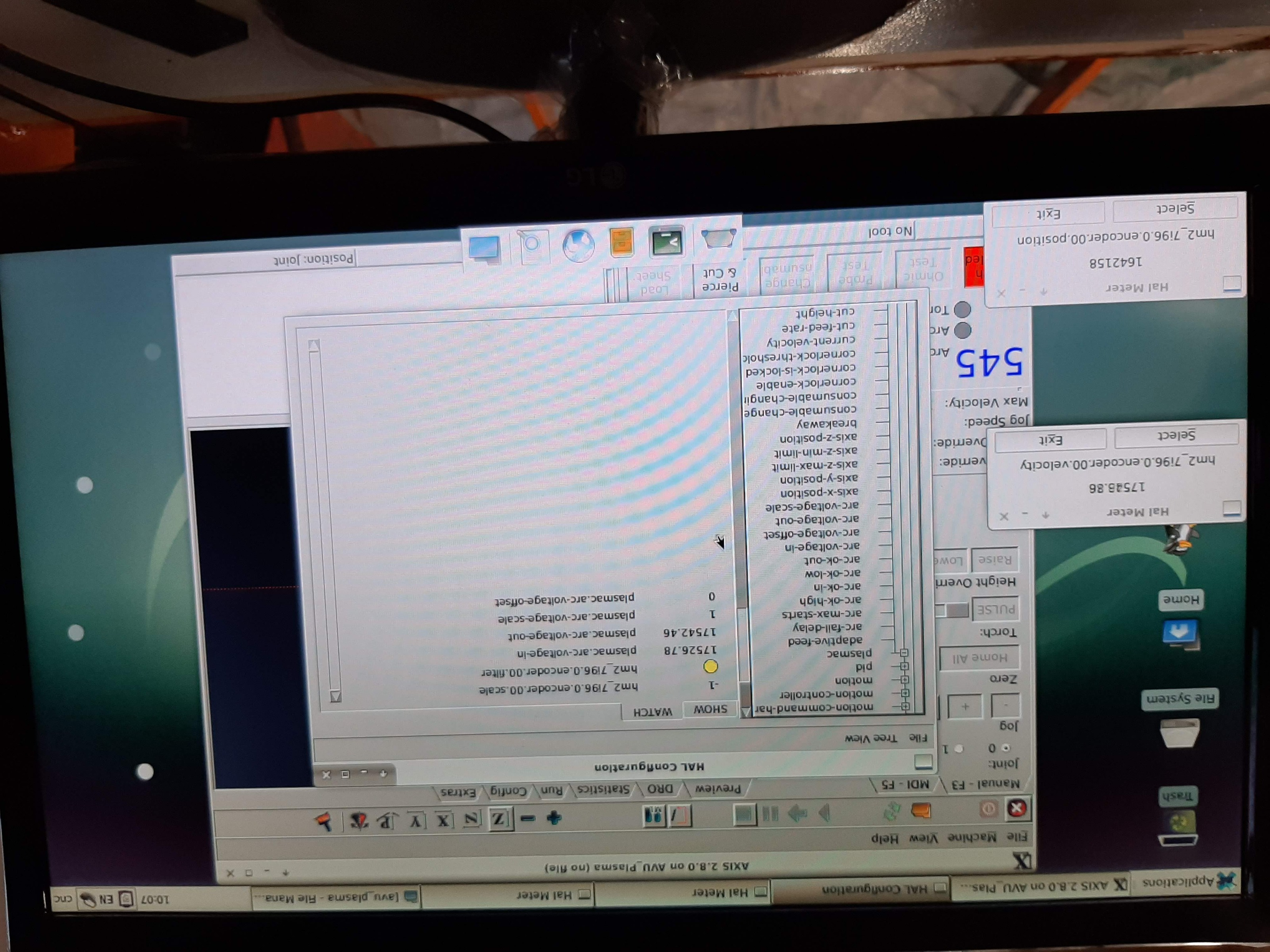

Yesterday I was back there and I have to admit that I have messed up somewhat big time about the THCAD board. When I wrote that I specifically checked for the board to be compatibe with HF plasma source, I was right. Because it is 10V version. But it has lots of resistors soldered in, where I expected to be the voltage divider resistors (I will make actual voltage divider, no problem with that). I checked the invoice from the order and I also checked with different voltage on the board input.
First of all, good news is that the board is still working.
Second of all, I would like to ask, if somebody can explain to me, what does the "arc voltage" number on bottom left corner of Axis UI represent.
I have attached 4 pictures that show encoder velocity and plasmac.arc-voltage-out pins as well as some of the parameters and also you can see that "arc voltage" number on Axis GUI.
THCAD is set for 1/32 frequency division and encoder_scale = 1, so:
1) with 0V input I get encoder velocity = 3730, which matches 120,5/32 = 3,76 kHz
2) with 5V input I get encoder velocity = 17548, which matches ((961,5 - 120,5)/2 + 120,5)/32 = (841/2 + 120,5)/32 = 541/32 = 16,9 kHz
3) with 12V and more on input I get encoder velocity = 31250, which matches 961,5/32 = 30,04 kHz
But plasmac component reports different values on plasmac.arc-voltage-out pin and in Axis GUI.
Plasmac.arc-voltage-out matches the encoder velocity value, but I do not understand, what is that number on the screen. Can somebody, please, explain?
At 0V GUI shows 737, at 5V it shows 545 and at 12V it shows 250. What is that about?

05 Dec 2020 17:13 - 05 Dec 2020 17:15 #191139 by snowgoer540
Replied by snowgoer540 on topic Cannot get arc-ok in Mode 0
You can change any THCAD to any other THCAD by changing the resistors. On a THCAD-10, all of those resistors are 10K 1% (or better) resistors. If you change them all to 300K 1% (or better) resistors, it will be a THCAD-300
This is to be expected... THCAD-5 and -10 can withstand an overvoltage of 500v indefinitely. THCAD-300 can withstand a 2500V overload, indefinitely. Per the manual (page 4).

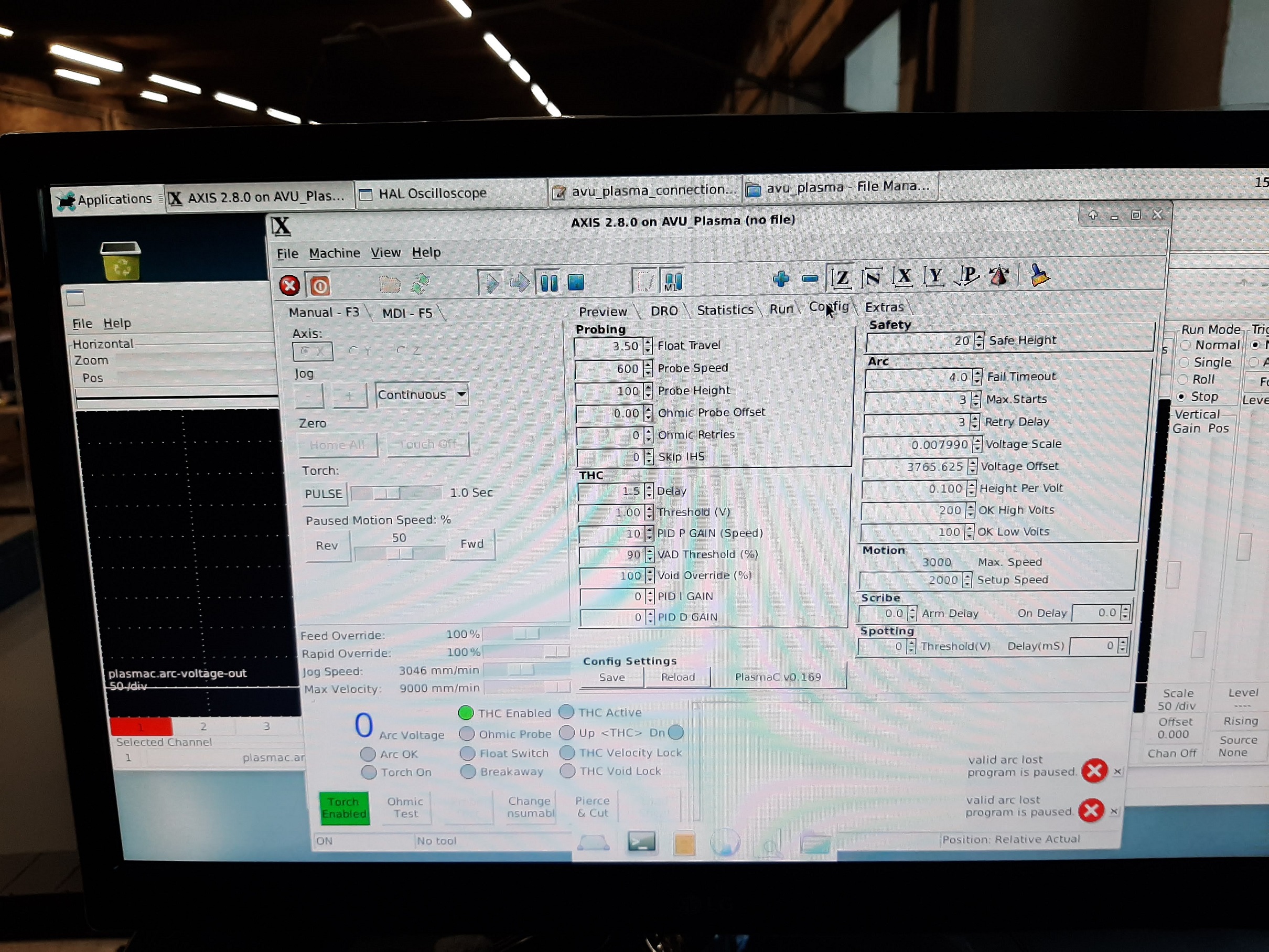

It represents the arc voltage. Your numbers are out of whack because you have not properly set the scale and offset as Phill described earlier.
Again, your scale and offset are not correctly set on the config tab.
linuxcnc.org/docs/devel/html/plasma/plas...uide.html#mesa-thcad
See 9.6.4 and use this calculator: jscalc.io/calc/NTr5QDX6WgMThBVb
You need to know ("we" need to know if you want a sanity check):
  1. 0 V frequency from sticker on THCAD
  2. max V frequency from sticker on THCAD
  3. Frequency divider jumper setting
  4. THCAD model
  5. Plasma Machine Voltage Divider Ratio
You then input the Voltage Scale and voltage offset on the config tab (linuxcnc.org/docs/devel/html/plasma/plas...de.html#config-panel)
Last edit: 05 Dec 2020 17:15 by snowgoer540.
05 Dec 2020 22:44 #191178 by rodw
Replied by rodw on topic Cannot get arc-ok in Mode 0
You have a THCAD-10 by the sound of it. It can only see 0-10 volts. You need to go back to the Mesa THCAD manual and add some scaling resistors in accordance to the provided formulas.
Its all in the plasmac manual as well
linuxcnc.org/docs/2.8/html/plasma/plasma...ng_the_divider_ratio
The following section (9.64) also explains how to set the offset and the scale in the plasmac GUI to correctly report the scaled arc voltage.
The THCAD is a voltage to frequency converter. Using an encoder input is a convenient way to allow that frequency to be read by Linuxcnc. The next part of the puzzle is to use the thcad calibration data to scale that back to a voltage. 3760 is your 0 volt offset, so you need to calculate the scaling value as described above.

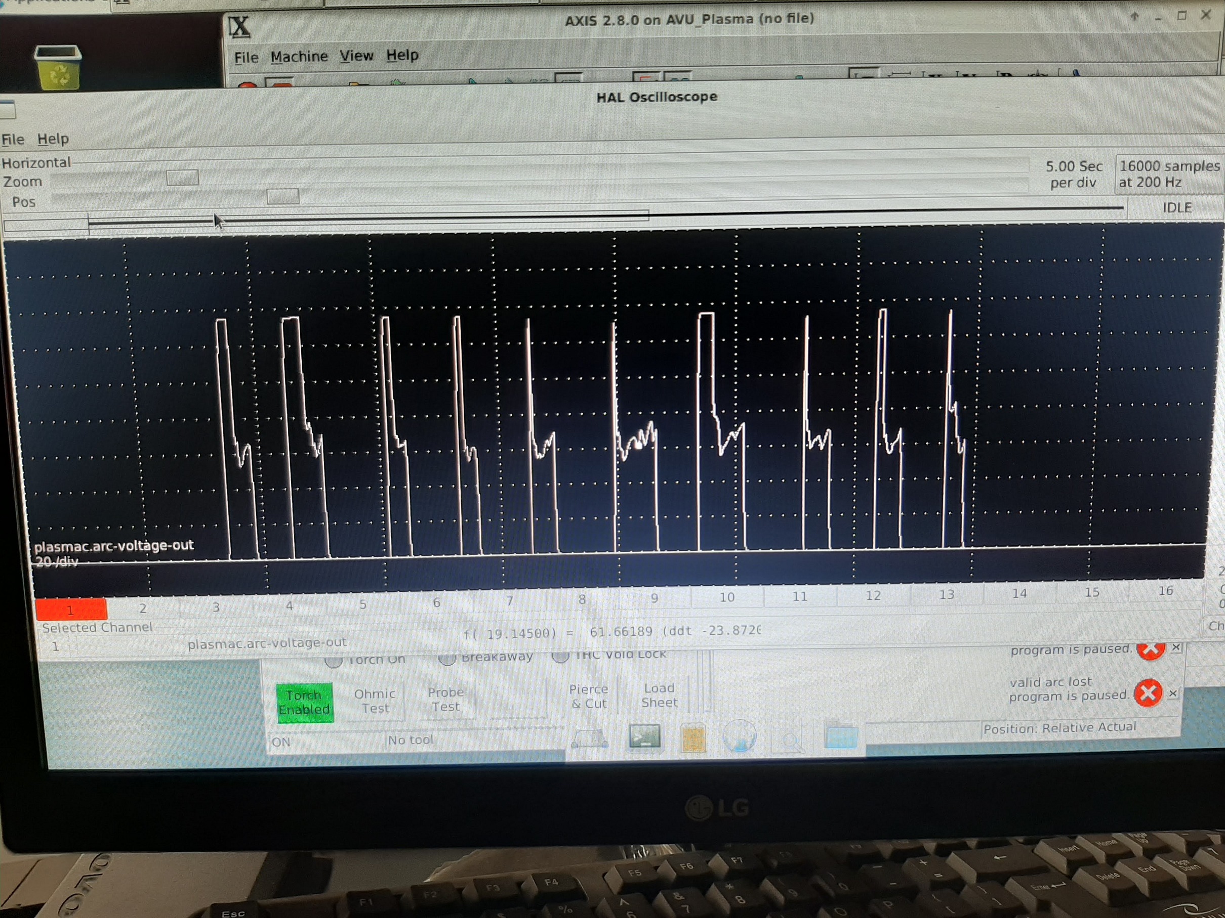

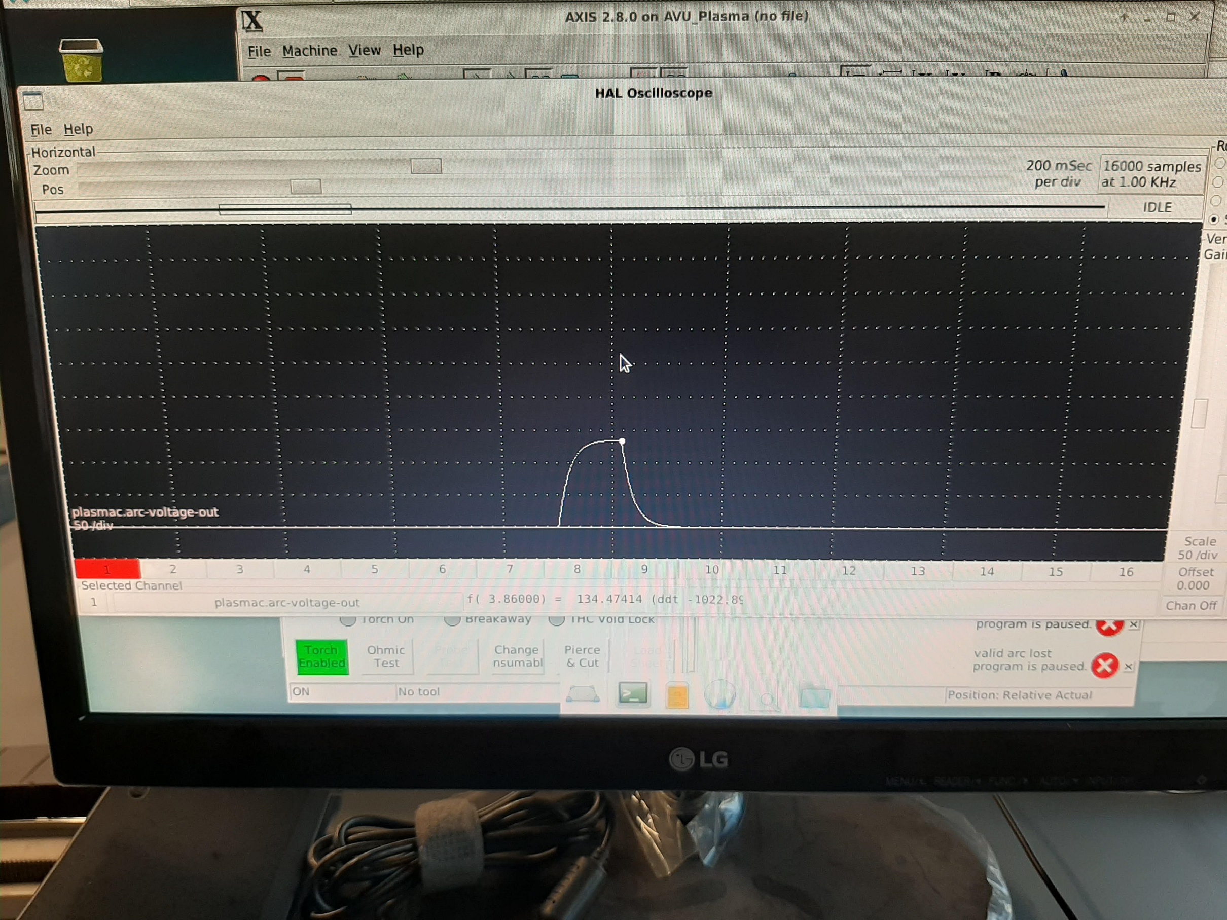

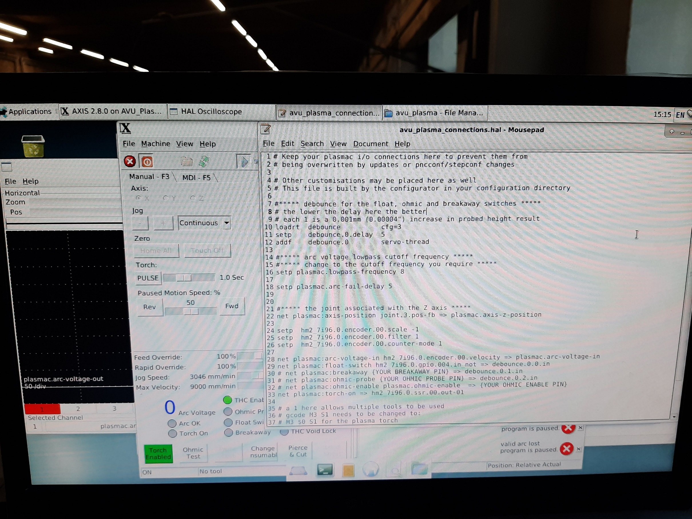

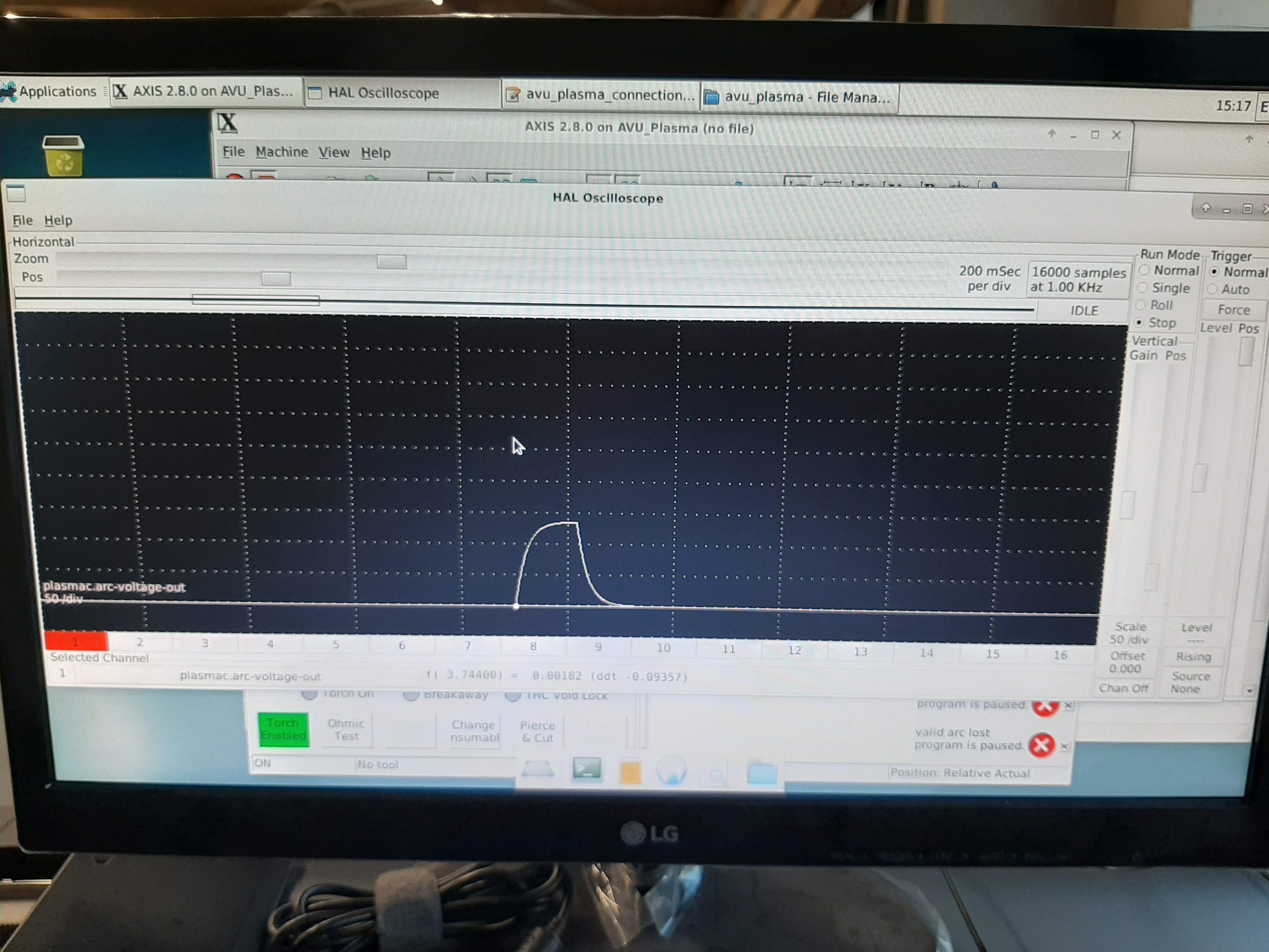

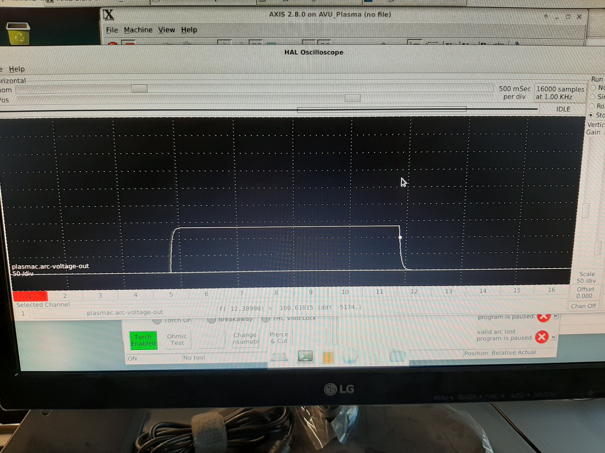

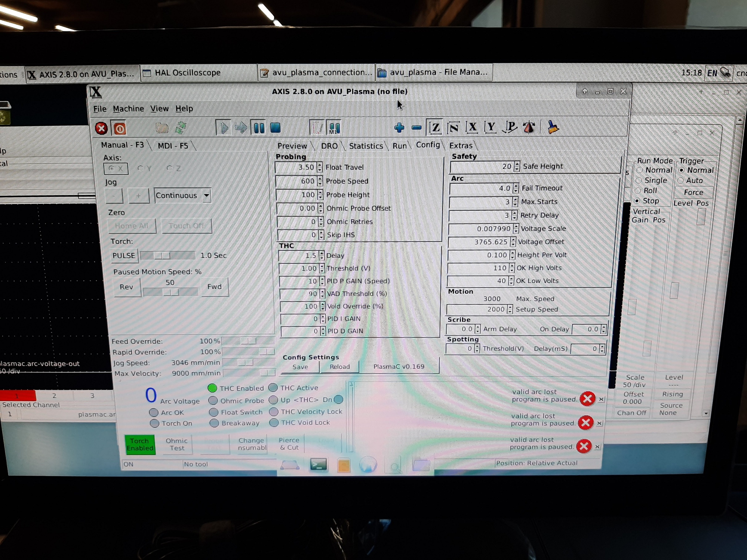

07 Dec 2020 18:42 - 07 Dec 2020 19:04 #191337 by viesturs.lacis
Replied by viesturs.lacis on topic Cannot get arc-ok in Mode 0
Thank you for your patience for bearing with me about the incorrect arc voltage readings. Today I made voltage divider and tested and the reading seemed more or less correct.
The thing is that I am back at the situation described in the topic - I cannot get "arc ok" signal.
First thing I did after setting up voltage divider and plasmac voltage scale and voltage offset, was manually firing the torch and plotting the arc voltage readings in HalScope (picture "plasma-voltage-manually" in attachement). That way I obtained arc voltage for pilot arc and approximate arc voltage for established arc. It was 135V for pilot arc and 55-65V for established arc.
I also have:
1) in HAL file: setp plasmac.arc-fail-delay 5
2) in Config tab: Fail timeout = 4
At first I tried setting "OK high volts" and "OK low volts" range so that pilot arc is not included, but established arc is included in the range. Then I get "arc lost" error 0,1 seconds after starting pilot arc (pictures of test1 in attachment). That does not make sense to me!
Then just for testing purposes I changed "OK high volts" and "OK low volts" range to include also pilot arc. Then I get "arc lost" error precisely after 2 seconds. That also does not make sense to me. It is obvious that arc was not established at all in this case, but IIRC there is another error message for that. Why did I get "arc lost"? And why after 2 seconds, if I set it to try for at least twice as long?
If the pilot arc gets established, I get "arc lost" immediately also when "OK high volts" and "OK low volts" range include pilot arc voltage.
I would appreciate any ideas...

07 Dec 2020 20:05 #191348 by tommylight
Replied by tommylight on topic Cannot get arc-ok in Mode 0
In terminal.
sudo apt-get update
sudo apt-get dist-upgrade
Then use the configurator to UPDATE the existing config.
Test again.
