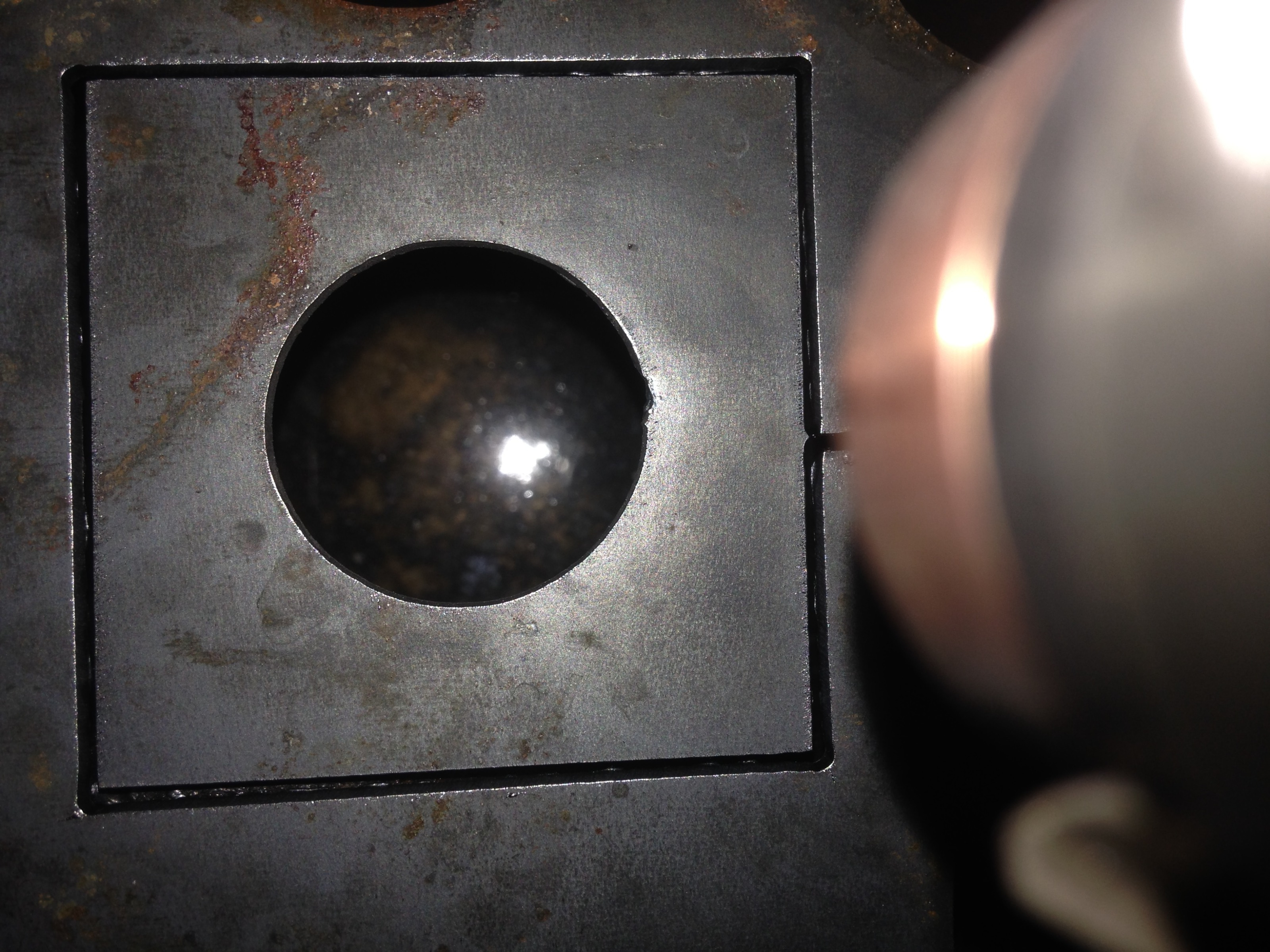

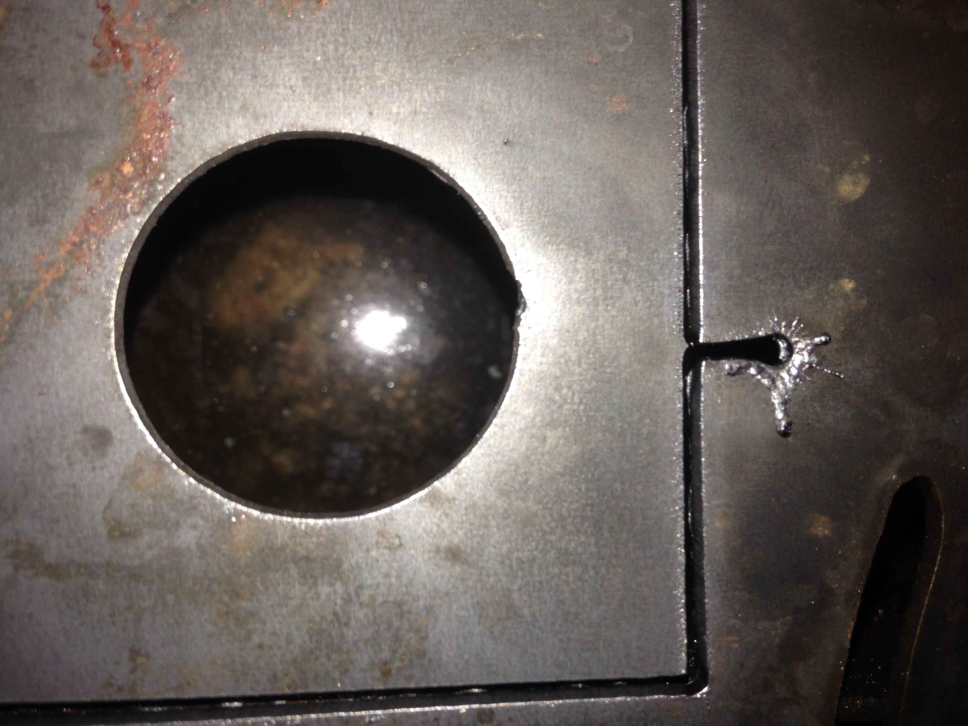

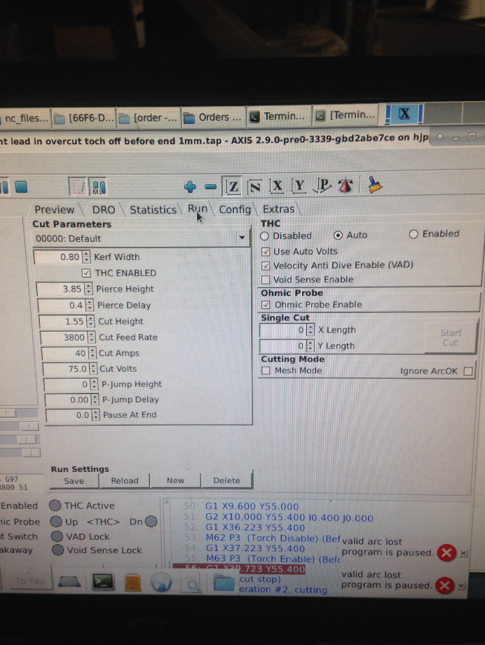

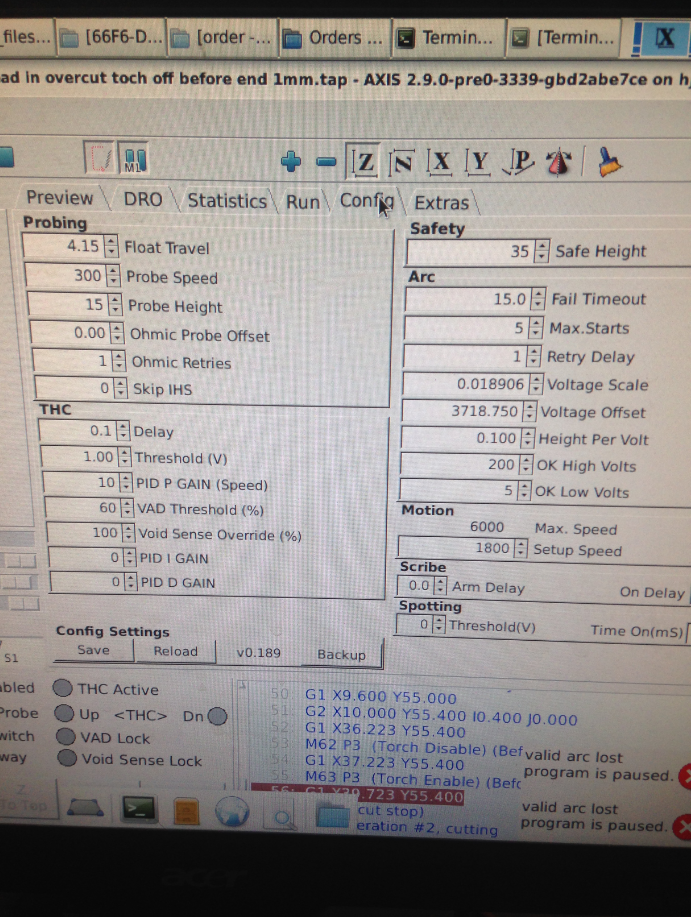

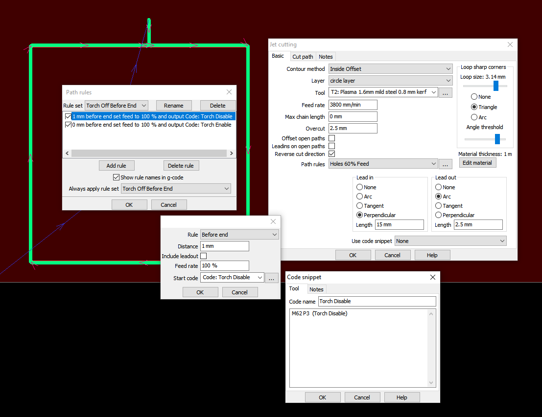

Hi, I installed Plasmac 2019 but haven't got time to use the machine until a couple months ago. I upgraded Plasmac to the latest version and tried to cut some small circle and square. I got some divots and the lead in/leadout place so I tried using the "torch off before end" path rule(M62 P3) to minimize the divots. But I always got the "valid arc lost program is paused" at the end of the cuts. I already added the debounce to Arcok and set the plasmac.arc-lost-delay to 0.3 but still get the error. BUT the funny thing is if I don't use the torch off before end path rule then I DON'T get the error. I can add lead out, overcut and the machine cuts happily(with a big divot though). Did I do something wrong on SheetCam, Plasmac or is there a problem with the code M62 P3 which will turn off the torch in the Hypertherm plasma cutter and plasmac gives the error and pauses? I'd like to attach the gcode and some other pictures for reference. Thanks.

The only thing you can really change regarding the divot is the "pierce delay", set that to 0 on thin materials up to 3 or 4mm.
The divots will not disappear, they are a product of the pierce and the material moving sideways till the arc goes through the material.
Over-burn is a different issue, it is caused at the end of a cut while the arc is being extinguished, also not much can be done, but it is less noticeable, and the "torch off before end path" is for this.
In general, never use a lead out when plasma cutting.

Thanks for the reply but I tried that(arc-lost-delay 0.3) and add the debounce as well as mentioned in the first post but it didn't help. I also tried to change from Mode 1 to Mode 0 but same result. My problem is if I use M62 P3 command, I will get the error message. Is there anything else you want me to try?

I "think" the problem is that you disable the torch, move a short distance then enable the torch again before moving again. It would most probably error when you enable the torch again as the should be no Arc OK signal. For example in the square:
m62p3 (Torch Disable) (Before end)
g1x37.223y55.400
m63p3 (Torch Enable) (Before end)
g1x39.723y55.400Please Log in or Create an account to join the conversation.

28 Jan 2021 03:35 #196889
by shizyo
Replied by shizyo on topic valid arc lost program is paused
You are right! I moved the line "m63 p3" to the end of the file and no more the valid arc lost error message. So that means I need to modify a Gcode file manually every time I run it? Is there any way to do it automatically by adjusting somthing in Sheetcam or the post processor?

by phillc54
Replied by phillc54 on topic valid arc lost program is paused
You would need to edit the rules so that the torch turned back on after the last move.
