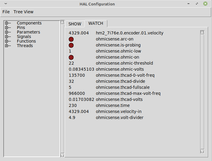

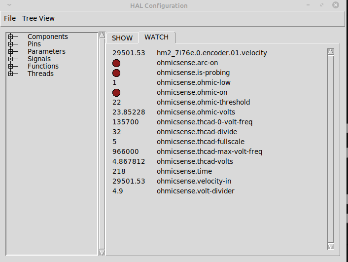

Yes sir. Here are some screen shots from several days ago, after I installed the 390k 1W, showing the voltage reading in hal show. One without touching the plate, the other shows the reading while touching the plate.

Just to be sure, does the torch have an electrode, a nozzle and a shield ?
