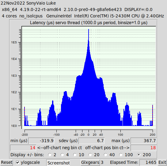

22 Nov 2022 14:16 #257334
by LucasWorx
Replied by LucasWorx on topic Unexpected latency issue
Well, today I tried isolcpus=1,3,5,7. The computer is definitely slower, but the latency is still coming up very high. The BIOS doesn't allow me to adjust very much so I suppose it's time to move things to a desktop:/ Can't say I didn't try though.

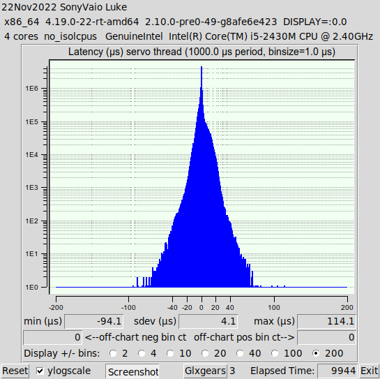

- LucasWorx
- Posts: 28
- Thank you received: 6
22 Nov 2022 21:21 #257380
by LucasWorx
I changed the GRUB file back to the original and tried one more time with the histogram. The first result shown is when I had several internet windows open, sheetcam, and 3 GLX gears. The second result shows the spike from the second I opened YouTube and clicked play on a video, Although, I'm not going to be opening YouTube while I'm doing CNC work so I don't know how practical that really is. Do you guys think the first results would skimp by providing I only used this for QTPlasmaC or is it still not looking to great?
