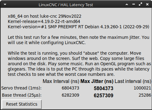

Update: I bought a used desktop PC (as suggested) along with a monitor, keyboard, etc. The PC is a Lenovo M93P Tiny desktop model with an i5 2.9ghz CPU, 8GB RAM, and a 256GB HDD. Surely I thought this would suffice. I always read about an older desktop being good enough to use for CNC and run the RT kernal. I went through the install process of LinuxCNC. HORRIBLE latency test results. Can you guys help me out? Now I'm just throwing money away. I have 2 GLX Gears open with a few internet windows and I can barely type this response. I have already gone into the BIOS and disabled any power saving or unnecessary features. This is the slowest system I have seen in awhile. Please help.

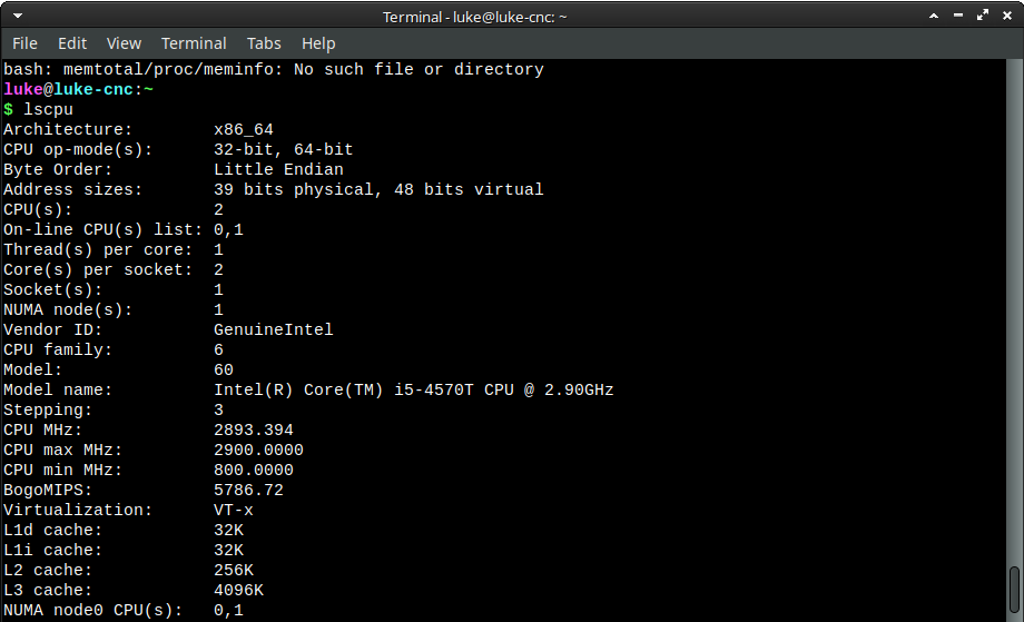

Yes sir. The first thing I did was go through the BIOS and disable a bunch of stuff. Hyperthreading is disabled and C states is set at C1 (as low as I could go). Looks like a 4570T so you were pretty close. I notice it only says 2 cores though:/ I thought it should've read 4. I did not yet disable the multiprocessor support. I thought that would make it even worse. How does disabling the processing power/support help the PC rather than make it even slower? I'll give that a shot right now. Is it better to allocate more or less RAM to the video card? I have that option as well, from 32MB to 1024MB.

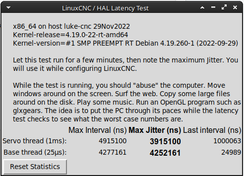

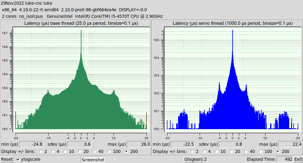

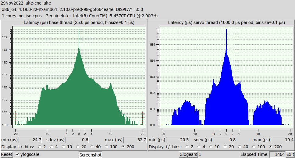

I've disabled about every option in the BIOS and reduced the video card allocated RAM. I ran the histogram for a bit with some stuff open and then I ran the latency test as well. I'm still showing 7 figures on the latency test with just a few internet windows open and 1 terminal. This is ridiculous.

I als notice a big disconnect between the 2 latency test methods. the histogram is much better.
Could you try
latency-histogram --nobase --sbins 1000
and share the screen dump?
I would reseat all memory chips and and cards in the machine. but thats an outside chance.
Could you try

There is something very odd going on here, your latency test results are worse than I see running LinuxCNC on a VM on my Mac!
You could try the RTAI kernel instead.
