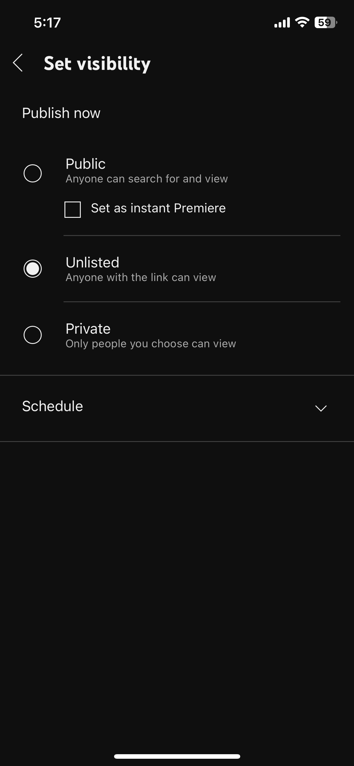

Both of these links say access is denied.
I am not sure how you made the videos (cell phone or screen recorder), but either way I would suggest using youtube to host them. You can easily upload them to your account from your phone, and you can set the visibility to "unlisted" so that anyone you give the link to can see it. Then post that link here. That's how I share them and it doesnt require anyone to download large unprocessed video files (some people here have expressed that they have small Gb limits form their internet service providers).
For screen recording, I use "simple screen recorder", and upload the result to youtube.

Here's the YT links Snowgoer.

Sorted out the YT video links too. Things are a bit different now from when I last uploaded a video. I had to go through a few question boxes (one of which is asking if the video is made for kids or not) before YT would publish the video. On the last question box was the setting for Private, Public, etc.
