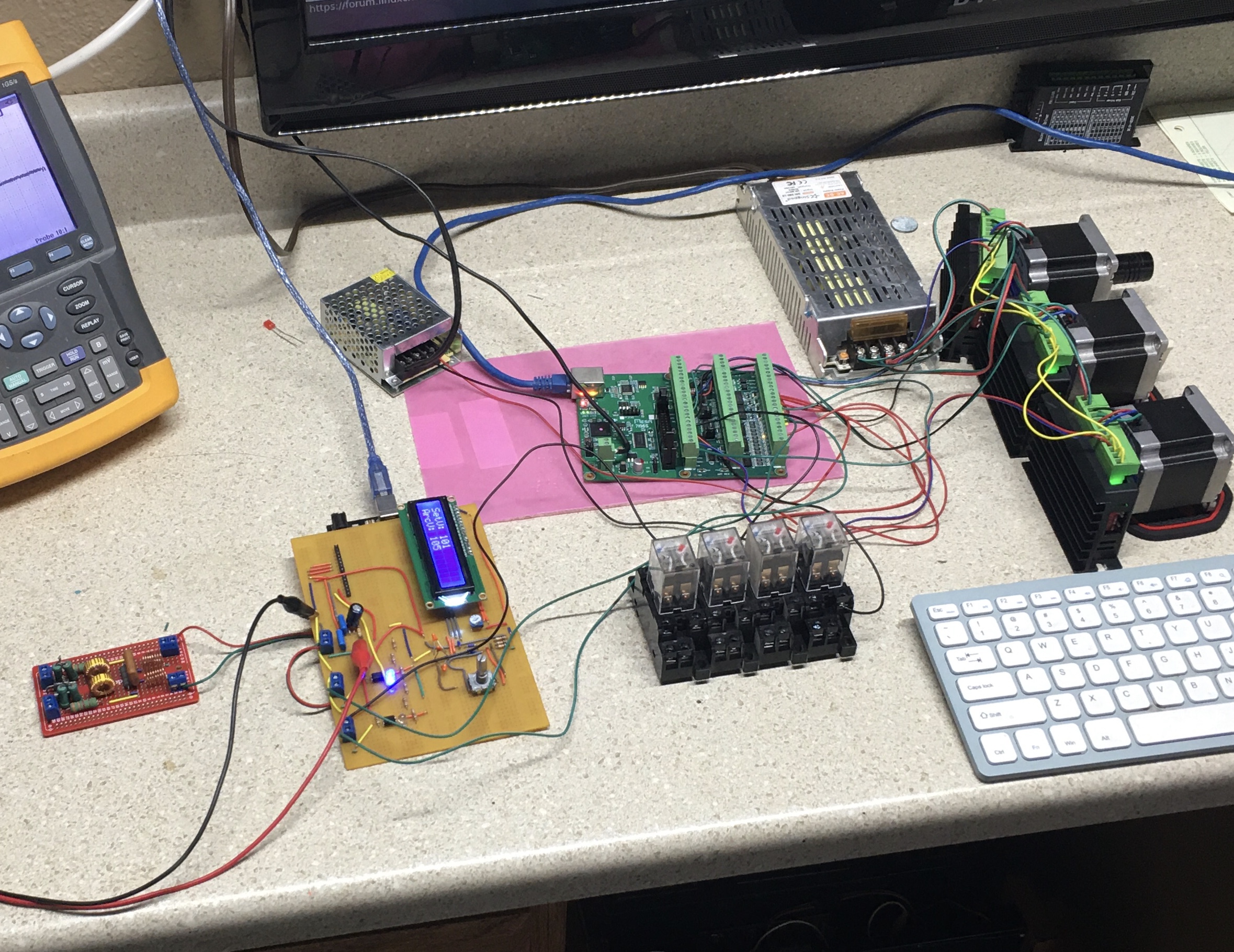

I am setting up a new machine using 7i96s, and the problem i am having is the torch will not fire when running gcode. torch does fire with torch pules button. ant help would be appreciated
Thank you
Thank you

Could you post your gcode?
It may also help if you preemptively posted a backup of your config made from the settings tab.

Thanks for the quick reply
I'm new to this and I don't know how to get the "config" under settings tab.
The gcode that I'm using is the Wench example that come with linuxcnc.

sorry cant find the config file
Generated by PNCconf at Tue Jan 2 16:39:10 2024
# Using LinuxCNC version: Master (2.9)
# overwritten when you run PNCconf again
loadrt [KINS]KINEMATICS
loadrt [EMCMOT]EMCMOT servo_period_nsec=[EMCMOT]SERVO_PERIOD num_joints=[KINS]JOINTS num_spindles=[TRAJ]SPINDLES
loadrt hostmot2
loadrt hm2_eth board_ip="192.168.1.121" config="num_encoders=1 num_pwmgens=1 num_stepgens=5 sserial_port_0=00000000"
setp [HMOT](CARD0).pwmgen.pwm_frequency 20000

03 Jan 2024 00:55 - 03 Jan 2024 00:59 #289629
by David Herrera
Replied by David Herrera on topic QtPlasmac setup
yes I have the torch on enabled, and when i select the torch pulse button it works.
The problem is when i run a cycle the torch wont come on, arc ok signal and thc signal not recognized.
