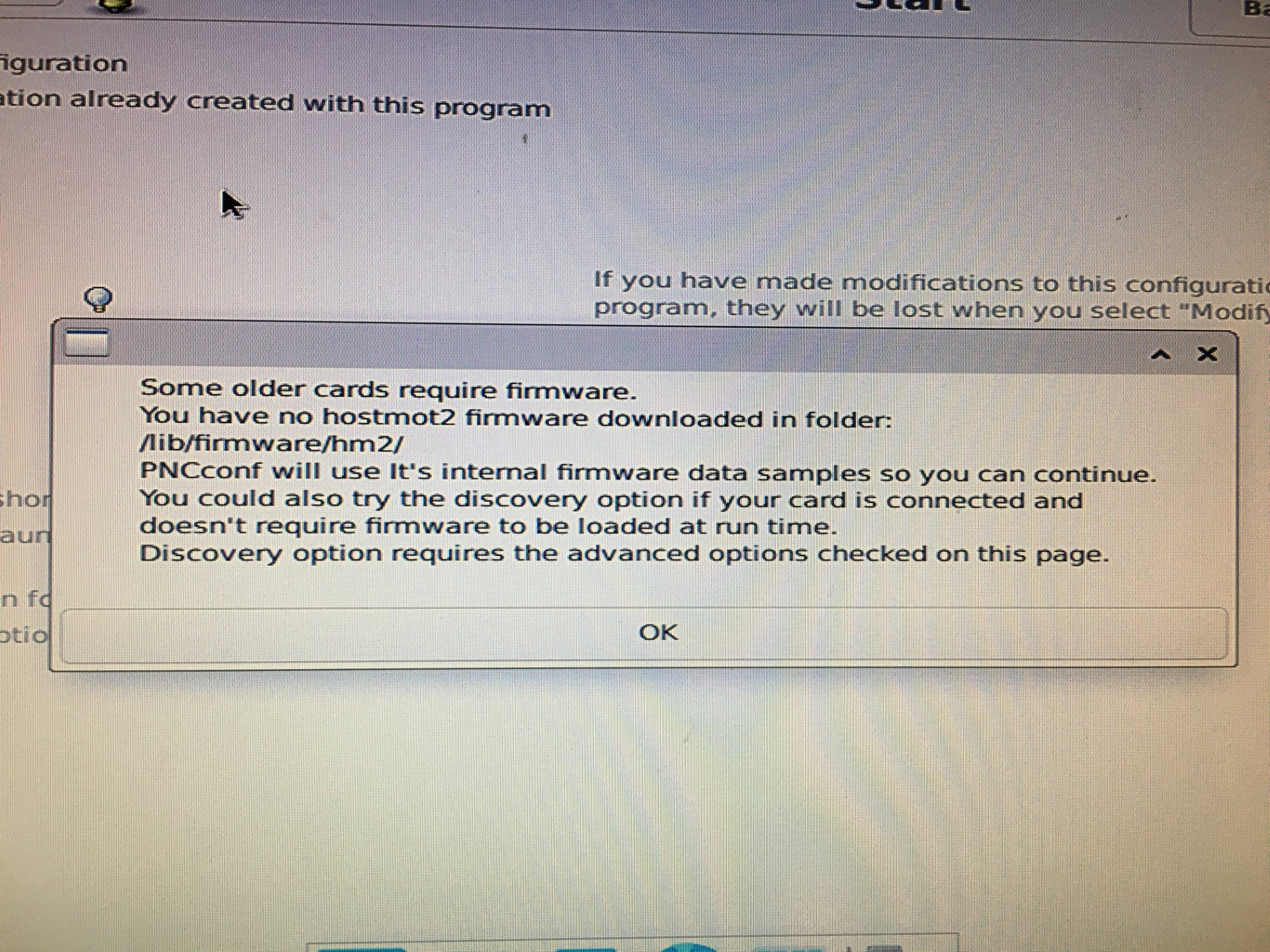

First of all, thank you for all the work you do on this forum.
I have not been able to update to the latest version and I have had to install another one, but when I try to do Pnconfig I get this error that I put in the image.
I have done Mesaflash and I have installed the firmware finished in Dpl.bit but when I do Pnconfig it does not show me the encoders it only tells me that the A is there.
Last edit: 22 Oct 2024 20:48 by chuben.

22 Oct 2024 22:39 #312908
by phillc54
Replied by phillc54 on topic Update failure
That is not an error, it is just a warning about older style cards and you can ignore it.
After you select the Boardname and the appropriate Firmware on the Mesa Card 0 page you need to click "Accept Component Changes" which will load all the details for that particular card.

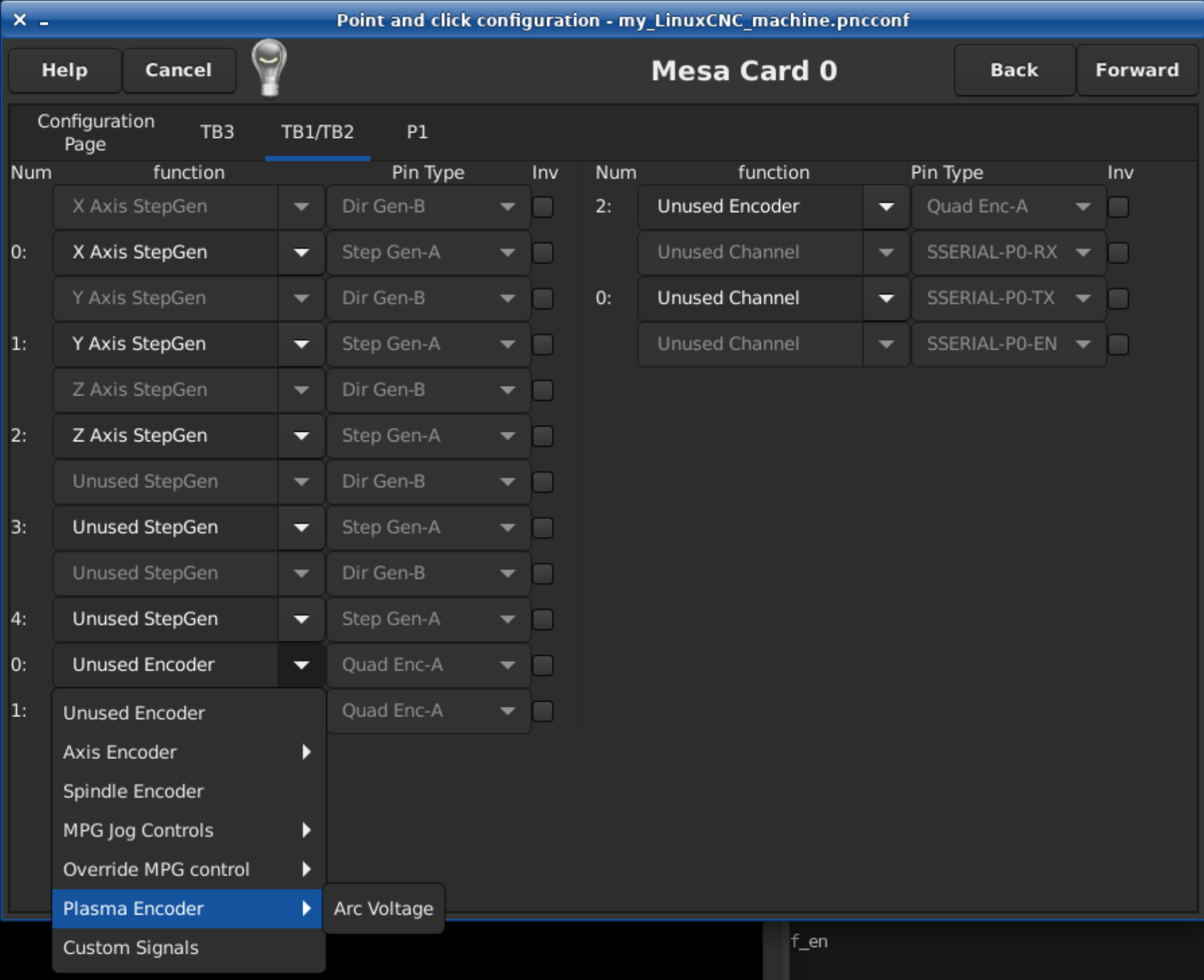

23 Oct 2024 07:07 #312926
by chuben
Replied by chuben on topic Update failure
What you tell me is what I do but when I get to the encoders, only encoder A appears. And when I go to the THC configuration page, the option to choose encoder does not appear.
- phillc54
- Posts: 5711
- Thank you received: 2100
23 Oct 2024 10:16 #312937
by phillc54
There should be three of encoder A, numbered 0, 1, and 2. Click the arrow next to the encoder you want for arc voltage.
If you are using an encoder for ohmic comp you need to do that manually after PnCconf has completed, the default ohmic sensing for QtPlasmaC is done using a solid state relay rather than a THCAD.
