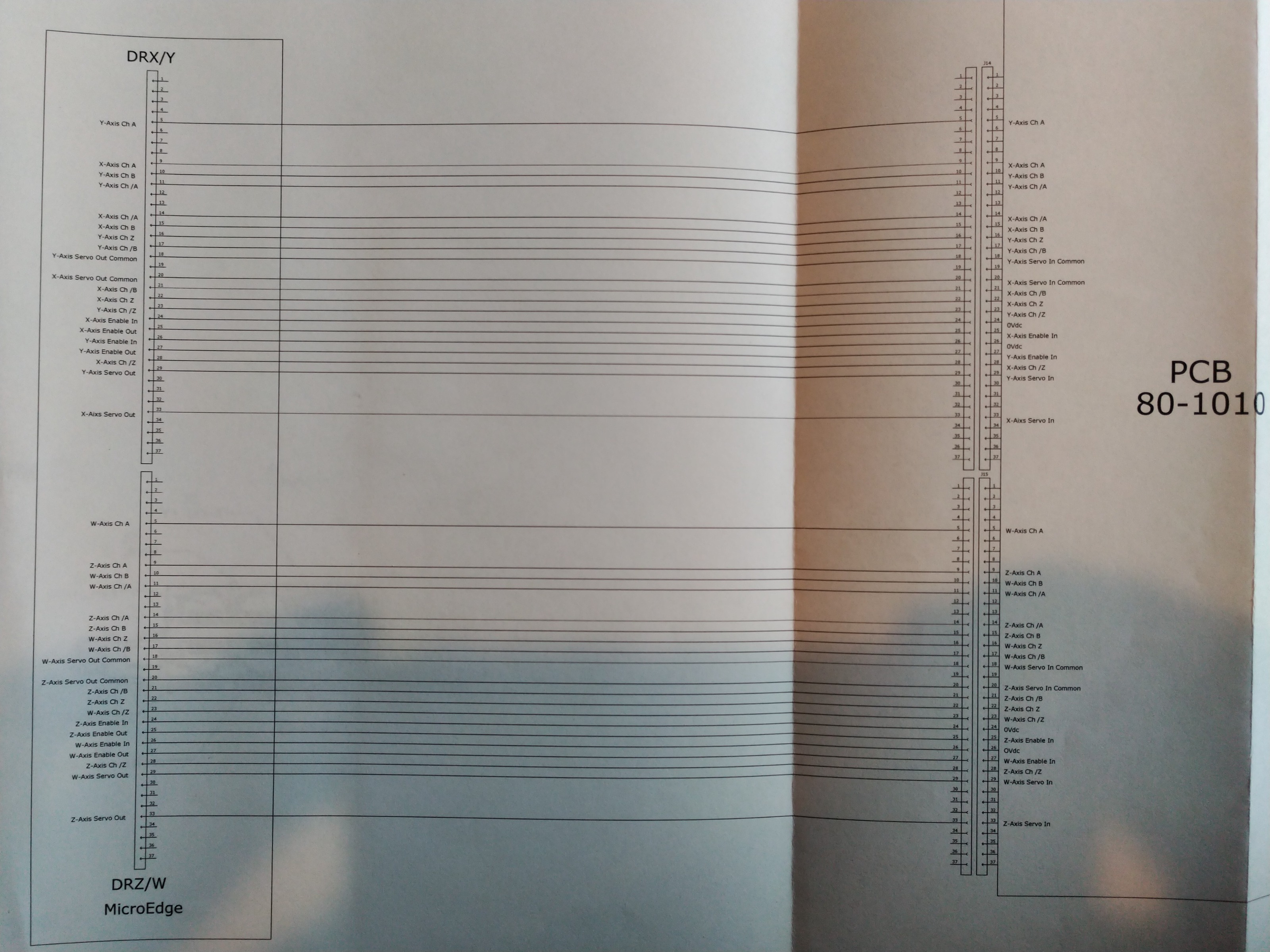

Yes. Here is a schematic that goes from the interface PCB to the hypertherm microedge for the drives. I'm only familiar with stepper motors at this point so this is a little overwhelming.
- Posts: 18111
- Thank you received: 5330
29 Jun 2025 22:17 #331017
Replied by PCW on topic Servo Driver Plasma Retrofit
The basic motion I/O looks relatively straight forward
The A,/A B,/B, Z,/Z signals are encoder signals and go directly to the 7I97T
The Servo-Out pins go to the 7I97T analog out pins and the Servo-Out-Common pins
go the the 7I97T GND pins adjacent to the 7I97T analog out pins.
The drive enables are a bit more puzzling as It hard to tell if they are activated by grounding
or supplying a positive voltage

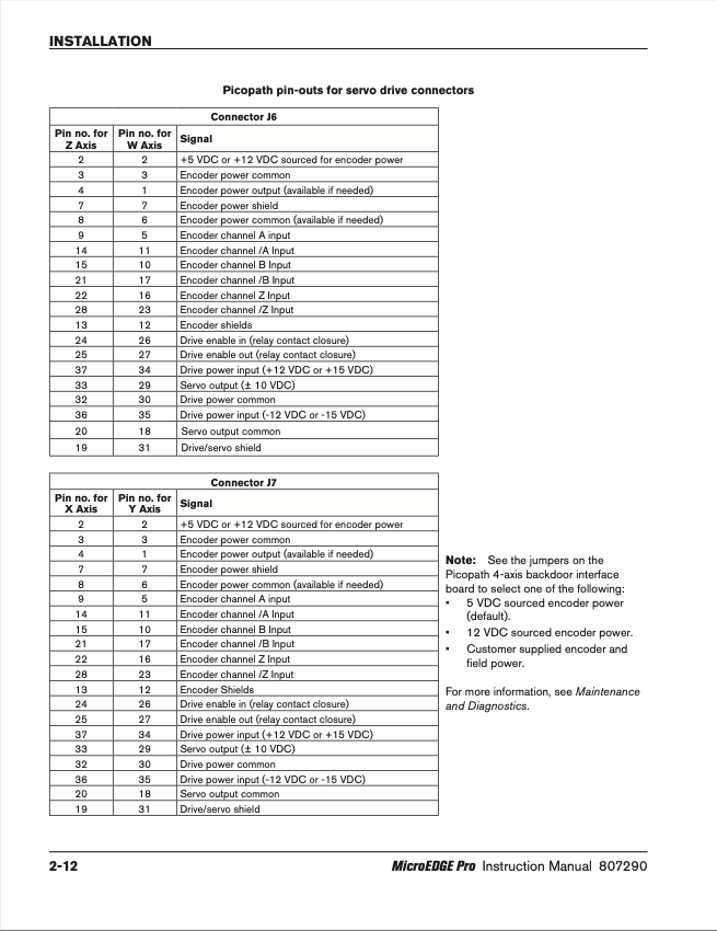

Here is a more detailed wiring pin out for the hypertherm controller. However I haven't found anything about if they are activated by a positive voltage or a ground. This chart says relay contact closure. With that said, would I be able to just enable the drives with an external switch and relay?
Last edit: 02 Jul 2025 02:53 by kn612.
- Posts: 18111
02 Jul 2025 03:02 #331085
It looks like you connect drive-enable-in to drive-enable-out
to enable the drive. This means the 7I97T's enable outputs
may work, but you would need to determine the polarity,
open circuit voltage, and closed circuit current. These can all be
measured with a DVM.

How do the 7i97t drive enable pins work? Do they supply a voltage?
- Posts: 18111
02 Jul 2025 13:57 #331104
No, they are isolated optocoupler outputs rated 100 VDC and 50 mA max.
So the enable outputs may be used in place of relay contacts if the ratings
are not exceeded and polarity is observed.
