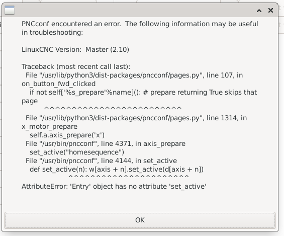

- bentiggin
- Posts: 77
- Thank you received: 7
17 Jul 2025 19:59 #331948
by bentiggin
Replied by bentiggin on topic Servo Driver Plasma Retrofit
I just tried to create a config in pncconf for a 7i97t and I encountered an error.
Attached is a pic of the error.
I am a novice so I may be doing something wrong, I am barely sure I updated to 2.10.

- Thank you received: 16
18 Jul 2025 01:55 #331964
by kworm
Replied by kworm on topic Servo Driver Plasma Retrofit
I don't think that error has anything to do with the support I added. I'm not sure what would cause that.I just tried to create a config in pncconf for a 7i97t and I encountered an error.
