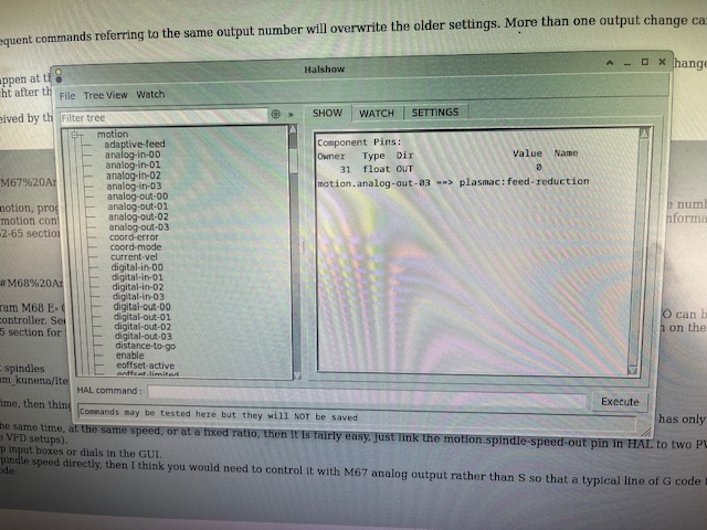

Im not sure they do right nowM62 and friends need connections in HAL to have any effect. Do these connections exist? (motion.digital-out-NN etc)
- Cdub
- Posts: 17
29 May 2025 15:06 #329383
by Cdub
Replied by Cdub on topic M62-M68 codes not working
From what I can tell it looks like it is attached in Hal?

I made some time to look at this tonight. I swear this worked the first time I tried it, but there's almost no way it could have ... so my apologies.
The reason it's not working is because you turn adaptive feed (M52) off:
Take out line N35 and it will work.
N30 M52 P1 (Allow paused motion)
N35 M52 P0 (Disable paused motion)Take out line N35 and it will work.

Wow that was simple lol. Thank you I also added M50 to the preamble to allow adaptive feed. Just to be sure but working great now. Thank you
