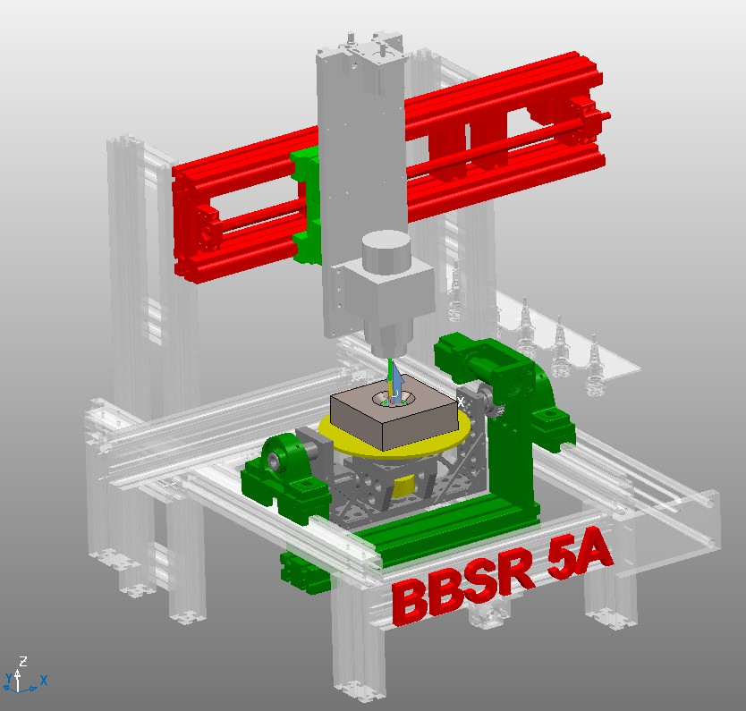

Maknig progress as Corona timeout sets School off time 5 weeks lots of time to get Software setups
here is the image of powermill with the ,ashine flow
also added the DMT full file folder with the MTD file
The instruction sying you do not need a postprocessor but the NC out asks for the OPT Pmoptz File to be created

13 Apr 2020 09:10 #163856 by bbsr_5a
Replied by bbsr_5a on topic Powermill LinuxCNC Post
the postprocessor is universel and takes the Axis position out of the Machine POS
it needs a OPT File to produce the lines you like to see this is all graphics and can be manipulated by clicks
like Fixing the Coolend to NON or no output to BlockNumbers
other than standard cams it is a nonTextfile you only can edit it by autodesk Postprocessor tool
and it will only accept things confirm to Righthand Mashine Kinetic Data CDTAD
so from my perspective somewhat easyser for standard user then of Fusion
even the new Feather Cam is a improve in this behavior
