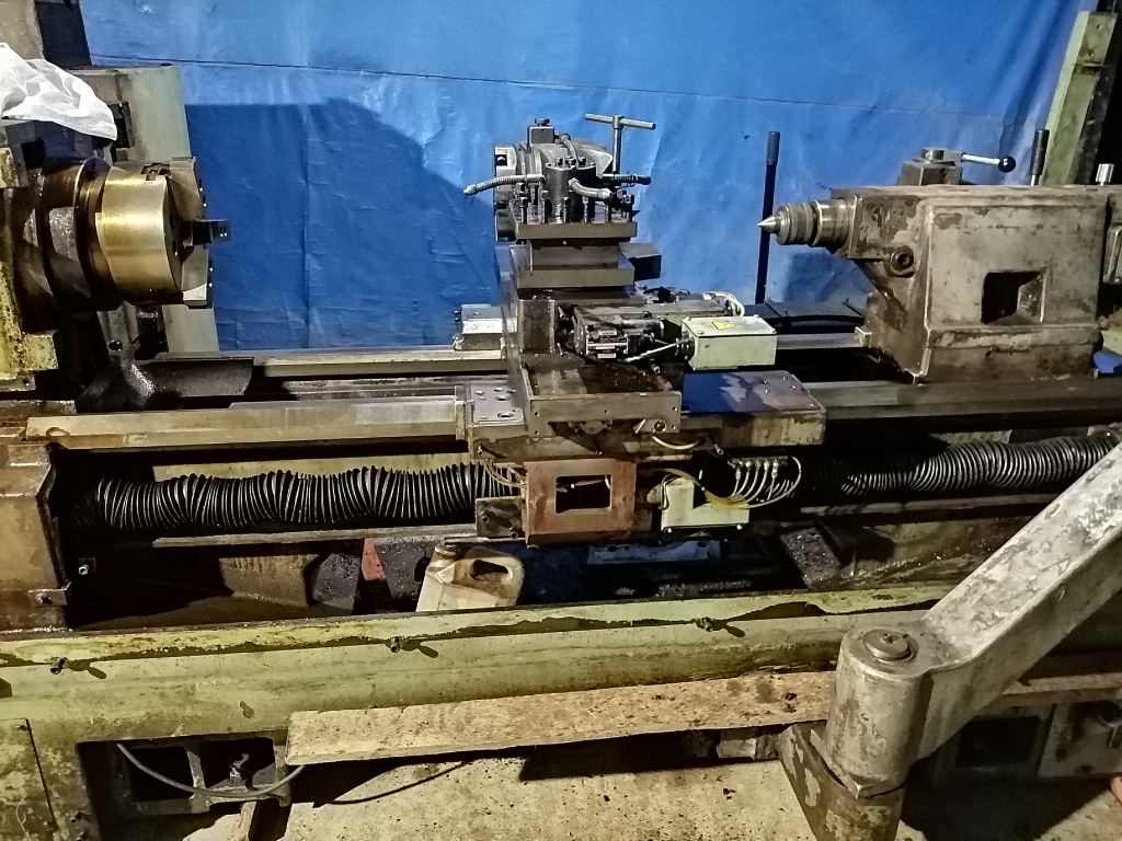

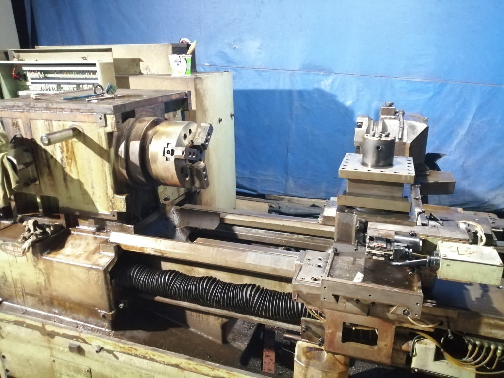

14 Sep 2021 10:22 #220609
by harindugamlath
Replied by harindugamlath on topic Probe Basic Lathe Status
PatrickAwesome work! Saw your video on youtube and I'm now working on my lathe.I will definitely give a hand on Pb development.Super awesome to see probe basic getting more people.this is my old lathe. Taking things apart and cleaning at the moment. Okuma LS-30N dual turret. I guess I'll be making a new tool turret image for this.

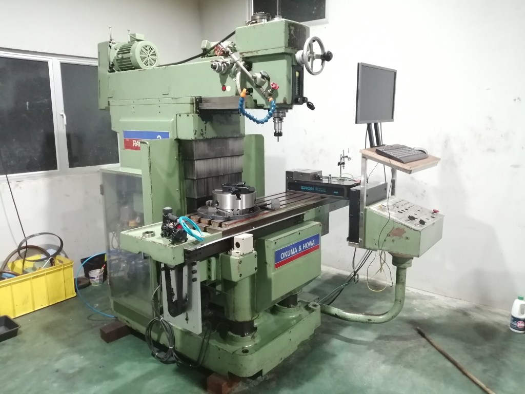

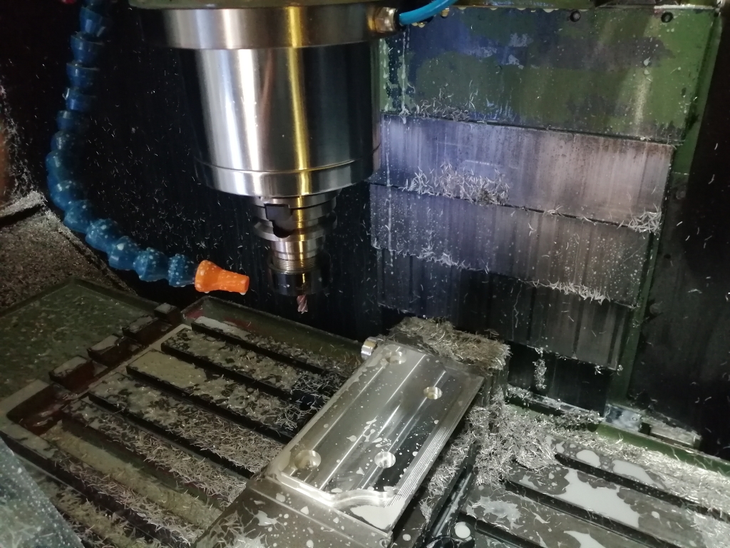

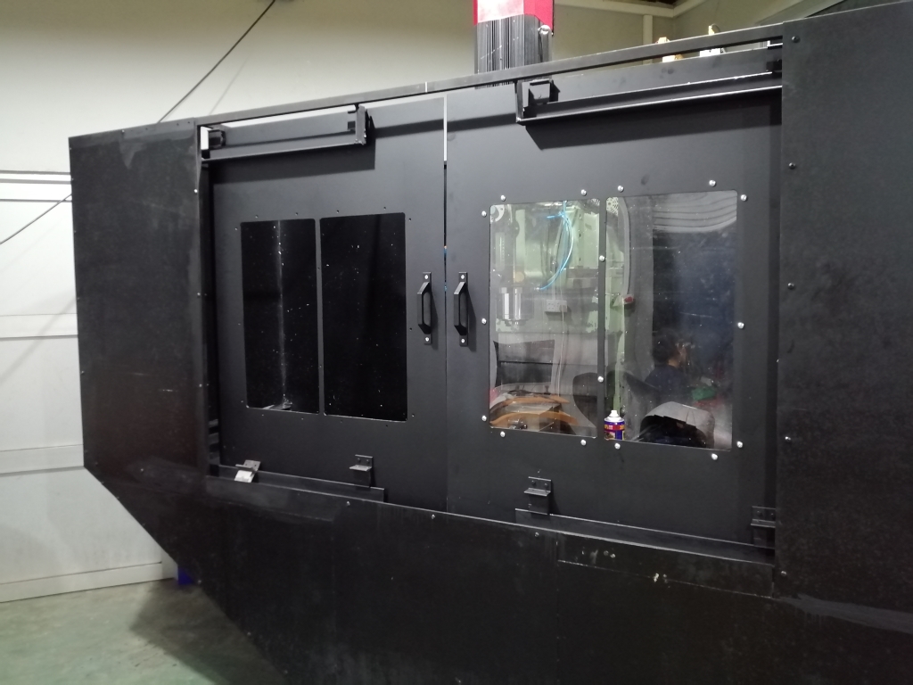

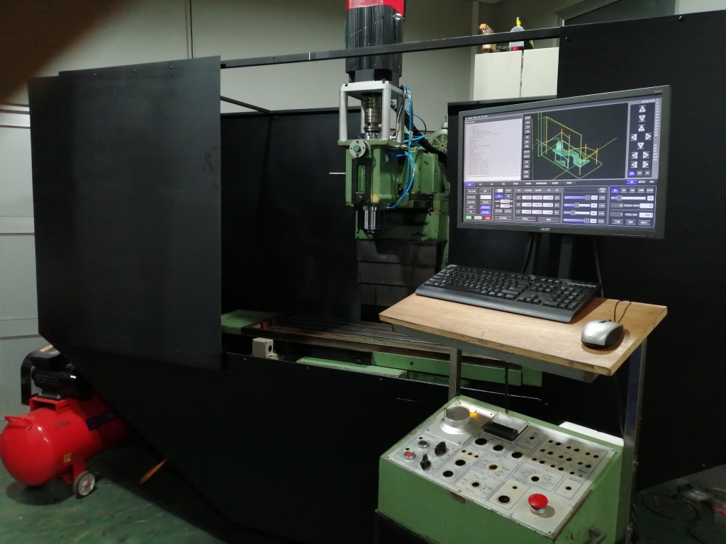

14 Sep 2021 10:45 #220618
by harindugamlath
Thanks everyone for posting. really appreciate it
Here's my Mill running PB. Anotheold Okuma. Like you said it was PB that made me jump on linuxcnc. Let's keep the good work.
Mill Looks totally different now. I've also added axis load meters(not properly connected yet, but functional)
