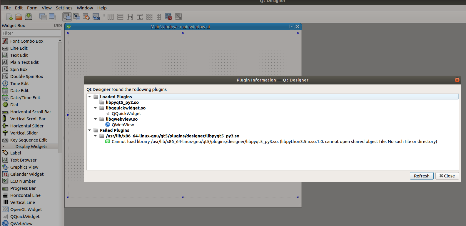

The error suggests either the designer plugin has not been copied across per developer install instructions or a non supported OS is being used.
Or if using a RIP install the LinuxCNC rip-environment script has not been run and/or you are not starting designer from a cli with those paths setup.

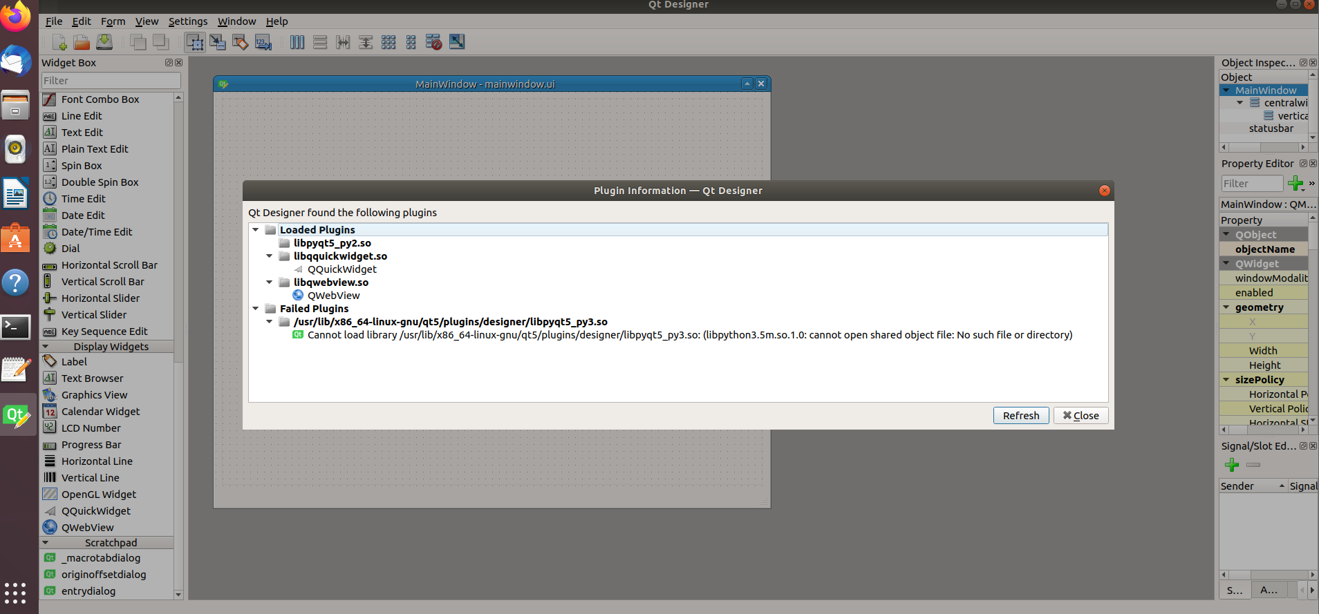

I am using Ubuntu 18.04 system, running the Linux CNC rip environment script and the designer started from the script window started by the terminal. I don't know what my fault is now. I don't have these plug-ins. I hope I can get your help.
Thank you very much

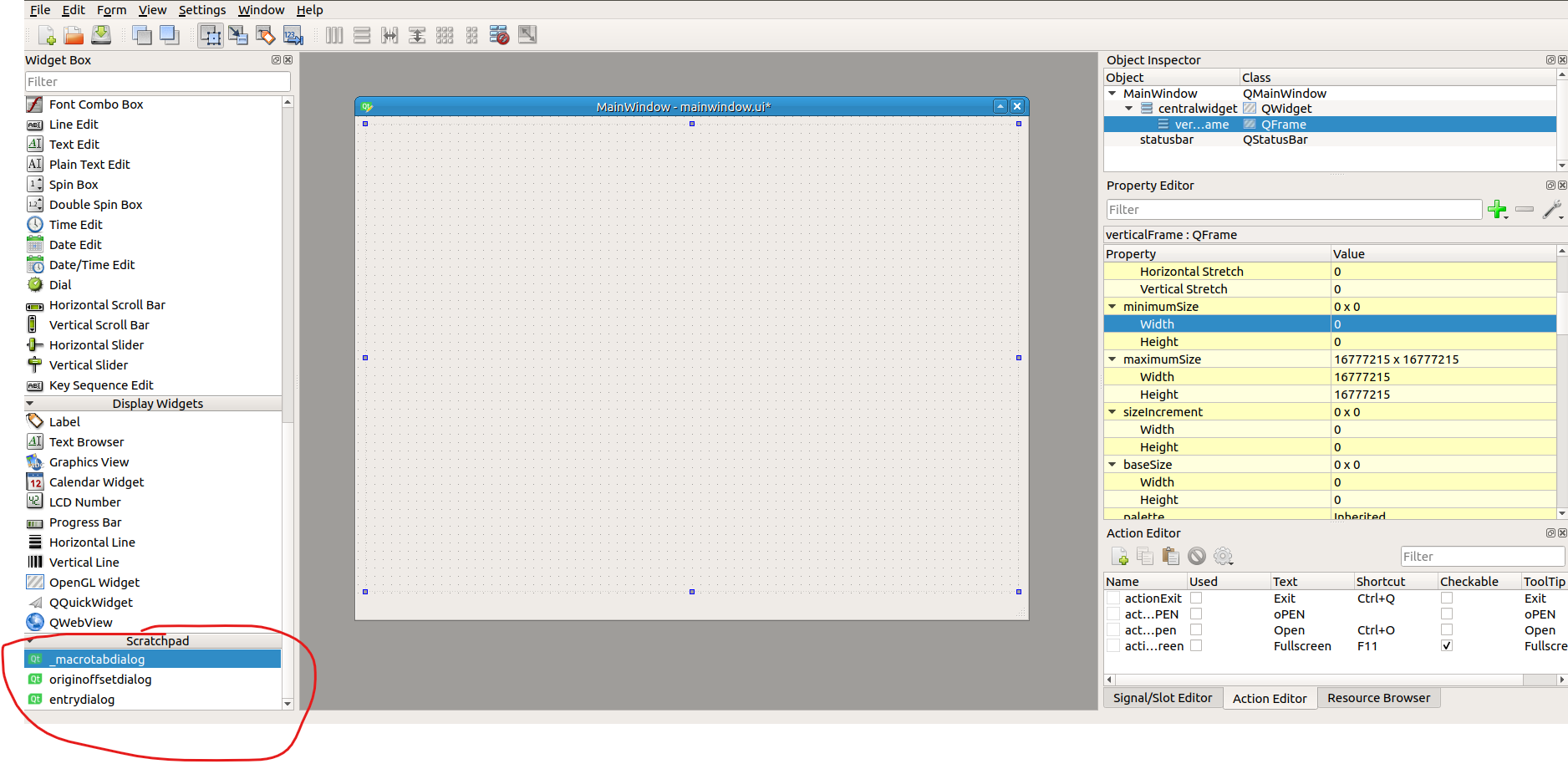

You may not understand my problem. I now open qtpyvcp without a Linux CNC control. Then I think the control of linuxcnc is not loaded. Please see if my picture library is not loaded. How should I load this library?

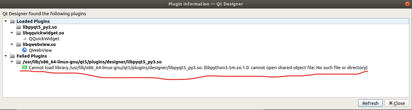

I looked again at the screen shot, that so is for python3.  And the error is complaining about not finding a supporting python3 libraray.  Have you installed the necessary python3 dependencies?
It is wanting libpython3.5
howtoinstall.co/en/libpython3.5

I didn't find the libpython 3.5 library. I tried his installation command, but the installation failed. I don't know why

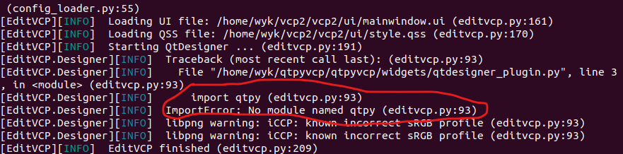

I don't know where I'm wrong,I think it may be related to these two mistakes.The first one I think is that the plug-in is not loaded. The second one is that there is no qtpy function library when starting editvcp. I attached the picture below. I hope you can help me further and make my UI more cool. Thank you here
